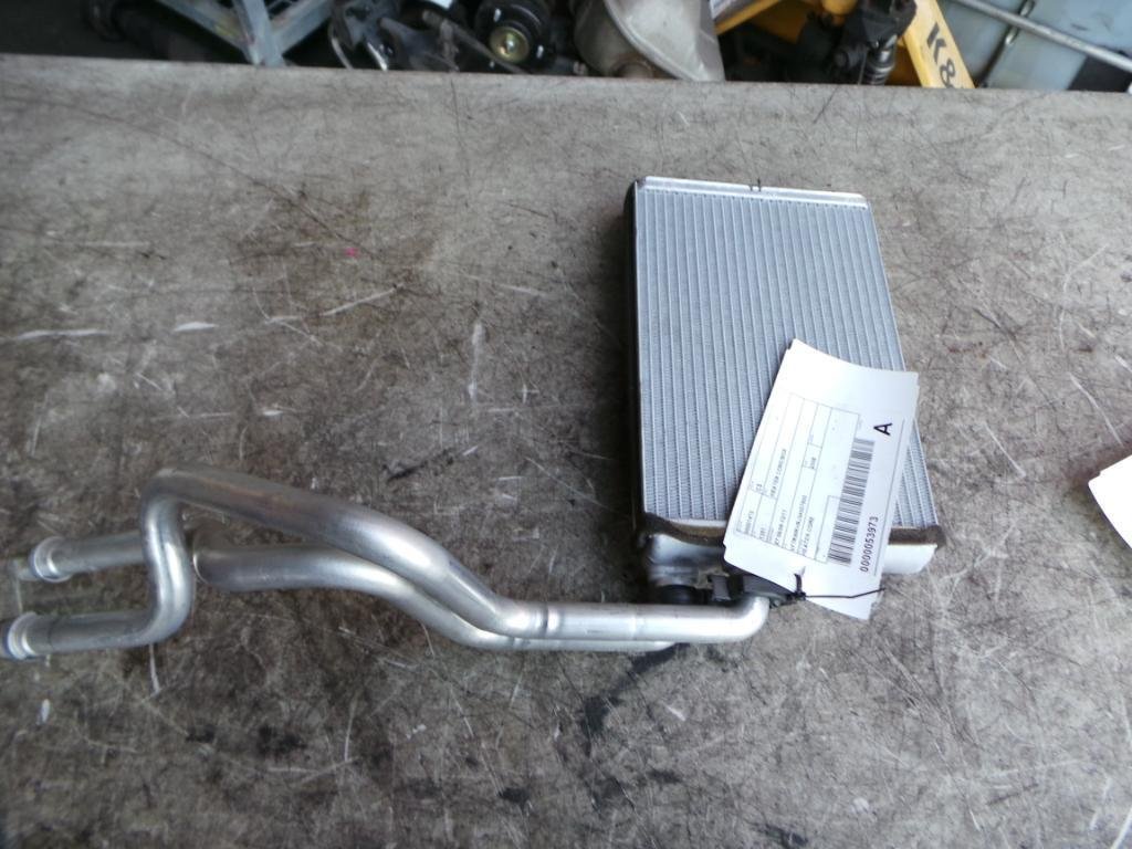

This thing:
I have various repair handbooks and wiring diagrams for C5 mk1, Xantia, XM, Berlingo and C3 mk1.
I have Lexia/Diagbox (Sweden) and Servicebox/sedre
- x 6948
Re: Citroen c5 X7 - cabine heating problem?
But that heater resistance only provides basic heating until the engine warms up for cold mornings or to help with defrosting. If 'ExOduS442xb' is saying that the cabin temperature does not heat up very much even when the engine at operating temperature, then there is another issue.
@ExOduS442xb: I wouldn't spend any money yet until you have had it checked out, otherwise you could be wasting money.
Ross_K
- Posts: 1055
- Joined: 18 Jul 2004, 22:26
- x 110
That's not it surely, in front of the pollen filter, with the pipes going in? That'd be too accessible for a Citroen
citroenguy
- (Donor 2021)
- Posts: 258
- Joined: 21 Sep 2017, 18:05
- x 77
No i think it's after the pollen filter, further back toward the center console.
The 4 wire thing in front is the fan speed regulator "resistor pack"

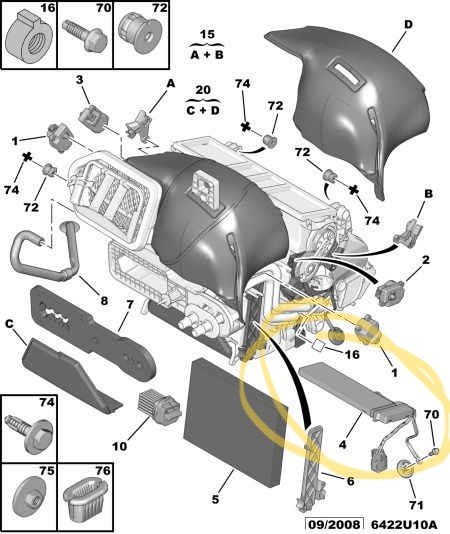

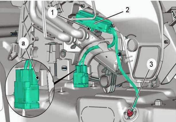

If I understand correctly the silver pipes go into the heater matrix (which is seen in the photo above), and based on this post of Marc's the electric heater pack is above the pipes (item 2 in the picture below, and out of view in the photo above):
And my understanding that the silver item is the heater matrix is based on a random eBay ad...? Correct me if I'm wrong as I'm more used to seeing heater matrixes buried deep inside the dash of CitroensGiveMeABreak wrote: 07 Jun 2021, 00:08
Disconnect the connector (Heater element) .
Unclip the connector (Heater element) at "a".
Remove:Remove the passenger compartment air heating resistor (2).
- The earth bolt (3)
- The (1) bolt
Refit:Refasten the connector (Heater element) as "a".
- The cabin air heating element (2)
- The (1) bolt
Reconnect the connector (Heater element).
