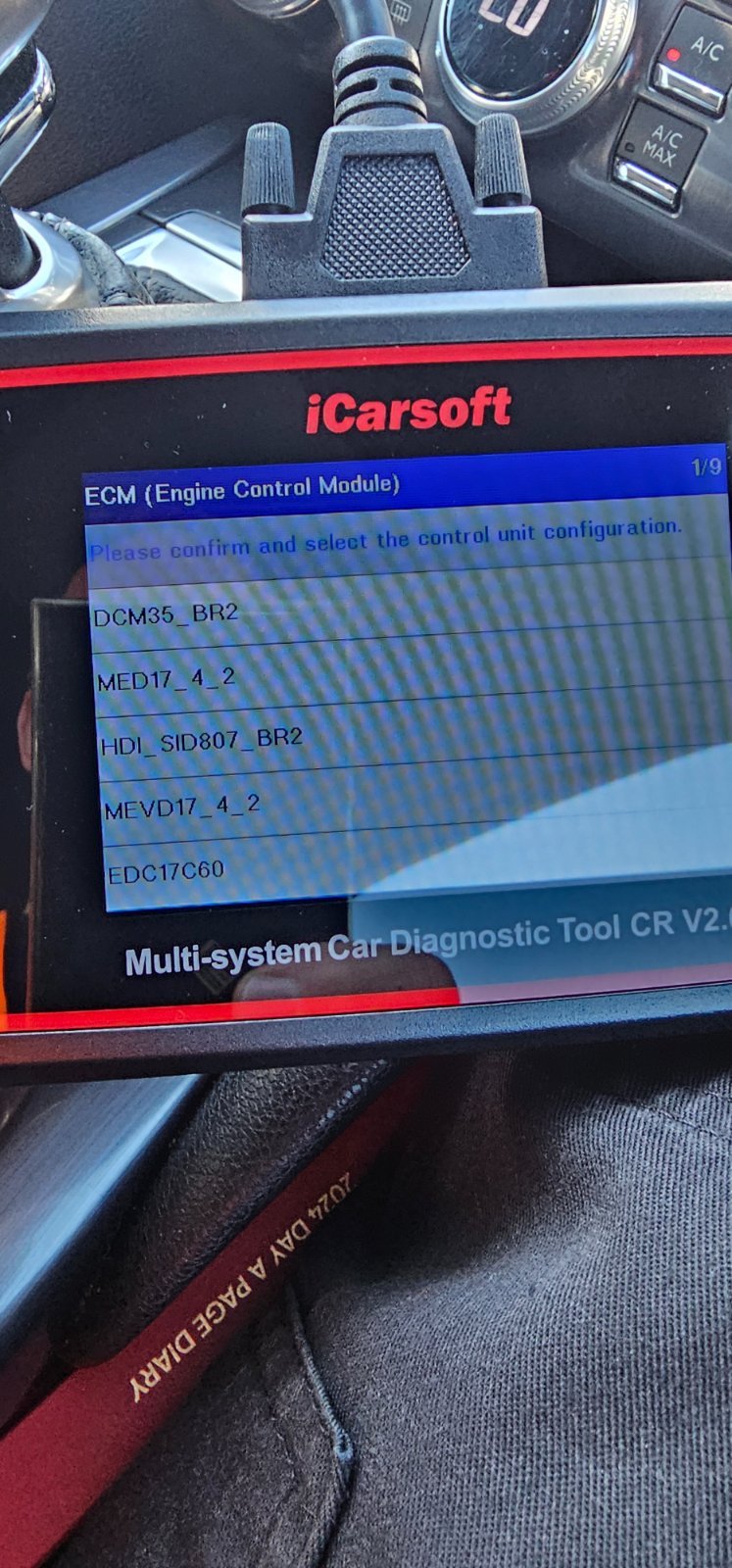

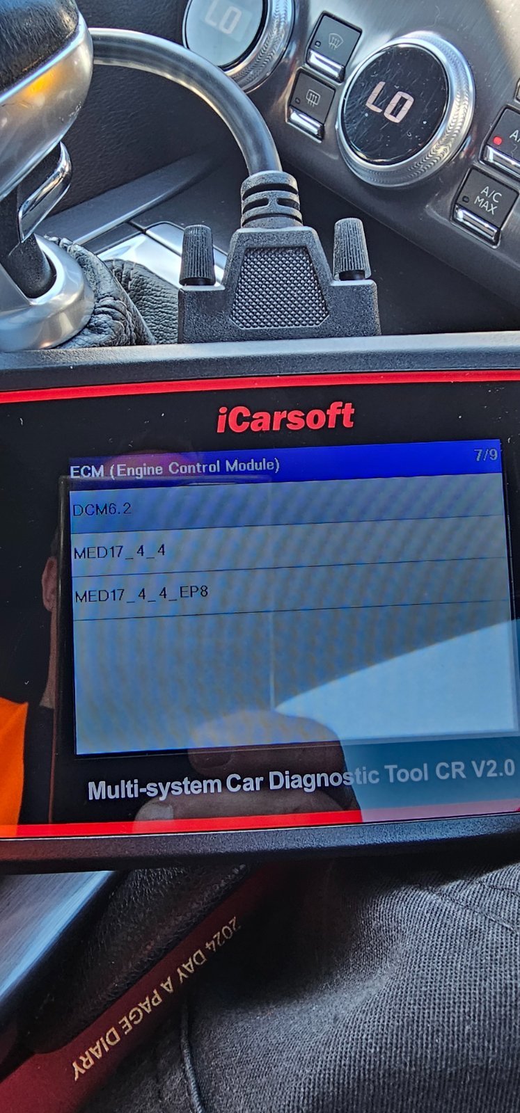

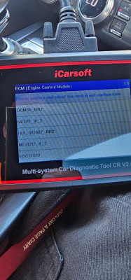

Re: DS5 AdBlue Issues P20EE00 P20F600 P2A0000 P16EA00
Hi so I got my diagnostics back and it's read the vine all OK now it's asking what the ECM is a selection of 9 how will I find out this info please
The diagnostic kit should be able to determine this by interrogation of the systems. You actually have a Delphi DCM 6.2 engine ECU.
