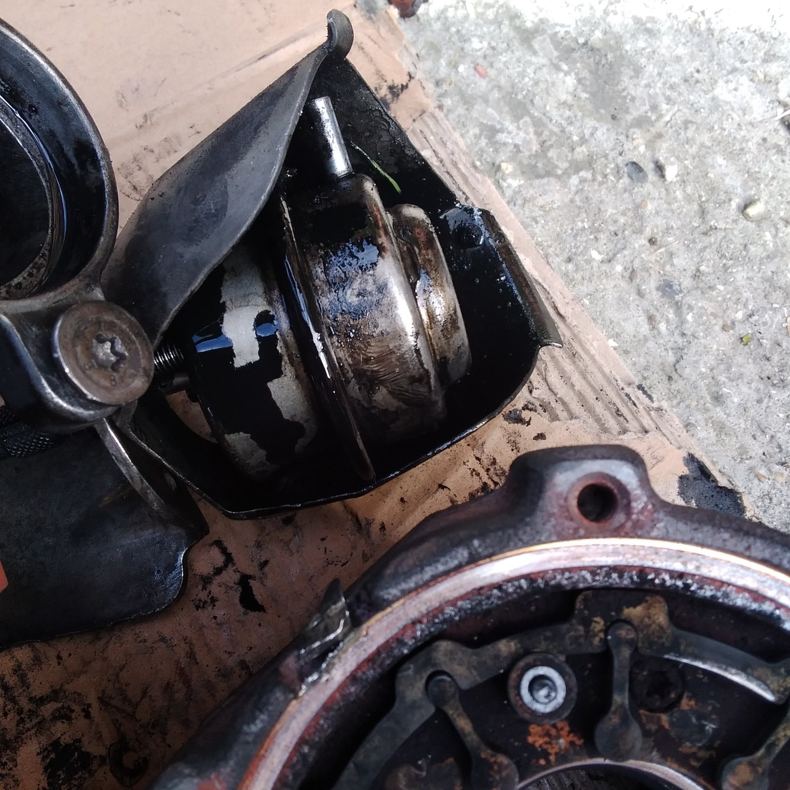

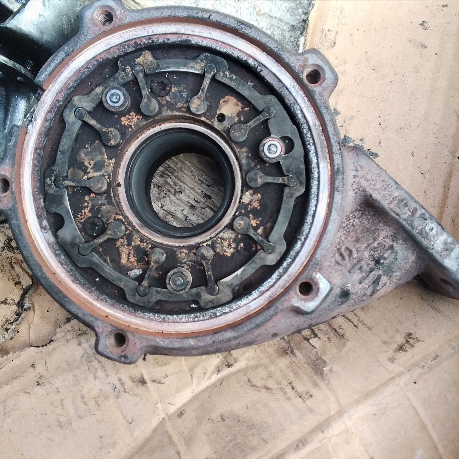

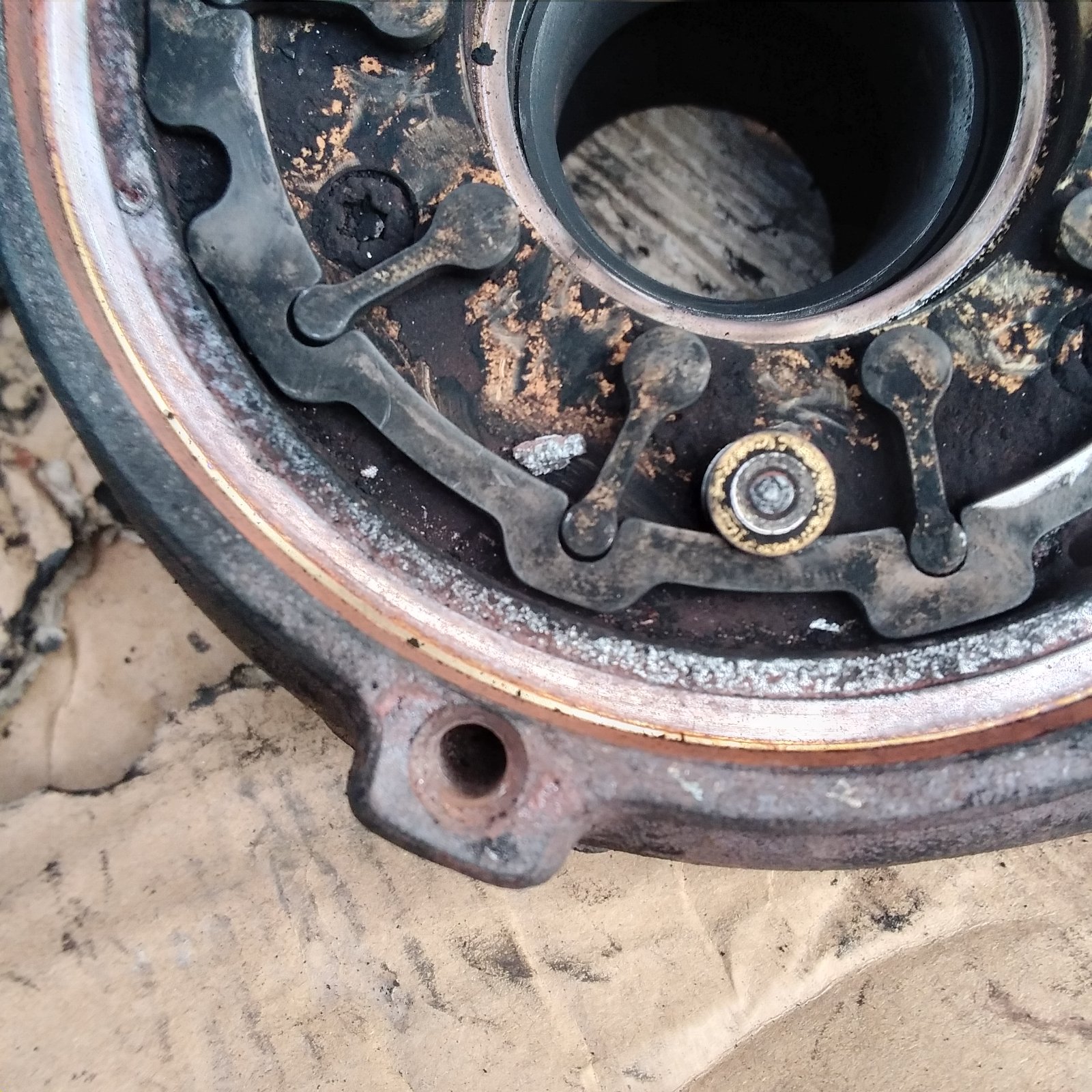

Cheers Matt, ive 5 yr warrenty on the new turbo so i got the new pipe to help the warrenty as we all know what making a claim on these can be like, ive had a 206sw 1.4hdi nice little car but dash lights would come on a lot then it did in the end give up it will to live, on the day it went to the breakers it started up then cut out again then i found out it was running on 2 glow plugs as 2 were broken and just hanging on the loom , thanks to the previous owner. My old turbo i took it a part see photos, the spindle was worn , and there was a shard of metal inside it . The shiny side the air intake was shiny on one edge and normal on the other so the blades have been rubbing one side hence a worn spindle. The banjo bolt with the tiny filter was clean when i removed the oil feed pipe very pleased with that , new one should be here tuesday fingers crossed so new oil feed pipe to a new turbo , plus I've a new rocker cover to.
Something was going wrong with the old turbo and taking it apart gives the answers.

I tested the glow plugs on my wife's 206 when I made a start on its turbo replacement - all four defunct. It started and ran (and regened) fine, I don't think HDi really have much need for the glow plugs. I decided to replace them anyway, and so regretted that decision as 2 sheared off when I attempted to remove them. That was trigger for engine out, head off and give a more thorough clean as part of turbo replacement. There was thick black everywhere, all oil system pretty grim and intake / head also full of crud from EGR+ (faulty, split diaphragm) PCV system. One injector very reluctant to come out (just early signs of injector seal failing - hard black crud stuck it inside it's tube in the head. A few hours to literally persuade it out fraction of a mm at a time. Talk about a job that kept growing!
Anyway, good work on catching the turbo early! Interesting it's been rubbing the casing, I thought by the time it was making contact like that it was right on the very cusp of catastrophic failure, so I'd take that as a massive bonus (verses dealing with an engine that's just ingested bits of turbo, the tale of woe I described is still preferable I'd say!)
