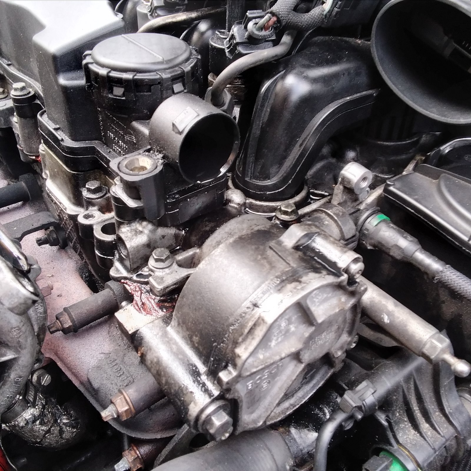

The round lump on top of the plastic cam cover contains a diaphragm / valve - on my wife's DV6 (1.6) HDi 206, this diaphragm was split. The cover will pop off with gentle prising of each of the plastic clips around its perimeter. It's not listed as a separate part in PSA terms, but I found a seller online selling replacement diaphragms. I think a split diaphragm has a negative effect on the amount of oil carried over. The plastic cam cover also has a baffle arrangement internally, giving a tortuous route for the oil laden gases. I gave this a good clean out (when doing a partial top end refurb / refresh / clean out when it was on the edge of turbo failure)

Not the one I bought (am sure was black plastic, included no new spring or cap either) but below is an example of what I mean:

Ok, the diaphragm is intact but hard the spring was gunked a bit , a new one is on its way and cap as they do tend to snap the clips, £11 non chinese too.

Similar to my experience (spring light coating of oily black gunk, diaphragm hard (though also split in my case))
I did get my original cap off without damage, but for £11 including a cap saves the need for a delicate approach!
Hope that sorts it.
Side note: I also changed the O-ring in the connection between cam cover and inlet pipe - my oily mess wasn't confined to inside the pipe only, was external and all over the vacuum pump below too.

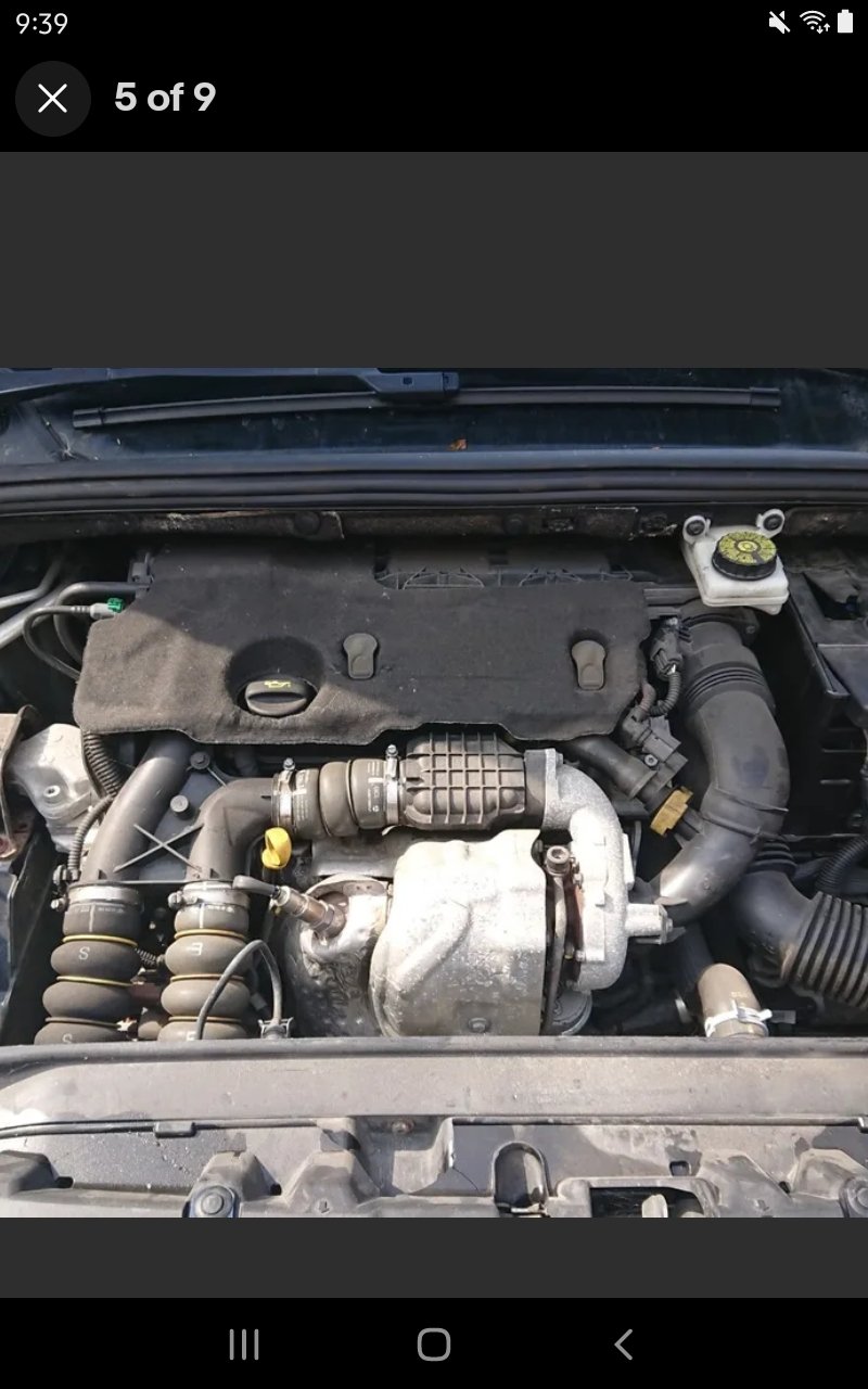

Interesting from your pictures your DPF and catalyst is one piece unit, this has a two piece item, great big band clamp around the middle. Not sure if that means you've a replacement unit there or it changed between (2004) mine and 2006 (yours)
Matt
