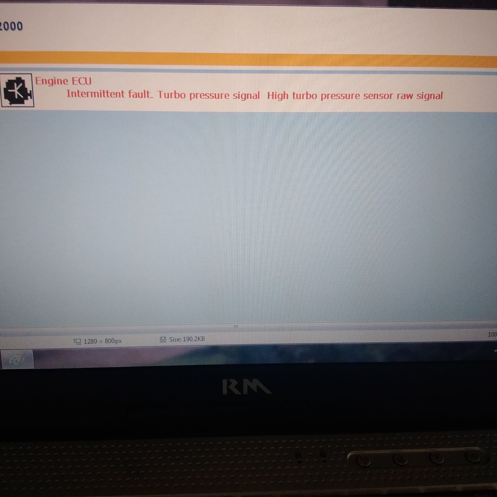

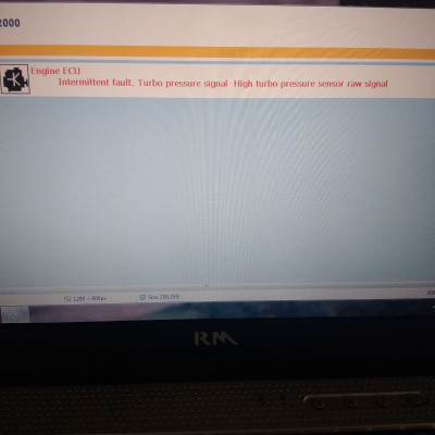

MattBLancs , ive had the time today to get the new finds with pp2000 , see attached.

Also had the p0238 , did a second scan pp2000 came up with the above, this is the first time nothing has come up regarding the egr,
