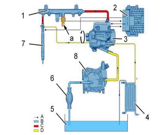

- x 6950
Re: Engine turning over but refusing to start
Your fuel tank has a gauge without pump - for info Kenny. Fuel Supply Components Below:
Key:
Key:
- "A" Electrical links
- "B" Low pressure fuel circuit
- "C" High pressure fuel circuit
- "D" Heated low pressure fuel circuit
| Reference | Designation | Electrical diagram correspondence |
| (1) | Fuel high pressure common injection rail | - |
| (2) | Engine ECU | 1320 |
| (3) | high pressure fuel pump | 1208 |
| (4) | Fuel cooler | - |
| (5) | Fuel tank | - |
| (6) | Manual fuel primer pump | - |
| (7) | Diesel injector (1) ; (2) ; (3) ; (4) | (1331, 1332, 1333, 1334) |
| (8) | Fuel filter | - |
| "a" | Fuel high pressure sensor | 1321 |

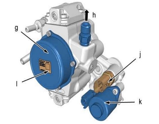

- x 6950
No, on these, they use a transfer pump which is built into the High Pressure Fuel pump which is all electronically controlled. It is shown as 'g' below.
"g" Transfer pump (pre-supply).
"h" High pressure fuel outlet.
"j" Diesel temperature sensor.
"k" Fuel flow regulator.
"l" High pressure fuel pump identification plate.

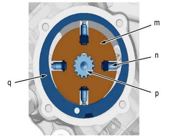

May as well put up some more about the internals for the pump in case it helps with the case.
"m" rotor.
"n" Fins.
"p" High pressure pump shaft.
"q" Stator.
Role of the transfer pump:
A regulation valve maintains the transfer pressure at a constant value (6 bars) throughout the engine operating range by returning a proportion of the fuel to the transfer pump inlet.

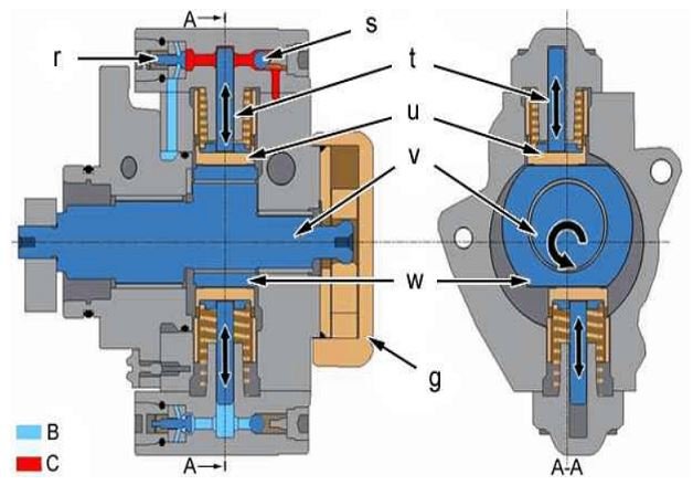

Creating the High Pressure
The high pressure fuel pump consists of two radial pistons.
The roller pushed by the eccentric pump shaft moves transversely: The high pressure is generated in the fixed part of the fuel high pressure pump.
"B" Low pressure.
"C" High pressure.
"r" Inlet valve for the compression chamber of the fuel high pressure pump.
"s" Outlet valve for the compression chamber of the fuel high pressure pump.
"t" Plunger piston.
"u" Thrust pad.
"v" Eccentric pump shaft.
"w" Roller.
Fuel high pressure creation cycle:
"m" rotor.
"n" Fins.
"q" Stator.
- To pump fuel into the fuel tank
- To supply the fuel high pressure pump (Compresses the fuel upstream of the fuel flow regulator)
- Lubrication and cooling of the fuel high pressure pump
"B" Low pressure.
"C" High pressure.
"t" Plunger piston.
"u" Thrust pad.
"w" Roller.
- The eccentric pump shaft "v" positions the roller "w" in the low position.
- The plunger piston "t" descends.
- The fuel arriving from the transfer pump "g" via the fuel flow regulator is drawn in through the inlet valve "r".
- The fuel penetrates into the body of the pumping element.
- When the eccentric pump shaft "v" rotates, the roller "w" rises again and pushes the plunger piston "t".
- The pressure in the body of the pumping component increases and becomes higher than the transfer pressure: The high pressure pump compression chamber inlet valve "r" closes.
- The pressure in the body of the pumping component continues to increase and becomes higher than the pressure from the fuel high pressure common injection rail: The high pressure pump compression chamber outlet valve "s" opens.
- The fuel is delivered to the high pressure pump compression chamber outlet valve "s".
