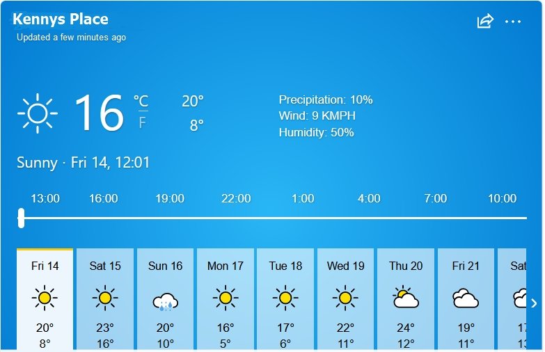

Hi Kenny, best I can do. Not too hot.....KennyW wrote: 13 Jan 2022, 16:05 Also can someone fix the weather as it's getting colder and is going for my back.
Kenny
Good luck, hope it is a simiple as a corroded wire, and it is easy to get to.
Stu

Thanks for the replies and encouragement special thanks to Stu for the weather forecast
