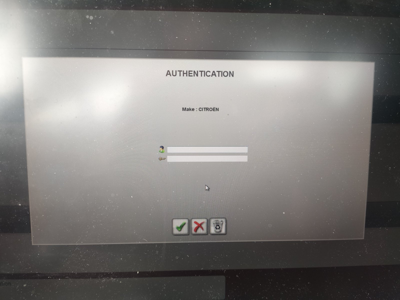

Tried again using Diagbox 7.57 and 09467 as rpo still get the communication error after it starts erasing the faults. also this pops up in diagbox asking for some sort of authentication

Re: Citroen c5 2003 Engine trouble
The 2 installations can't co-exist as far as I can see. You can have DB 7.** or DB 9.** but not both together.

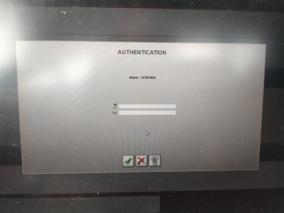

Ok, so the 7.57 screenshot only usually only appears when using Diagbox (which should not be the case for your C5 of this year) and you are trying to use a function requiring PSA tech log in. You shouldn't even be getting this far - as when you launch DB, and select the model, it should offer you SCANTOOL or LEXIA - which you then choose LEXIA, let it pick up the VIN and enter the RPO.
Unread post by Kristian27 »
this popped up in the background while being in lexia
