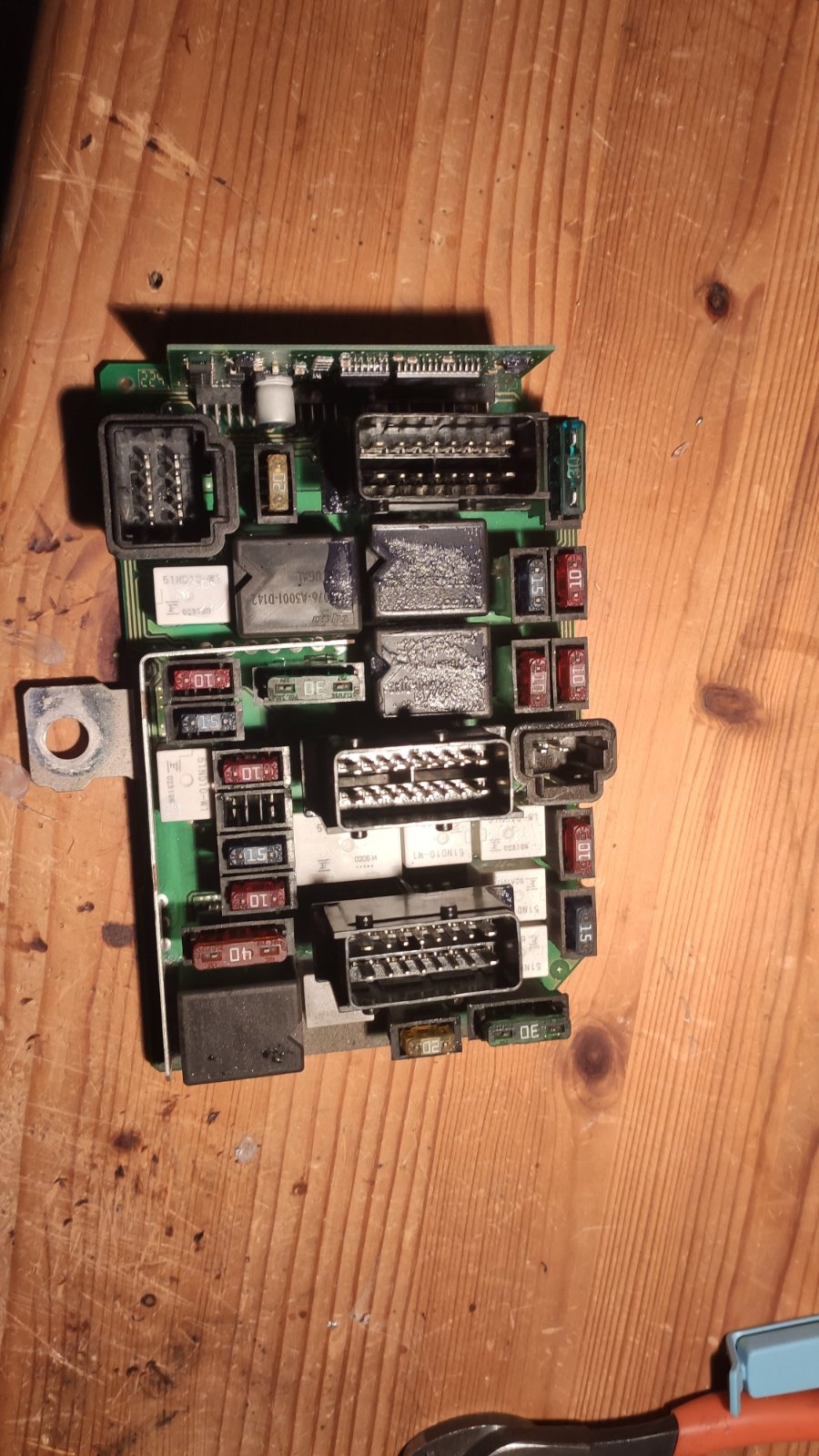

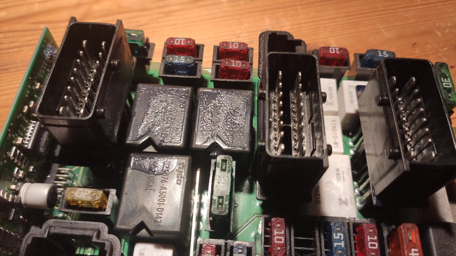

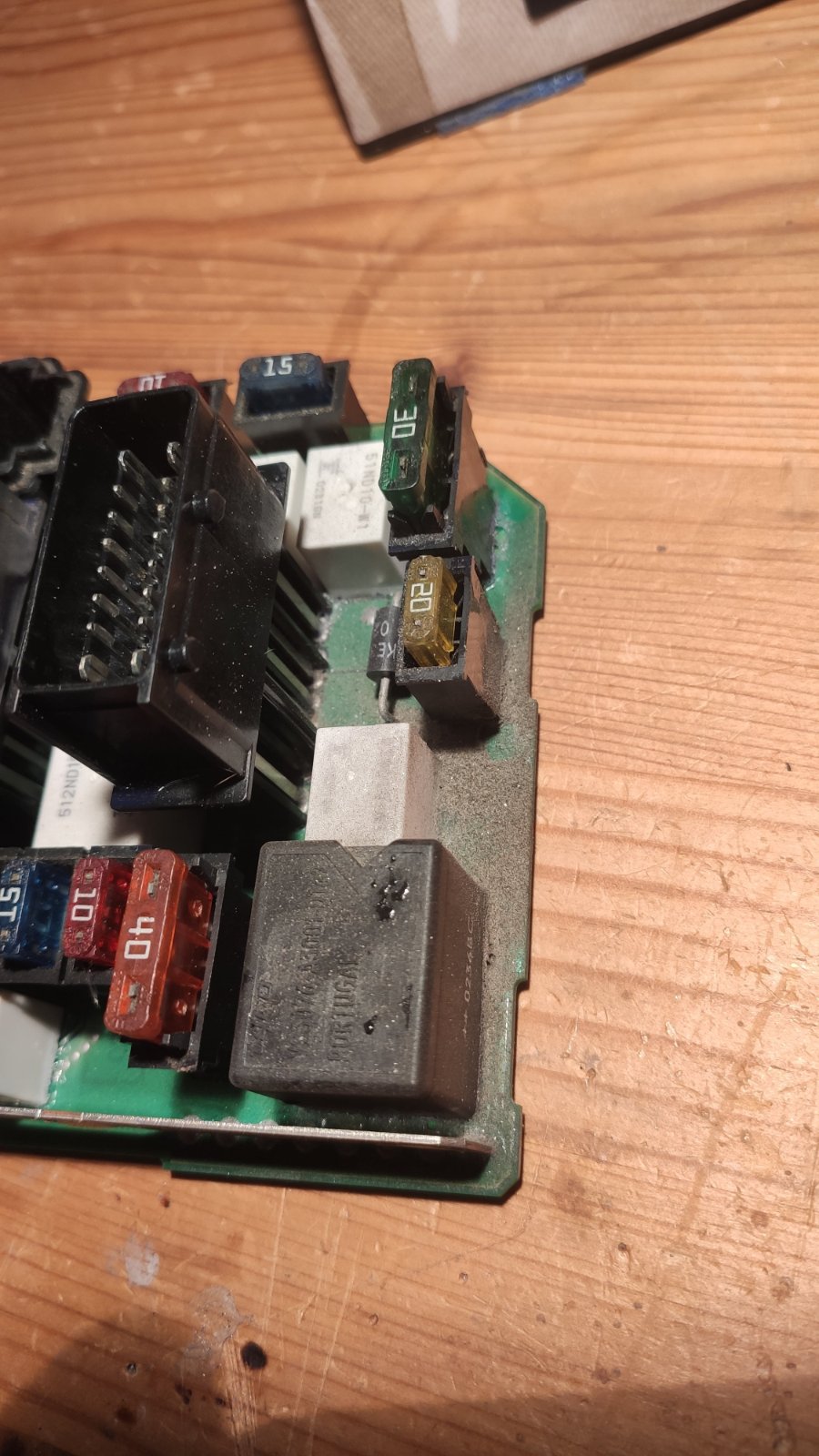

So I took out the engine fuse box circuit board but can't find anything that looks unusual except that it's a bit dirty and there is a strange material on some of the components
Measured all relays, coil resistance seems good on all and good connection in NC position
I also measured the resistance on the injectors all 4 are withing 11.2-11.4 ohms so those seem ok

Re: Citroen c5 2003 Engine trouble
It does look like it has been through the wars....

Kristian27 wrote: 22 Jan 2021, 20:53 So I took out the engine fuse box circuit board but can't find anything that looks unusual except that it's a bit dirty and there is a strange material on some of the components
If it's the laquer type stuff that looks bubbly in some parts this is completely normal, it appears to be some sort of protection lacquer type stuff to protect the PCB & components.
