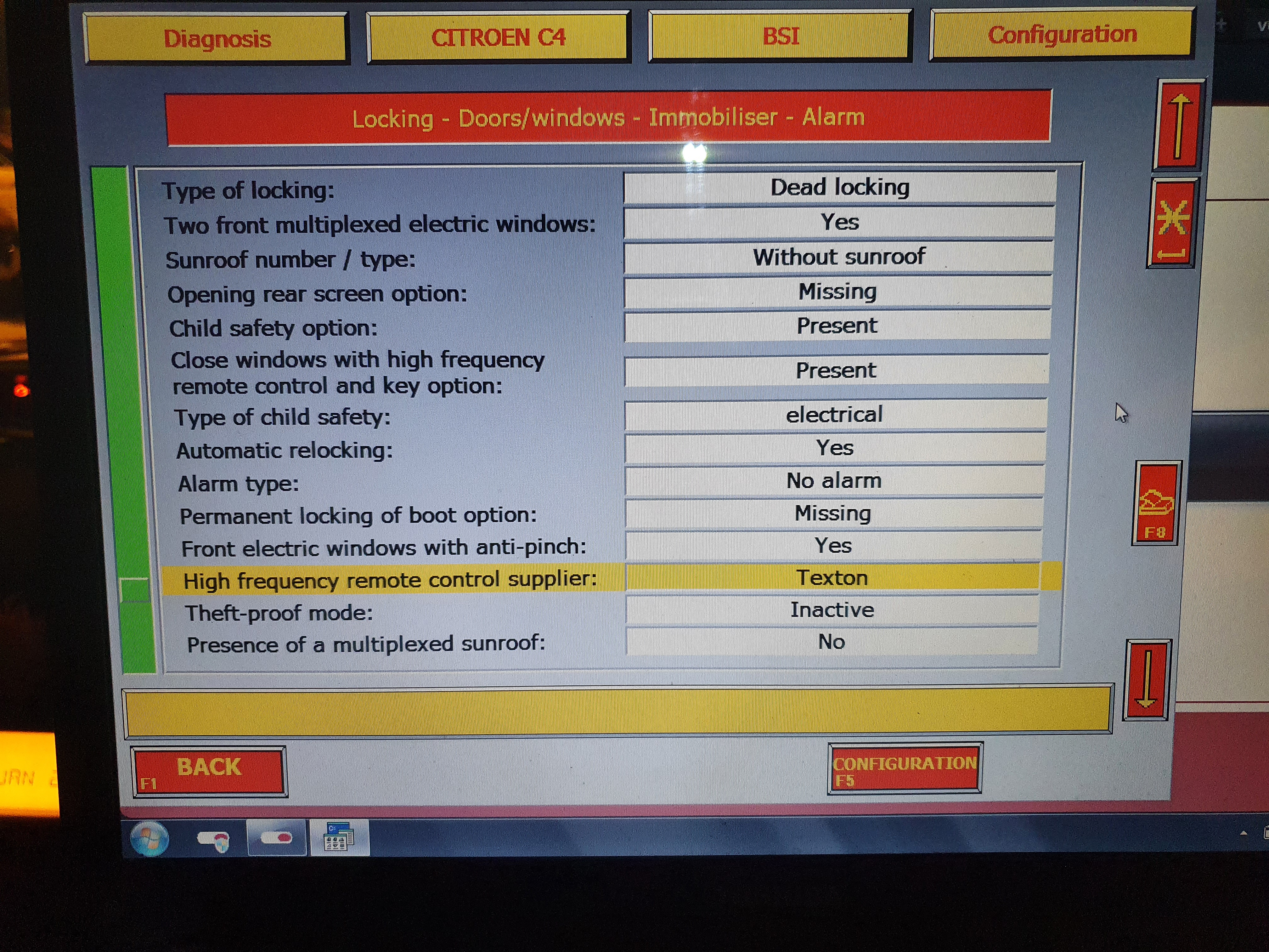

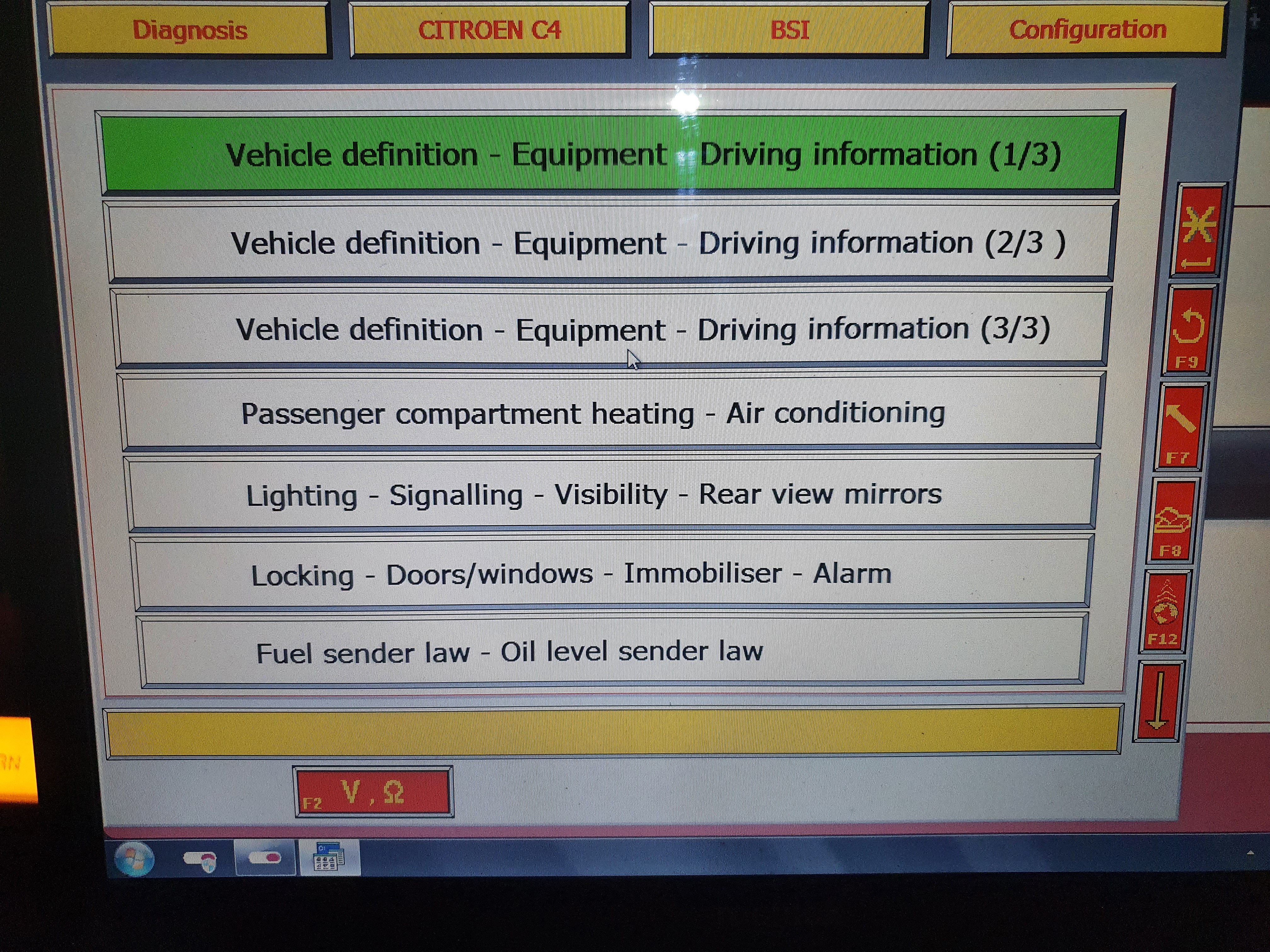

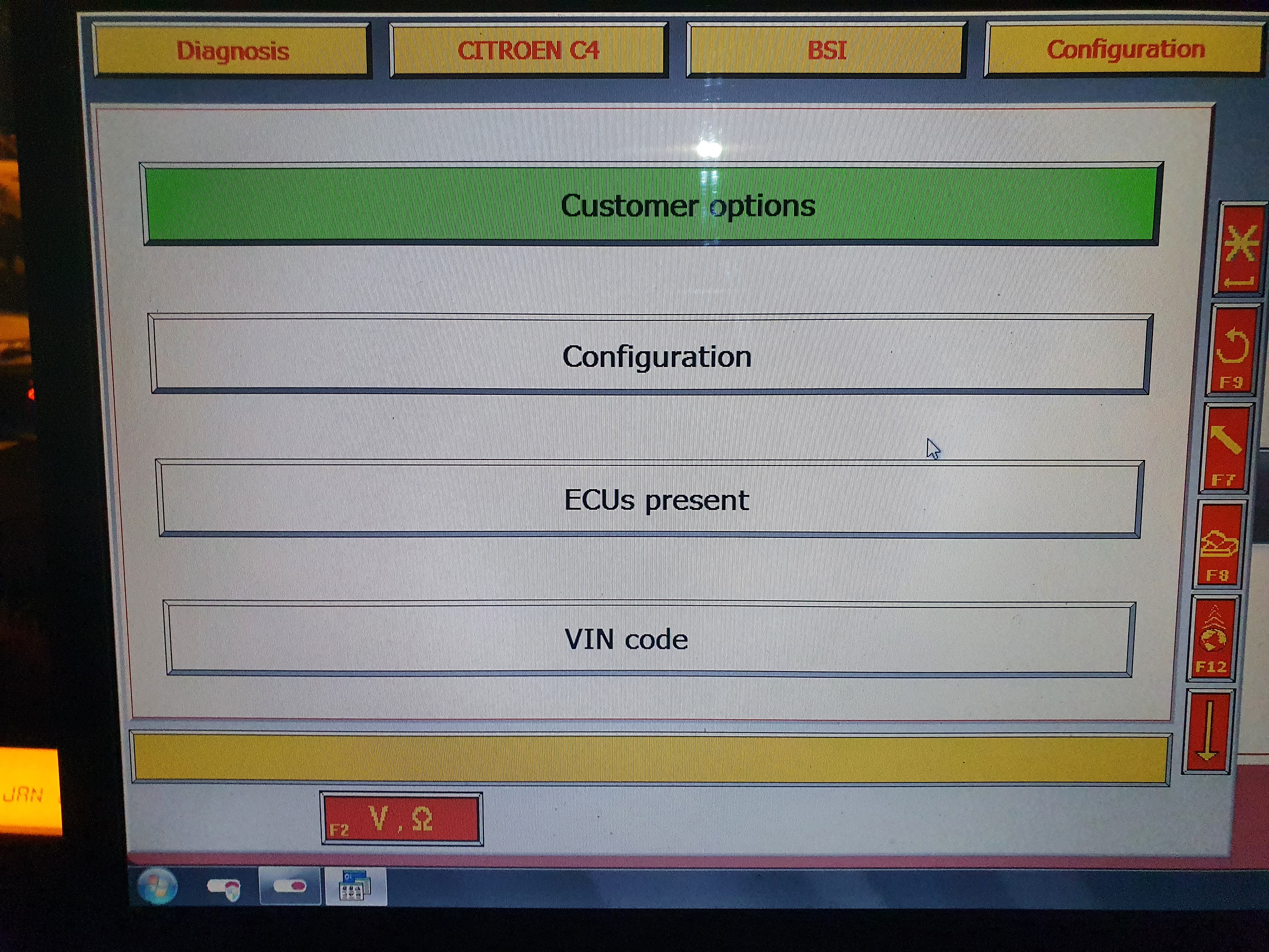

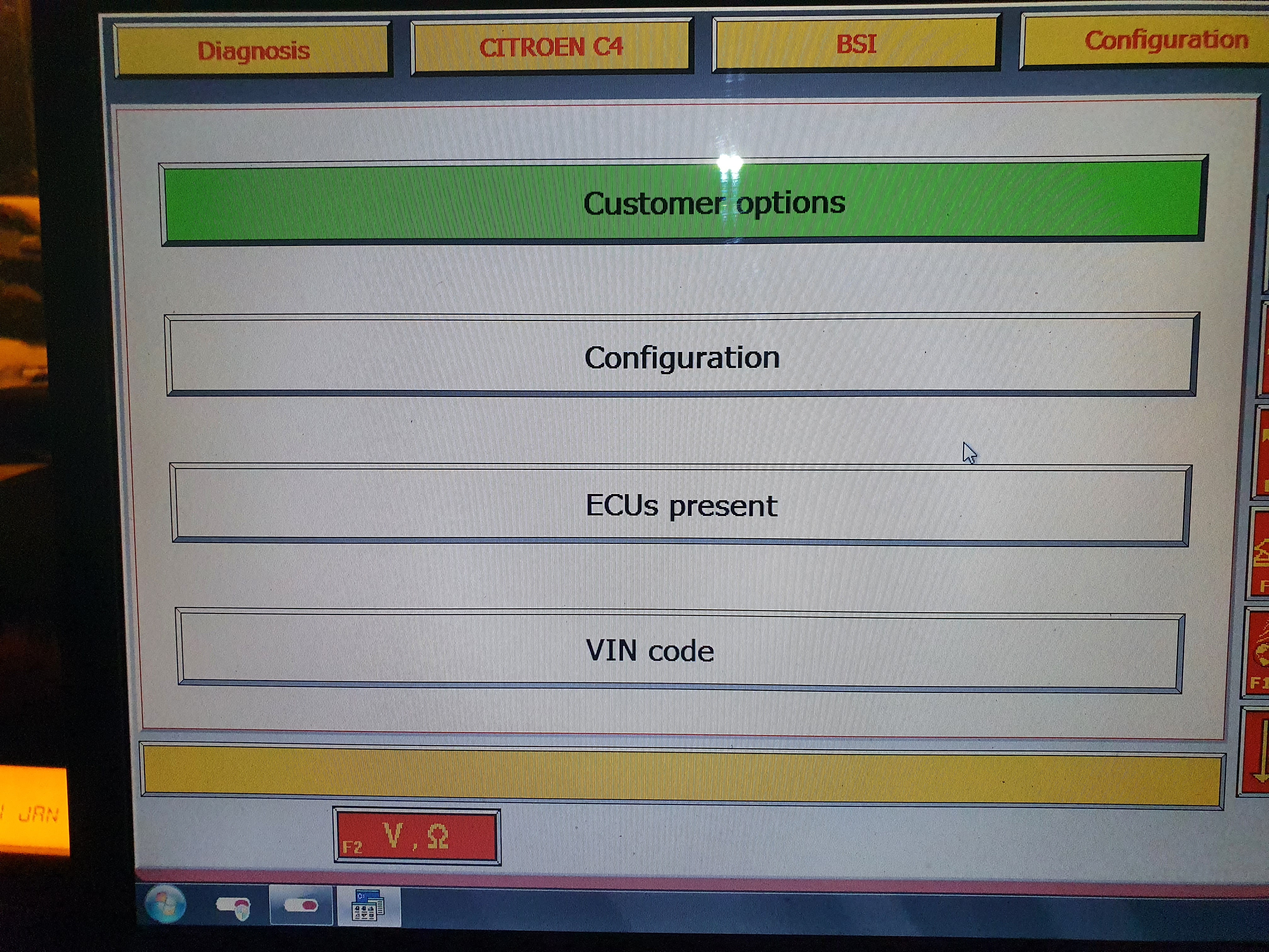

I tried to follow the video, but I either don't have the correct Lexia set up or something isn't right with my car :?
This is what I found....
I could "not" find any other options than what is in the photo's. No other options to code the keys or anything.
Not sure where to go from here :roll:
Has anyone seen the plot? :?
