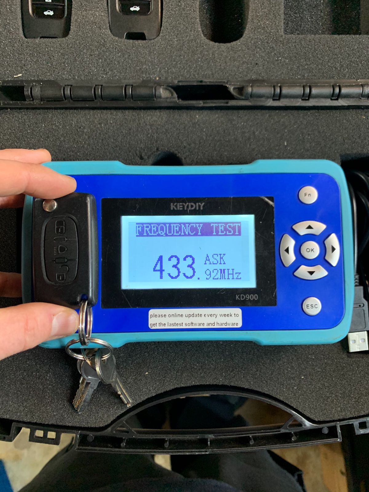

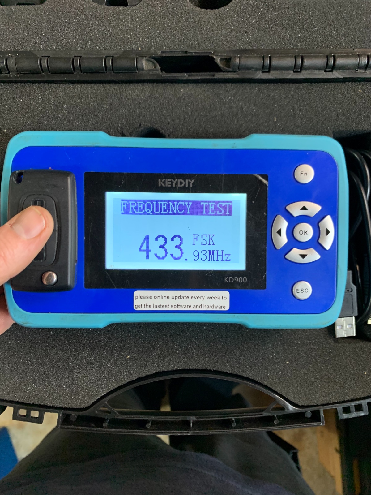

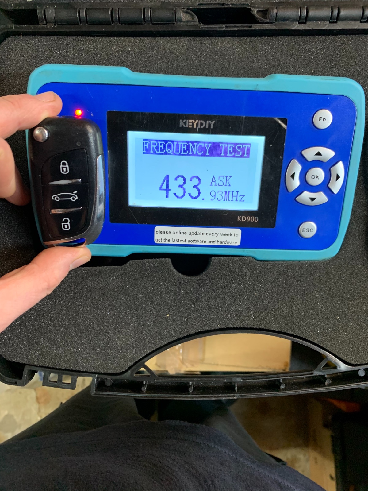

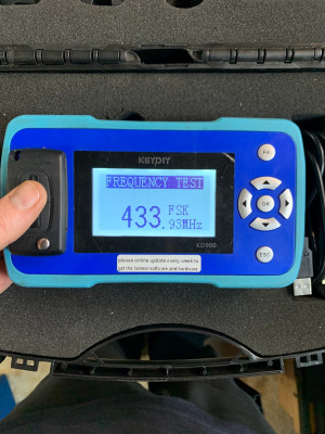

There are 2 different frequency types FSK & ASK if you get the wrong type it wont program correctly. With how cheap they are you could always just order 1 of each?
I have had success with the cheap keys too.
Even if you have lexia & the code you will still need to get the blade cut, the issue you may have is getting an auto locksmith to cut a cheap keyblade, some can be a bit funny about doing this as the cutter bits for the machines are very expensive & they can be damaged by cheap keys. I know PaulR had someone do it for him so you may be lucky.

Yes it will be 433 MHz but just because it’s rectangular type doesn’t mean its ASK, you really need to test the signal. Going by the remotes below the likleyhood it its ASK though.
The pics below are a 3 button C5, a 2 button C3 picasso & the odd shaped one is a 3 button C4. The C4 one is an aftermarket key but the original would have been the rectangular type, the middle button is actually a headlight button although the pic shows a boot release.
If its a regular C4 you will likely need a VA2 type blade.
