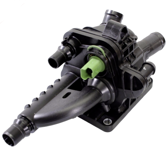

They are two different things:
Expansion TankCoolant Outlet Housing
You can see the green temp. sensor contained in it.
