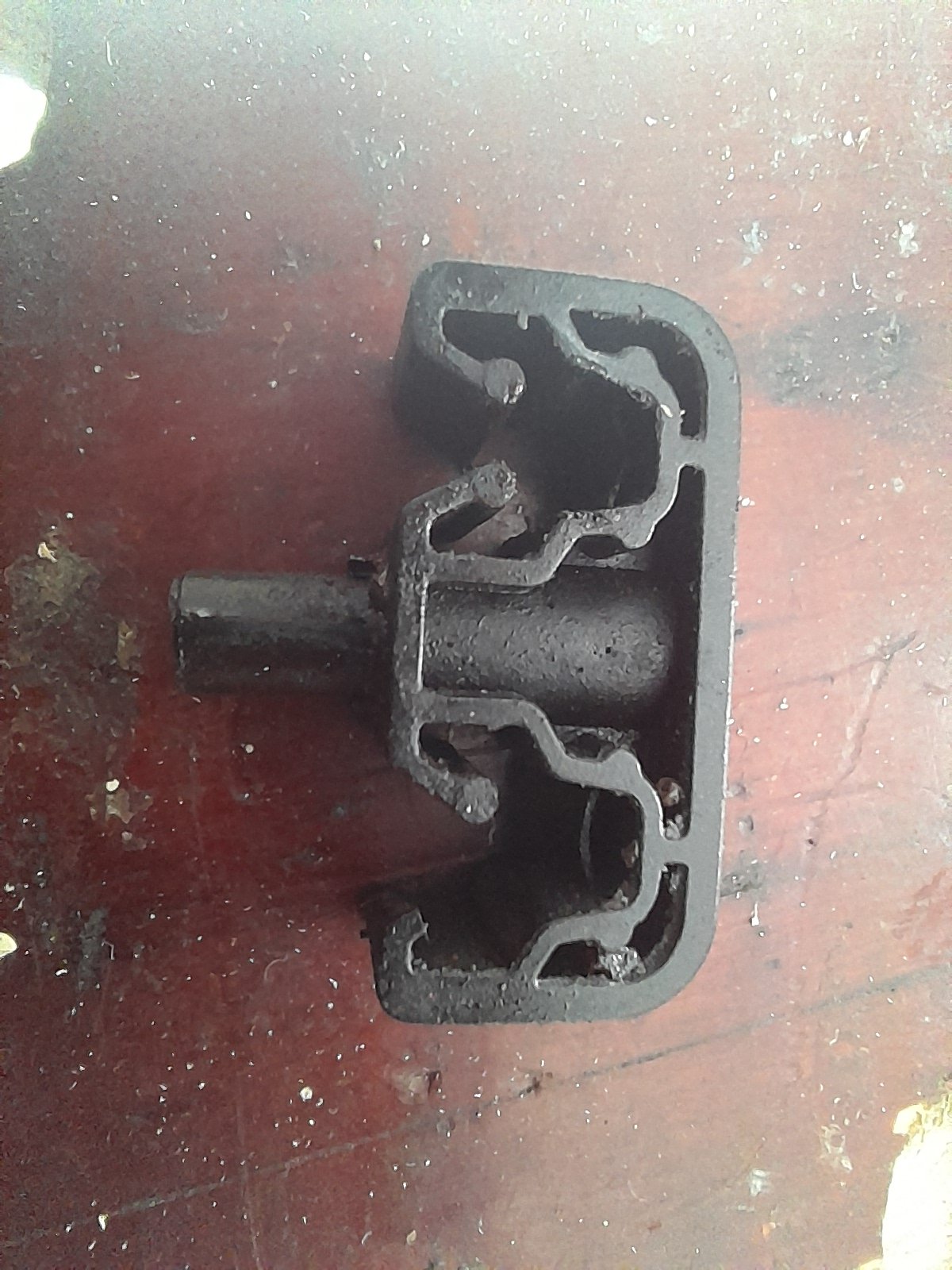

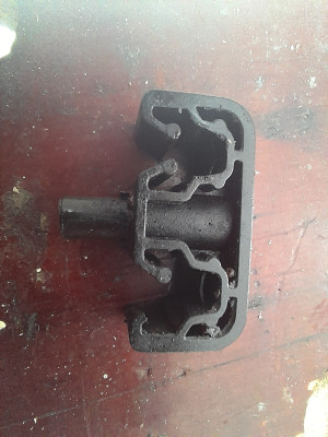

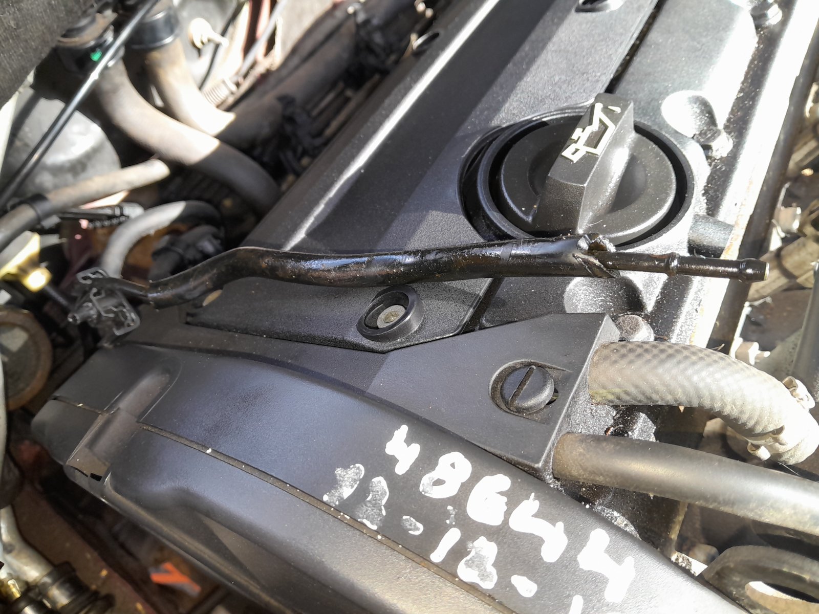

I have the same problem with this pipe leaking. Here's what I've done. Hoping the info is useful to someone else.
This photo shows the plastic clip that holds the pipe to the side of the engine bay.
It has two channels in it. One holds the pipe and the other is free. I reached up from the wheel arch, was able to slot a screwdriver into the free channel and prise the clip off. I could then straighten out the end of the pipe, force it into the engine bay and bend it upwards.
I then had really good access to cut the rusty end off the pipe. Just waiting for a silicone tube from eBay to patch it up.
(In the photo you can see a sheath on the pipe. That was a previous unsuccessful attempt to fix the leak.)
Posts: 11855
Joined: 28 Mar 2013, 21:05
x 2008
Re: Xantia HDi Front Offside Hydraulic Pipe
Unread post by Stickyfinger »
I would 100% NOT use silicon tube from ebay as I expect it not to be the correct type (Fluoro Silicone). Standard Silicon is porous (well more oil-scopic) and mineral oil will break it down.
Use the correct grade of buna rubber OR use the polyurethane "hard" tube used in truck air brake systems.
