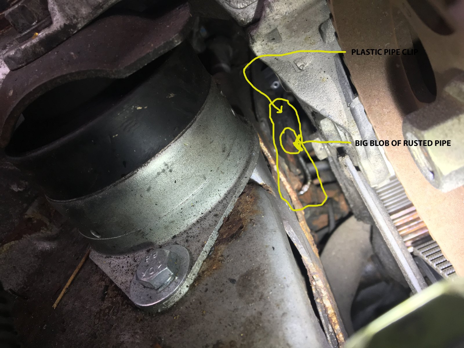

Well. I finally got around to looking at the suspension pipe.
Made for a slightly depressing day.
I cannot see how I can repair it without taking the engine out...
Give me some hope PLEASE!
I've had a right good root around. I cannot tell if it cannots to the brake doseur valve or whether it runs along the bulkhead. It seriously looks as if it has to come out to repair it. Too tight to even get in and cut the pipe or manipulate it in any way.
I cannot even see how it clips into the clip. Does it just push in? If so, I can probably lever it out at the risk of snapping it where the corrosion is. I might then be able to drop it down a bit to get the pipe and clip on.
- Posts: 55013
- x 8343
Re: Xantia HDi Front Offside Hydraulic Pipe
What pipe is it Roger? Can you determine where it starts and ends? If you can then you could make up a new pipe, re-route it safely and conveniently and simply leave the old pipe in-situ...
Or remove as much as you can. If it breaks as you lever it out of the clip ten no worries, it might even make it easier to remove!
