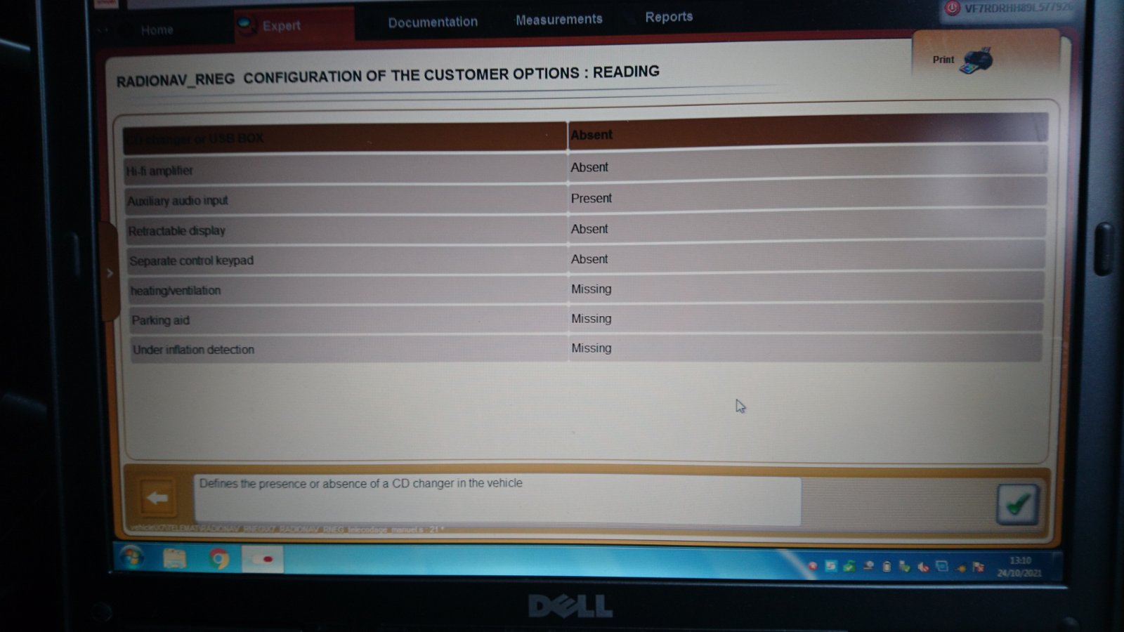

Re: I Phone issues with MyWay / WIPNAV
Unread post by admiral51 »

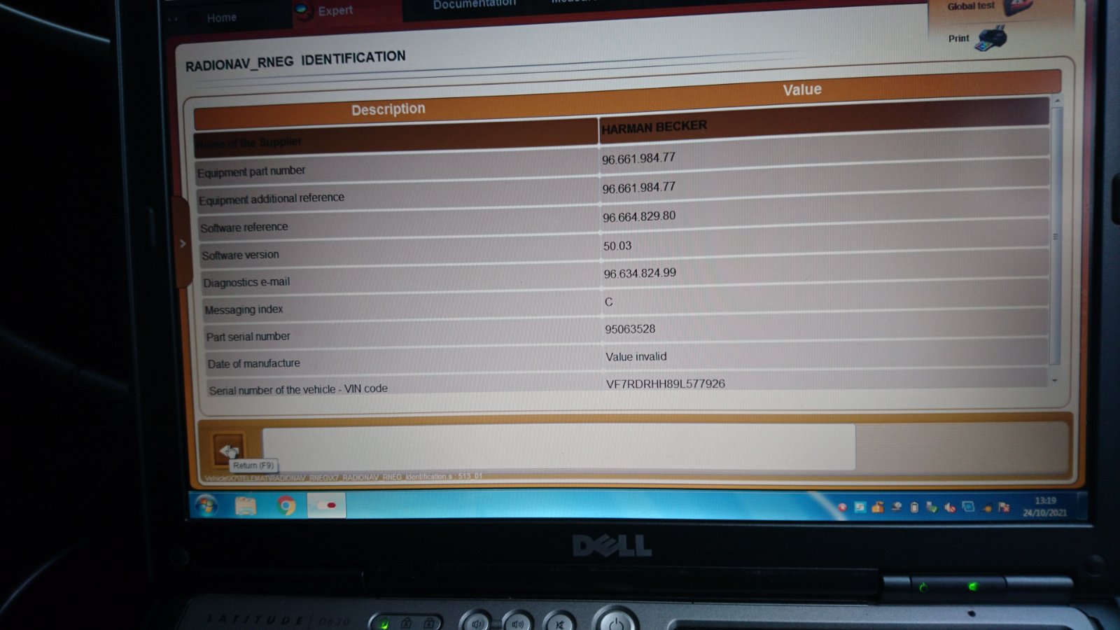

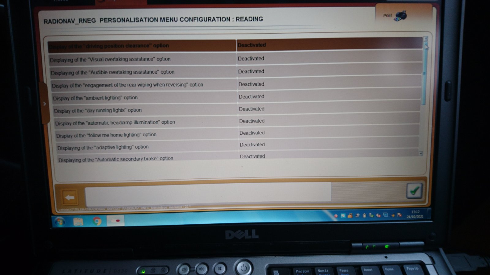

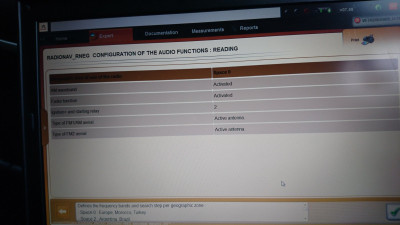

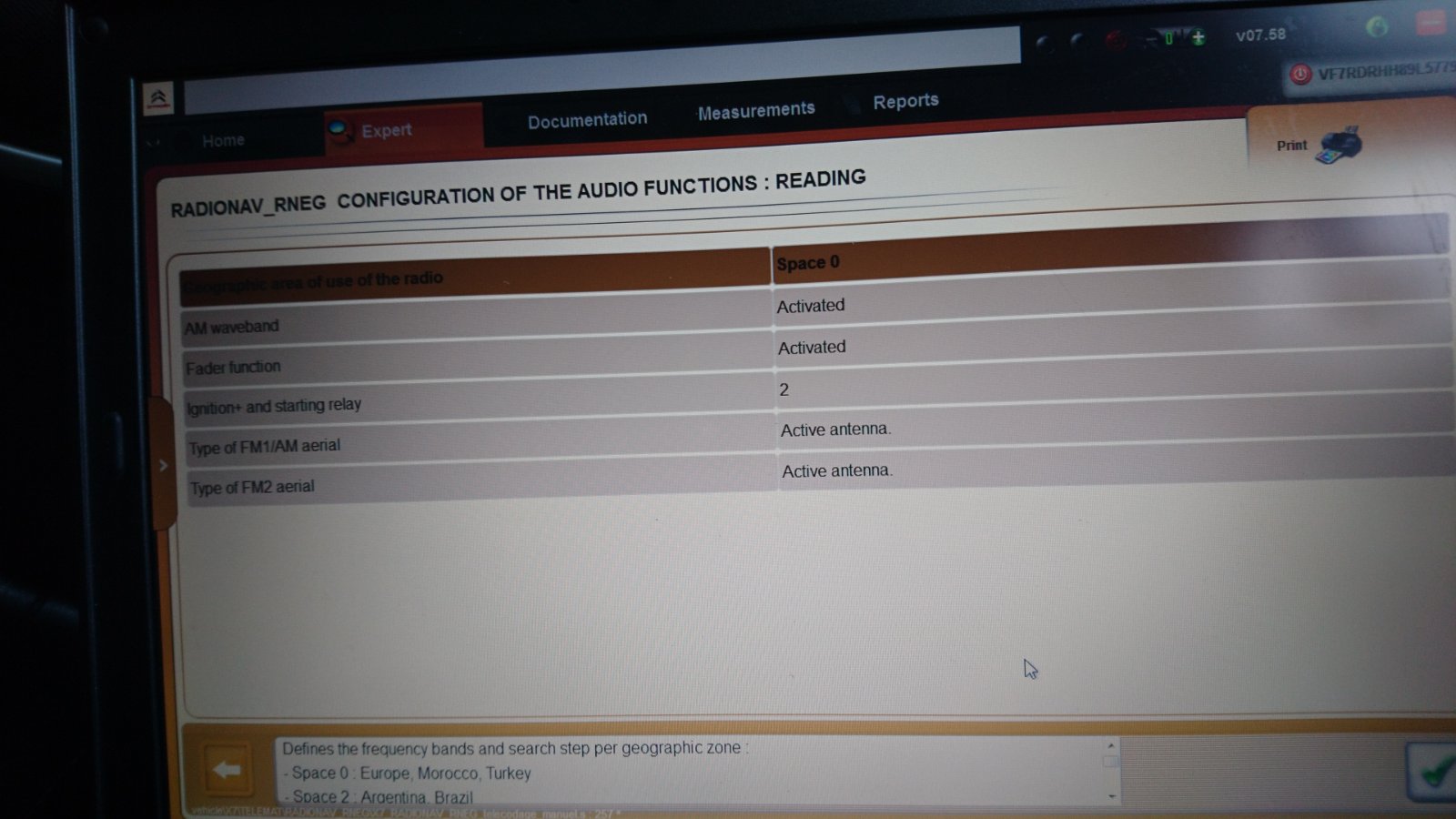

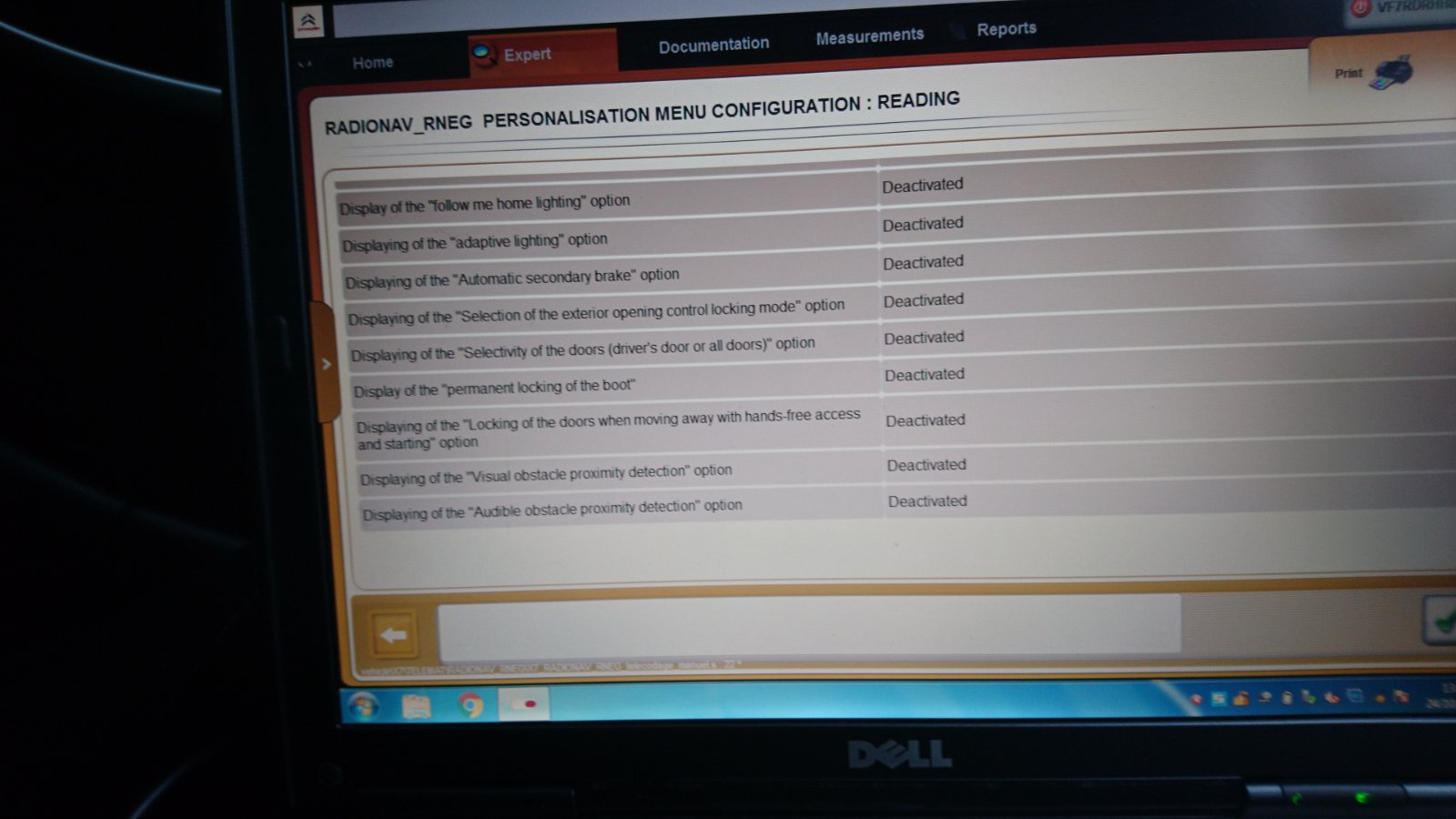

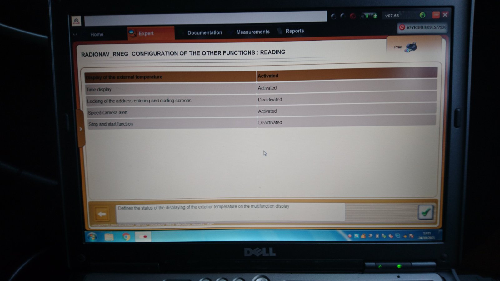

These are the pictures that I have taken from the configuration menu's i could find of the current head unit.
Pretty sure i was in the right menu as it also allows me to put the Vin number in to code the unit to the car.
🤞 That's all the info needed. 🙈
On the last picture the only thing that seems odd is that the date of manufacture or that intended to be like that.
x 6963
That's not uncommon Colin. That's great, I should be able to get anything else from the VIN
