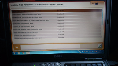

Re: I Phone issues with MyWay / WIPNAV
These are the pictures that I have taken from the configuration menu's i could find of the current head unit.
That's all the info needed.
On the last picture the only thing that seems odd is that the date of manufacture or that intended to be like that.
Pretty sure i was in the right menu as it also allows me to put the Vin number in to code the unit to the car.That's all the info needed.
That's not uncommon Colin. That's great, I should be able to get anything else from the VIN
