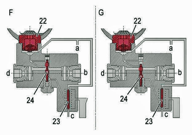

The only other thing I can think of is the firmness regulator at the front. I know that constant sinking of the rears on a C6 and an X7 is due to a faulty valve on the rear hydraulic block and that can be cleaned up and repaired where it gets stuck. So it's possible you may have a similar issue on the front regulator with your C5.
Key:
F: Soft status, electrovalve not supplied
G: Firm status, electrovalve supplied
G: Firm status:
Solenoid valve supply
Movement of the electrovalve slide (23), freeing the reservoir return and blocking the hydraulic supply coming from the BHI
The bottom part of the slide (24) is at the pressure of the hydraulic fluid reservoir. The top part of the slide (24) is at the pressure of the hydractive 3+ sphere
The difference in the pressure at each end of the slide (24) causes its movement. In its new position the slide (24) blocks the passage of hydraulic fluid between the RH suspension and the LH suspension. The hydractive 3+ sphere is isolated from the suspension circuit
F: Soft status:
Stopping of the supply of the electrovalve
The slide (23) moves under the effect of the supply pressure of the BHI
The return to the hydraulic fluid reservoir is blocked. The pressure under the lower part of the hydraulic isolation slide valve is identical to that of the BHI
The upper part of the hydraulic isolation slide valve is identical to that of the BHI. The slide (24) moves under the action of the integral spring
Flow of hydraulic fluid between the right hand and left hand suspension is possible. The hydractive 3+ sphere communicates with the suspension circuit
Key:
| Reference | Designation |
| "a" | Towards the BHI |
| "b" | Towards the right hand suspension |
| "c" | Towards the reservoir return |
| "d" | Towards the left hand suspension |
| 22 | Hydractive sphere 3+ |
| 23 | Electrovalve slide valve |
| 24 | Hydraulic isolation slide valve |
G: Firm status:
F: Soft status:

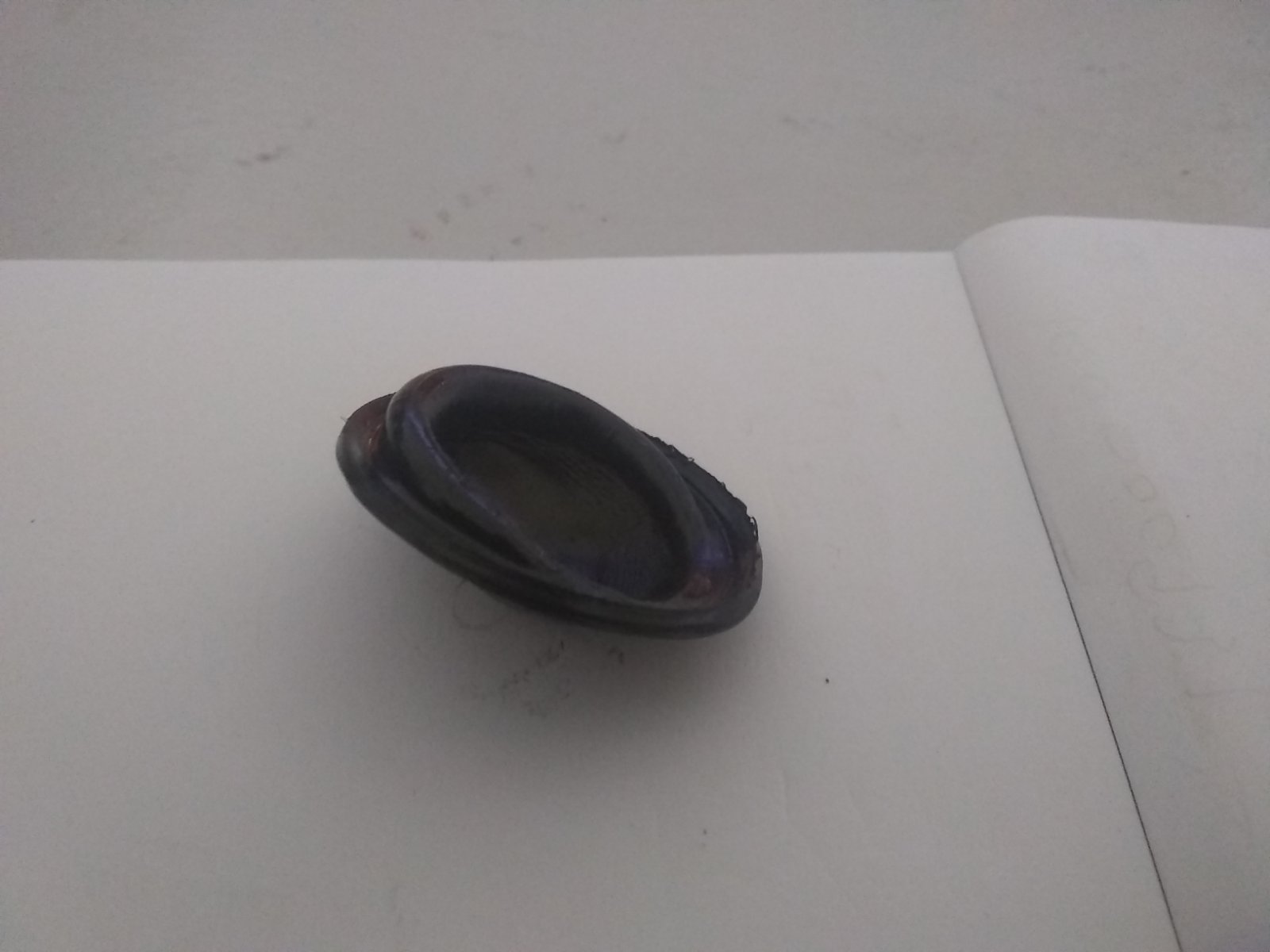

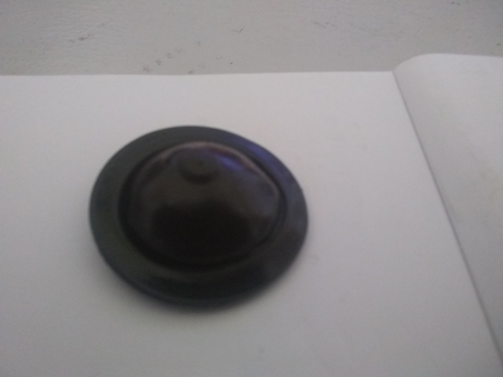

Re: 2007 c5 suspension
i wonder could this be the problem? this is the rubber diaphram at the end of the pump very much out of shape compared to the video i would love to share some pictures but cant remember how!
well i have fixed it! as of 6pm it is sat normally in the garage as to what was the problem i dont know the only item i found defective was the the diaphram which i reshaped using hot water,and the only other item replaced was the center sphere. the suspension initially started to sink as before but after some arobics it slowed the sinking down and then out of curiosity i hit the sport button and the sinking went away so i cycled it up and down and put it back into normal and it has been fine ever since so tomorrow i will put it back together and give it a test run Citroens dont you just love them!!
- x 6956
By switching to sport mode you'll have triggered the electrovalves in the firmness regulators, so I'm wondering if they became stuck and this has possibly freed it. Fingers crossed that this is it, but if it is - then it's likely the valve is sticking and that is causing the fluid return to the reservoir.
