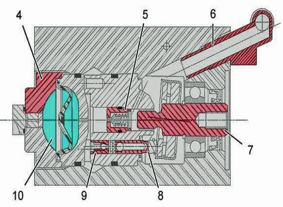

Here's the internals of the BHI, which is what I think your were after:
ReferenceDesignation
4Anti-pulse accumulator, flow regulator
5overpressure valve
6Hydraulic pump air intake aperture
7Hydraulic pump shaft
8Hydraulic pump piston
9Delivery valve
10Chamber containing compressible gas

yes i watched that pretty much i dentical to mine i think i will clean the motor and pull the diaphram and check it put it back together and give it another go, my other option is to start swopping stuff from my other car but i dont really wont to go that root.When you look at itin that picture there is not really that much to go wrong with the pump!

i wonder could this be the problem? this is the rubber diaphram at the end of the pump very much out of shape compared to the video i would love to share some pictures but cant remember how!
