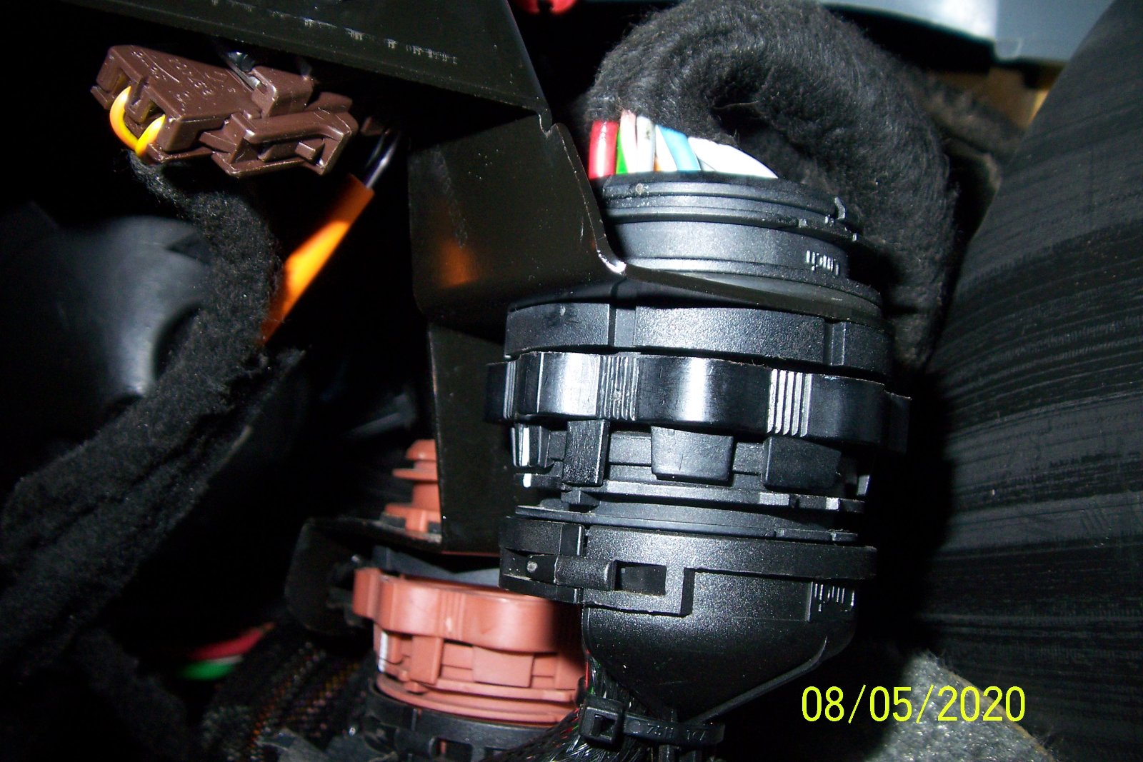

I've just spent couple of hours on the fan thing with my more 'bendy' pal & have discovered that :-
a/ the screw at the lh rear of the glove box releases the 'computer' which semi obscures the fan.
b/ the bracket holding the 2 large round cable connectors simply pops off from a ball headed fitting. If these connectors are 'split' & moved aside, access will be improved.
d/ It seems that access may be fine if the glove box could be removed but removal of screw in a/ plus 3 screws at the top front edge of the box still leave it firmly attached. Does this come out without dismantling the entire dash?
e/ The 2 large cable connectors have what appear to be 'line up' marks on 'collars' which can be turned but I'm reluctant to try seperating these by what would be mostly touch without knowing exactly how as any damage to them could be irreparable. How do these split?
Sorry to be long winded bore about this but it really is difficult trying to access & dismantle something I can't properly see whilst performing gymnastics so any help appeciated.

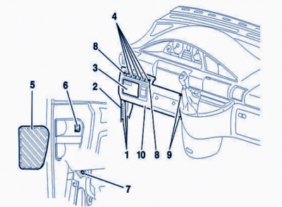

Ok, so there is no mention or requirement for removal of the glovebox Vic. The only part of the glovebox that is removable is the bottom lid. The glovebox is part of the lower trim section as far as I can see. Although the procedure to remove the blower does not require it, if you still want the lower trim fascia unit that stretches along the front that incorporates the globebox, let me know.

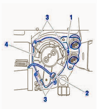

There are 2 blowers on each side:
Removing Blower / Blower Module Left-Hand Side
Preliminary Requirement - Remove the Left Hand Lower Lining:
Unclip the sound-proofing under the fascia.
Note: You may or may not need to perform all the operations listed - the complete lower left trim removal is here as it is - do what is necessary to gain access.
Remove:
Pass the hand through the key pad aperture and push the switches.
Unclip the electrical connection.
Remove:
Unclip the electrical connection:
Remove the sound insulation.
Unclip:

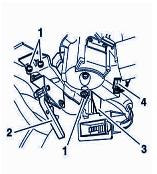

Remove:
- The mountings (1)
The hinge pillar ventilator (2)
Remove:
- The switches ( 4)
- The blanks, for access to the fixings (8)
- The cover (5)
The mountings (6) - (7) - (8) - (9)
- Lighting rheostat
- Headlamp height adjustment control
- Coded engine immobiliser keypad
- Remove the trim (10).
- Remove the mountings (1).
- Separate the bonnet release bracket ( 2).
- Remove the sound insulation support bracket ( 3).
- Unclip the electrical connection ( 4).
- Remove the blower (/).
- Remove the module.
Unclip:
- The door connection support ( 1) by pulling
- The electrical connection (2)
- The mountings (3)
- The blower unit (4)

hopefully one last question. How do you undo the large circular connectors joining the looms which obscure access to the fan?
Vic

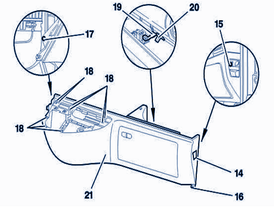

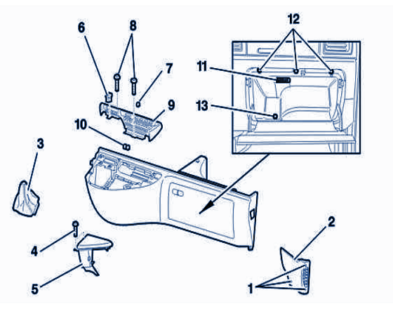

Ok so as it's on the right side you have the issue with, here is the part to remove the glovebox moulding that goes from the centre console to the right hand side if it helps:
Remove the left hand lower lining as previously described.
Remove:
Remove:
Unclip and remove the lamp ( 11).
Remove:
Remove the mountings (18).
Take out the trim to allow the gear lever to pass.
Unclip the connections from the lamp ( 19) and the switch (20).
Remove the trim (21).
Remove:
- The sound insulation under the fascia (/)
- The mountings (1)
- The hinge pillar ventilator (2)
Remove:
- The mountings (4)
- The ashtray assembly (5)
- The cigar lighter electrical connections
- The switches ( 6)
- The electrical connections on the heater panel
- The air distribution control knobs ( 7)
- The mountings (8)
- Front panel (9)
- The push buttons (10)
Remove:
- The mountings (12)
- The fixing (13)
- The cover (14)
- The mountings (15) - (16) - (17)
Refitting
Proceed in the reverse order to removal.

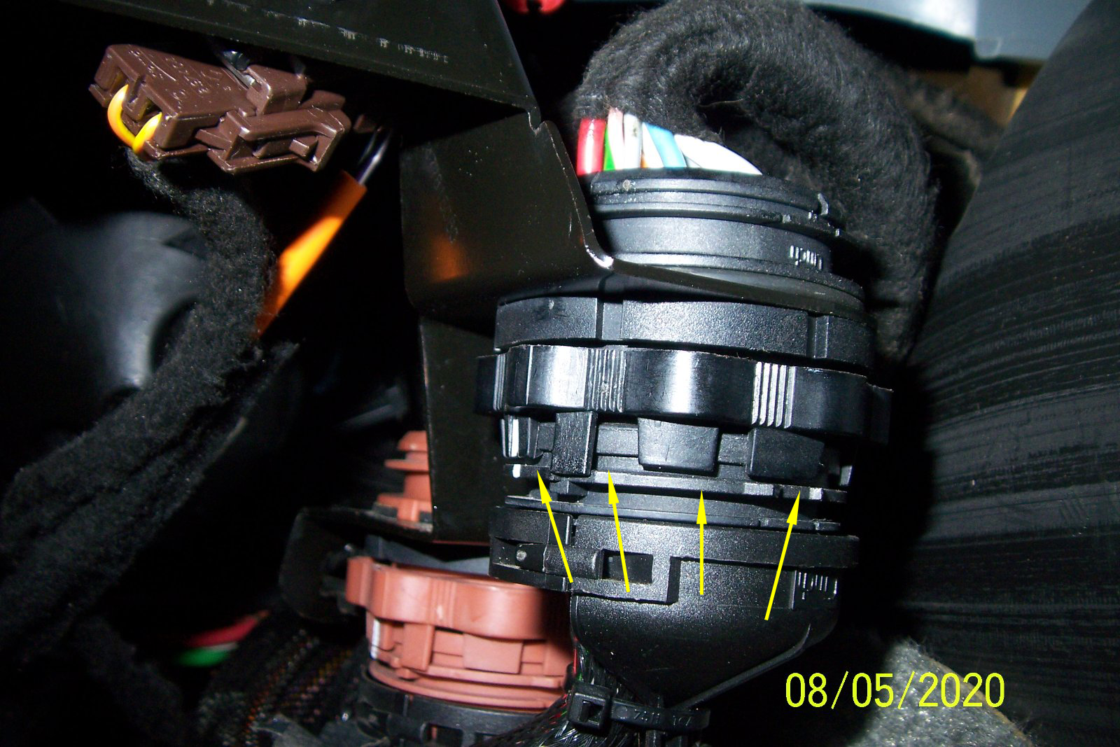

I think I will still need to split these connectors as the looms pass in front of the fan. How do they undo? Matter of interest, I've now lost practically all of the info on the km's & other screen so the problem must be a dodgy earth I've disturbed fumbling around with the wiring.
vic
vic
- x 6956
Re: faulty 'screens' on 806
Ok so with these I think you need a flat blade screw driver and need to release the lugs arrowed. That should release the circular connector.
