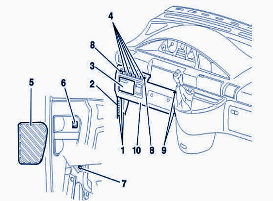

Ok, so there is no mention or requirement for removal of the glovebox Vic. The only part of the glovebox that is removable is the bottom lid. The glovebox is part of the lower trim section as far as I can see. Although the procedure to remove the blower does not require it, if you still want the lower trim fascia unit that stretches along the front that incorporates the globebox, let me know.
There are 2 blowers on each side:
Removing Blower / Blower Module Left-Hand Side
Preliminary Requirement - Remove the Left Hand Lower Lining:
Unclip the sound-proofing under the fascia.
Note: You may or may not need to perform all the operations listed - the complete lower left trim removal is here as it is - do what is necessary to gain access.
Remove:
Pass the hand through the key pad aperture and push the switches.
Unclip the electrical connection.
Remove:
Unclip the electrical connection:
Remove the sound insulation.
Unclip:
Remove:
- The mountings (1)
The hinge pillar ventilator (2)
Remove:
- The switches ( 4)
- The blanks, for access to the fixings (8)
- The cover (5)
The mountings (6) - (7) - (8) - (9)
- Lighting rheostat
- Headlamp height adjustment control
- Coded engine immobiliser keypad
- Remove the trim (10).
- Remove the mountings (1).
- Separate the bonnet release bracket ( 2).
- Remove the sound insulation support bracket ( 3).
- Unclip the electrical connection ( 4).
- Remove the blower (/).
- Remove the module.
Unclip:
- The door connection support ( 1) by pulling
- The electrical connection (2)
- The mountings (3)
- The blower unit (4)
