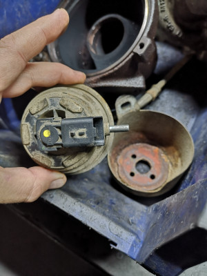

Hello, I have the same problem, all three electro valves have been changed. Connections and turbo checked but the problem is not solved. I would be glad if you have any suggestions on this. Citroen c5 2.0 hdi 163

Turbine actuator was damaged. Had to change it. Noise gone)

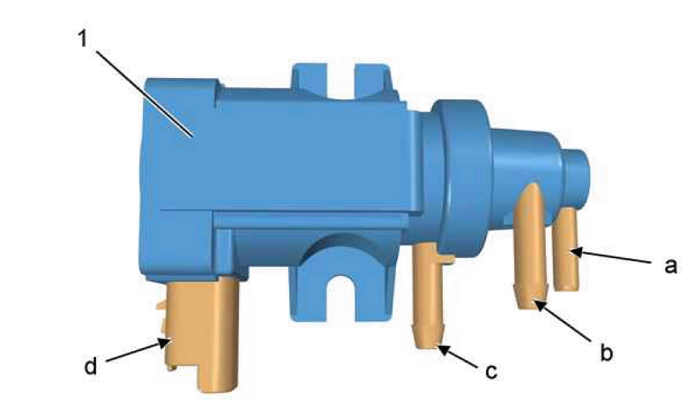

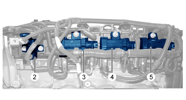

The most likely suspect is the turbo solenoid electrovalve - these have a sponge or gauze mesh filter contained in the module somewhere that can become blocked up over time. Take it off, clean the sponge out, dry it and put it back. That may restore the vacuum.
P0234: Boost pressure regulation - Air pressure above the reference value. This is a very similar fault, and points to the same suspects as the previous description.
This is where it is located - the specific electrovalve is number (4)
Here's a close up of the valve:
(4) Proportional electrovalve controlling the variable resistance turbocharger.
(5) Cold air circuit electrovalve.
(6) Hot air circuit electrovalve.
(7) Variable geometry turbocharger.
These all vary slightly in appearance - there are videos out there on taking these off and cleaning the gauze or sponge filter - depending on type.
(1) Proportional electrovalve.
"a" Vacuum inlet.
"b" Vacuum outlet.
"c" breather.
"d" 2-way black connector .
make: BITRON/PIERBURG.
The solenoid valve is a solenoid valve that is normally closed.
If you have a vacuum testing kit you can use that to check pressure - incase you need the part number, it is 9801887680 - which is for the DW10CTED4 engine. Post your VIN up and I can confirm the part number.

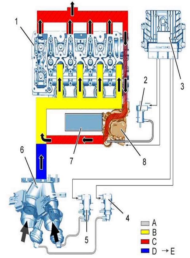

9801887680 as I have listed in the quotation is the same turbo solenoid valve used in both places in the gas recycling circuit for the hot and cold air mixing on the double air doser shown here at (4) & (5):
| Reference | Designation | Electrical diagram correspondence |
| "A" | Control vacuum | - |
| "B" | Mixture of inlet air and recycled exhaust gas | - |
| "C" | Exhaust gas | - |
| "D" | Air inlet | - |
| "E" | Electrical links | - |
| 1 | Cylinder head | - |
| 2 | Electrovalve controlling the EGR exchanger by-pass | 1253 |
| 3 | Engine ECU | 1320 |
| 4 | Electrovalve controlling the hot air mixer | 1285 |
| 5 | Electrovalve controlling the cooled air mixer | 1361 |
| 6 | Air intake double doser | - |
| 7 | Exhaust gas recycling (EGR) heat exchanger | - |
| 8 | Equipped with an EGR electric valve | 1297 |

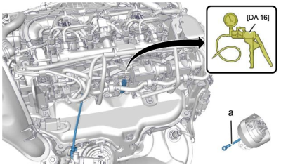

Just one issue - if you are getting fault P0234 and one ore more of the following: P1496, P1497 (which you have listed at least 2 of these) then this can indicate seizing of the turbo. There are some checks before you go changing parts but you will need a vacuum pump tool (DA16) to test this as shown:
Read the fault codes:
In the presence of one or more of the following fault code(s) P0234, P1496, P1497: Carry out check.
In the absence of these 3 fault codes: This information does not apply.

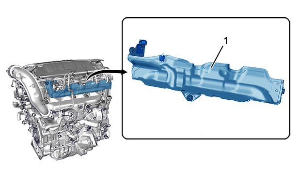

Check
Remove the heat protection (1).
(2) Electrovalve controlling the EGR exchanger by-pass.
(3) Turbocharger pressure regulation solenoid valve.
(4) Inlet air cooling solenoid valve.
(5) Inlet air mixer control electrovalve (depending on equipment).
Uncouple the turbocharger pressure regulation solenoid valve (3) pipe.
Couple the tool [DA 16] to the pipe at the turbocharger pressure regulation solenoid valve (3) outlet.
Apply a vacuum of 0,7 bar.
Visually check the movement of the control rod (6) on the turbocharger and the parameter measurements; Using a mirror and the diagnostic tool:
Replace the turbocharger.
Check
- The vacuum is reached but the control rod (6) does not move freely: Carry out repair
- The vacuum is reached, the control rod moves freely: This information does not apply
- The vacuum is not reached: Carry out in-depth fault finding

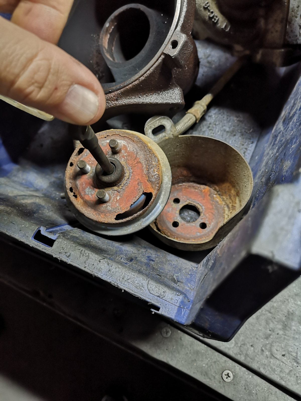

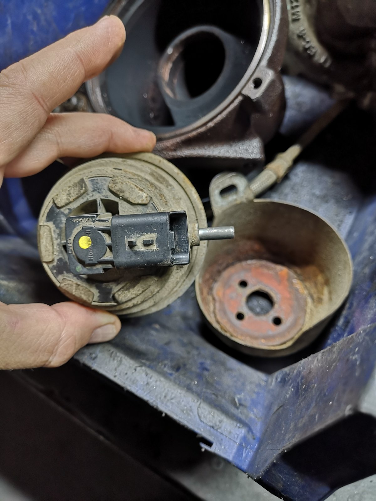

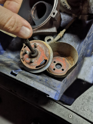

MasterYoda
- Posts: 4
- Joined: 25 Jul 2023, 11:30
Re: Peugeot 5008 2.0hdi P11AA P0234 strange turbo noise
Thank you very much!

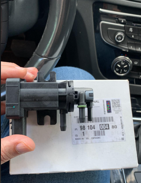

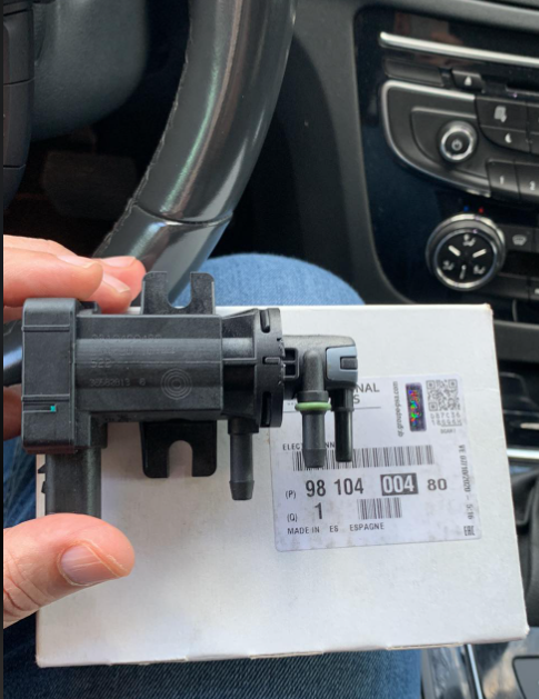

Here is the part I have used (attached to the post, luckily I kept an image of it). The dealer informed me there are 2 types of it: one long and one short (I do not understand why 2) and my part is the one from the picture.
In your opinion should I try to change the second one, the one on the left side (passenger side) if they are one and the same?
I noticed the hose that is coming from the back of the engine, on the left part, attached under the throttle flap was loose due to some oil from the manifold (a 90degrees shape rubber sealing) with oil-resistant short hose
(which works fine for now) and I think this is the moment I have started to get above mentioned codes.
I remember you mentioned somewhere there is a special bulletin regarding P0234 in correlation with P11AA, P1498, and P1497 - do you have access to this info? Can you please share it with me?
One extra Q: can you check this part 9810400480 if it is for other engines like:
Turbo Pressure Solenoid Valve Citroen C3 II DS3 Peugeot 2008 206+ 207 208 1.4 HDI 9810400480
Best regards,
Plamen
- x 6945
Plamen - please see my last post ^^^ - the information is there.
I can't advise you on the solenoid as that part number is not listed for your VIN. But as I said, before you start changing parts, you need to read my last post as these faults may point to the need for a new turbocharger depending on the outcome.
