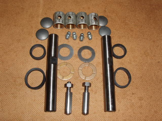

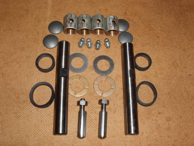

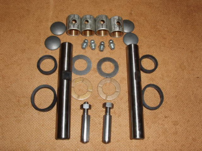

Re: Front suspension , Drive shaft rebuild, Help
Huskyxantia wrote: 13 Jul 2019, 09:29
Stickyfinger wrote: 12 Jul 2019, 18:41 I would cut that bearing with a dremel rather than press it out.
Would that work ? Anyone ever done it that way ? Something to consider especially time saving my worry would be hitting the housing to the actual carrier.
I used to spend hours upon hours trying to knock the bearings out of Imp king pins until the car parts bloke told me to cut them out with a hacksaw blade (carefully!). Saved hours of toil.
He then said not to grease them :shock:
But to oil them as they were being fitted. They lasted ages after that.

Posts: 28746
x 5675
Huskyxantia wrote: 14 Jul 2019, 20:12
Oil round bearing rollers ? Who'd a thought it
They weren't rollers but these things.
I can't remember all that stuff, just the kingpins, bearing shells and the caps. Sure there were no grease nipples involved.

myglaren wrote: 14 Jul 2019, 23:02
Looks complicated
