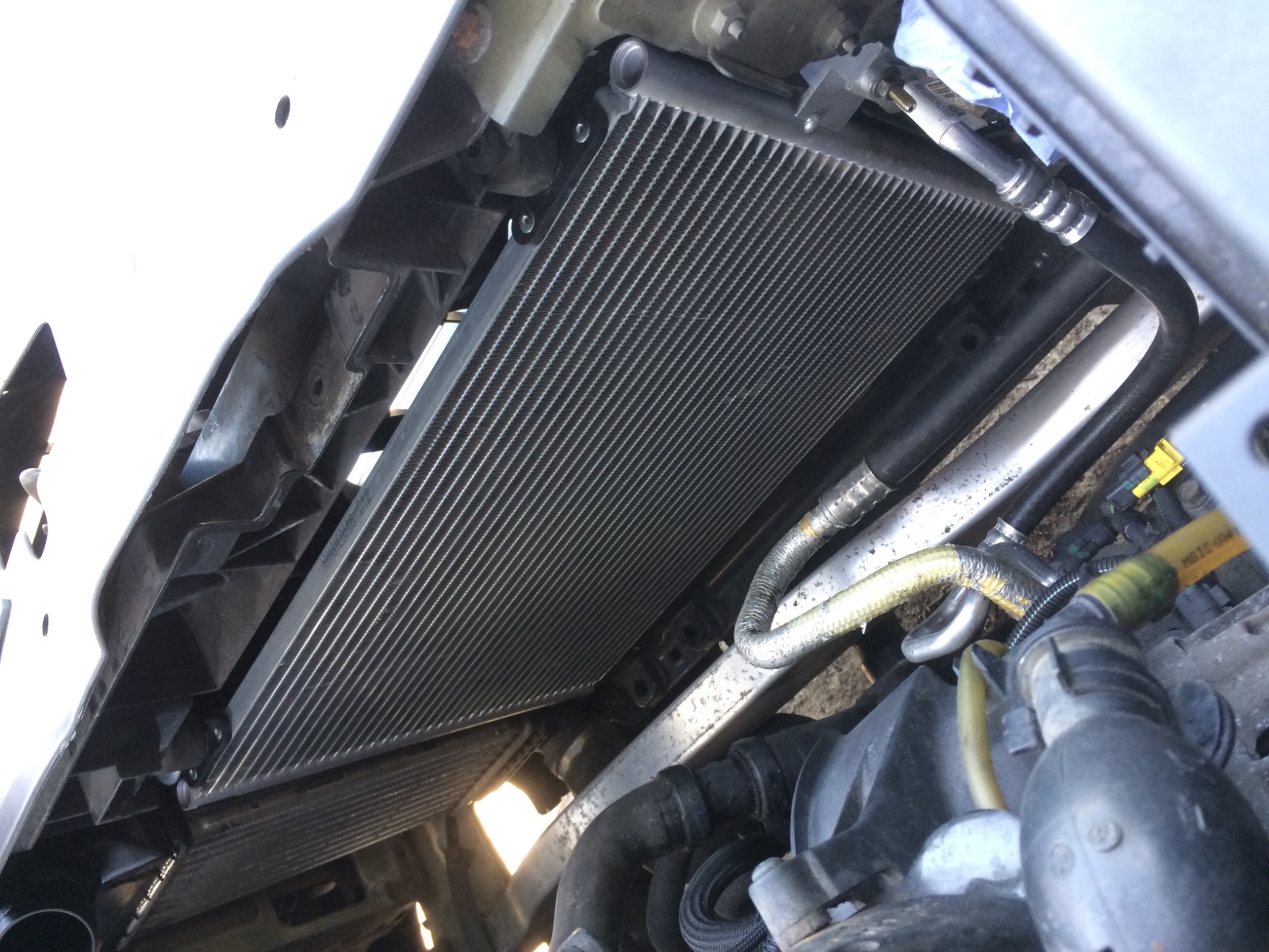

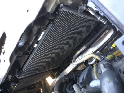

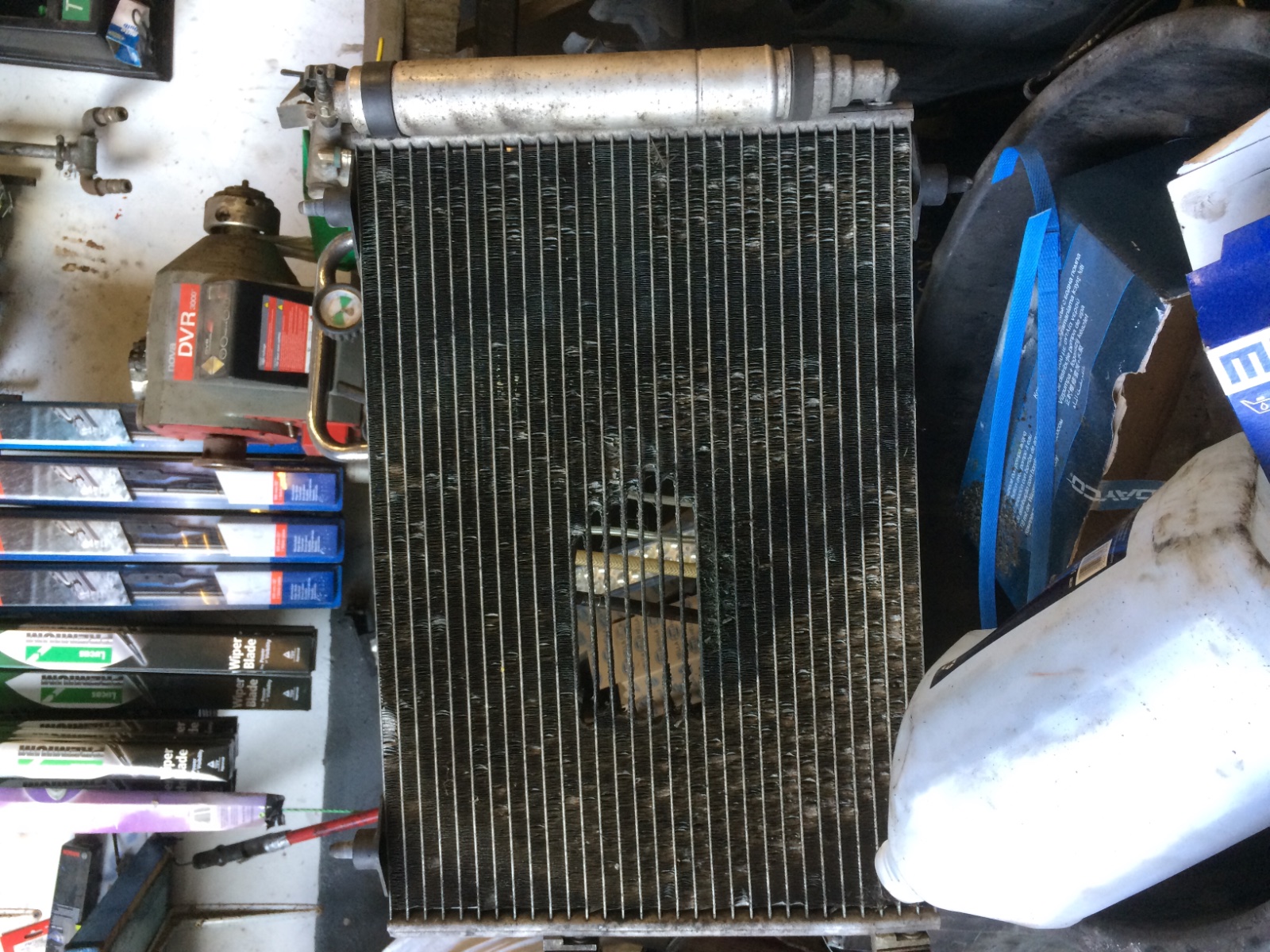

Update.
Condenser turned up from the factors and after comparing with the one removed (Valeo) it seemed a perfect fit in both form and function with no fettling required for fitting. Fitted new O rings to bottom pipe (Thanks Marc) and transferred over the pressure sensor as Citroën wanted £132 for a new one
We then vacuumed the system and the vacuum held perfectly for an hour. We then charged the system with 530 grams of R134a and fired it up. Within a minute icy cold air flowed which continued during an extended test drive.

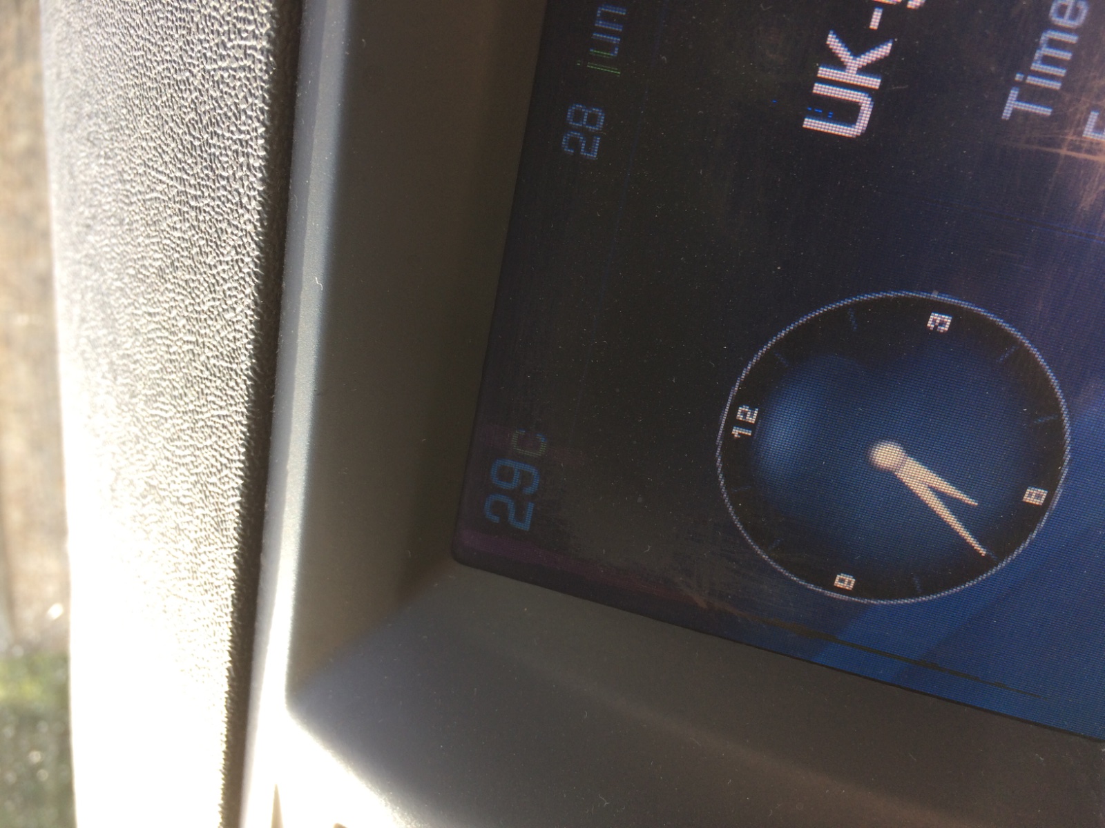

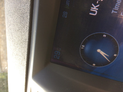

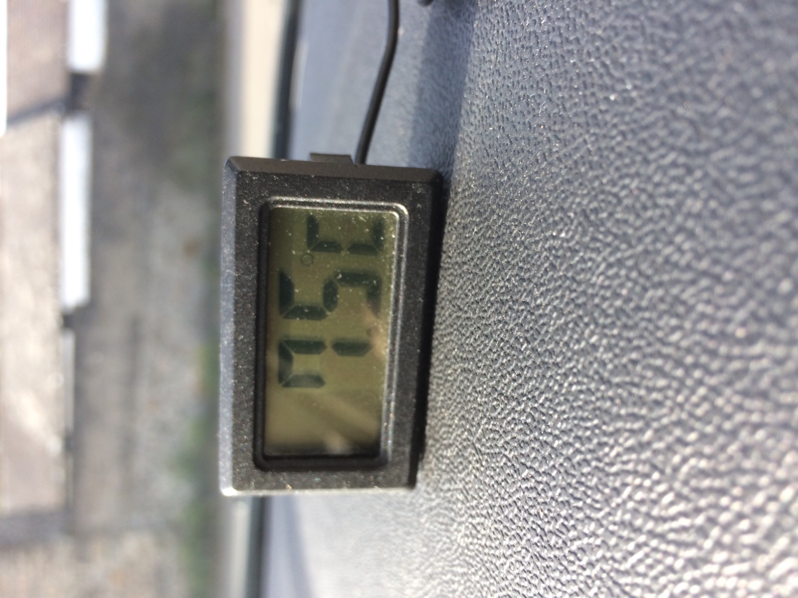

Hmmmm. It doesn’t seem as cold on 530 grams, but looking at the pictures below......
29°C outside and 7.5°C coming from the vents, a loss of 21.5°C across the evaporated. Not too shabby!
