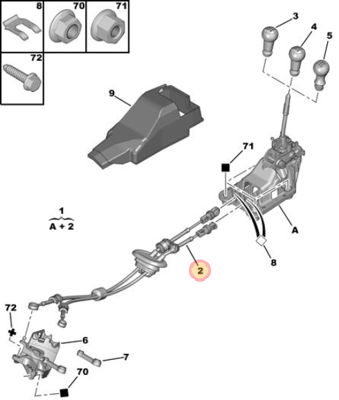

Hi all, after spending a good few hours in a carpark (albeit my favourite beachside one) waiting for a tow the other day the diagnosis is new gear cables required for my 2009 207 SW with the 1.6 hdi.
The mechanic has quoted $1000 AUD ( £530 odd) plus fitting and a 12 week wait. Given the car is 15 years old that repair is not sounding worthwhile.
He quoted part 2444CZ and I have found genuine online for $275AUD excluding freight and if I can access the members area I may well tackle it myself. https://alvadi.ee/en/kataloog/varuosa/90838604/?sv=1

(2) Gear Selection Control Cable
New OEM Original part: 2444CZ, £278.40
Cheaper PSA Alternative option, part: 1684694580, £145.56
These are obviously UK prices with our 20% VAT included.
All sorted - as you can see you are now in Green!
Ok, so back to the cables:

The alternative part, 1684694580, is that still a genuine PSA part? I’m not finding many hits when I google it.GiveMeABreak wrote: 14 Jun 2024, 12:47 Thanks for your Forum Donation.
snip
I will probably just go an aftermarket one - perhaps Borg and Beck if they are considered reasonable.

Re: Help required Identifying what 207 gear linkage cable
Yes, it's a cheaper Peugeot approved official part and is listed underneath as an alternative.
As long as you match up the OEM part or the other part I have provided, you should be fine.

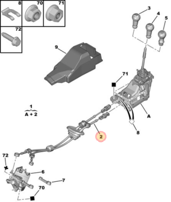

Do the cables just pop off the ball joints? I don't have the correct tool but surely it is just a piece of sturdy metal or plastic with a 10mm gap you use to lever them off? I have fashioned something to suit. Access is not great but unsure how much force to apply.GiveMeABreak wrote: 14 Jun 2024, 13:27 Here you are:
Peugeot 207 Gear Control Cables - Removal & Refitting
Thanks
2009 207 SW 1.6 hdi
1958 Series I Morris Major (my first car...)
SW Western Australia
wheeler
- Posts: 7930
- Joined: 21 Sep 2002, 19:07
- x 1055
An open ended spanner does the job of the 'special tool' just find one that is just a tiny bit bigger than the ball, slide it under & pop it off. Dont know what your one is like but some gear cables have a button on the top that needs pressed in to release it from the ball joint, normally this type just lift off without any levering when the button is pressed in.loafin_about wrote: 28 Jun 2024, 09:03
