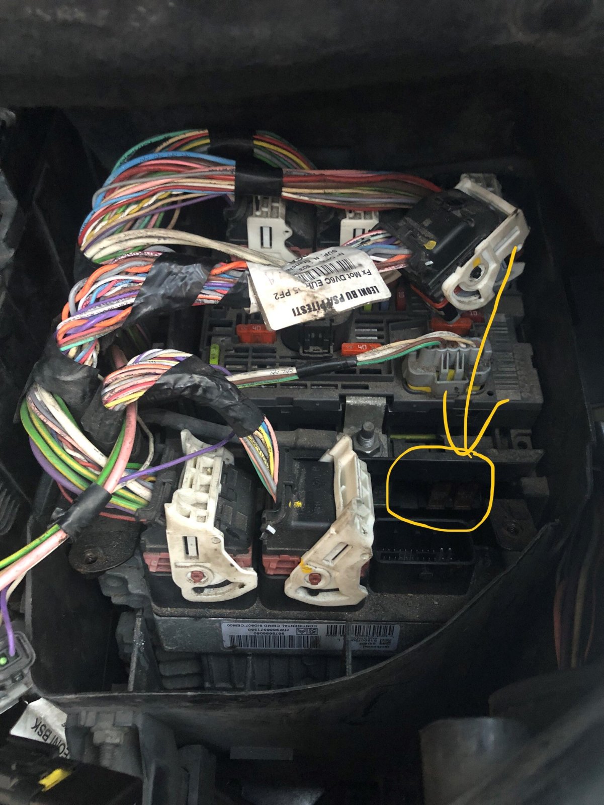

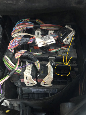

Hi, Been scouring the internet and couldn't find location of fuse for blower. found it here. Mine had blown. hoping to replace it and connect an earth to chassis to solve problem.
Need to remove the wire looms
and the box to gain access.

Hi Niall,
Can you post a pic of where you found the relay in your engine please? I've gone down the same route as everyone else it seems - blower changed (it was faulty - tested it off a separate 12V supply). Bought the resistor pack; no difference and some bizarre voltage readings coming out of it. Last few things to check are the relay. Also, is there a fuse in the engine bay? I bought the Haynes manual - very disappointed in that, as it's missing a huge amount of content. It posted a pick of the fuse in the engine bay, but completely wrong.
