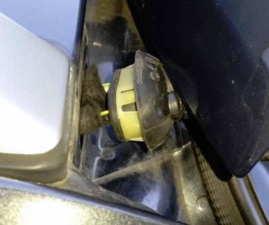

Just a thought but check the wiring in this block here:

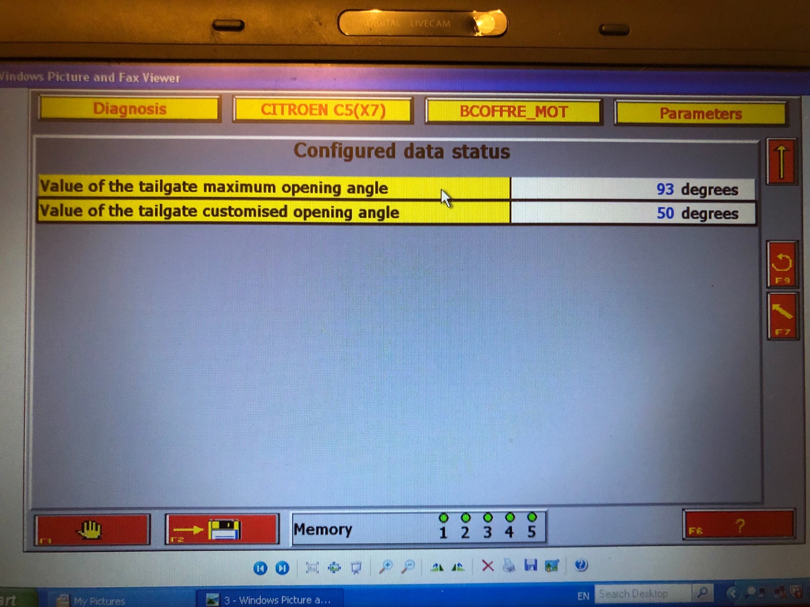

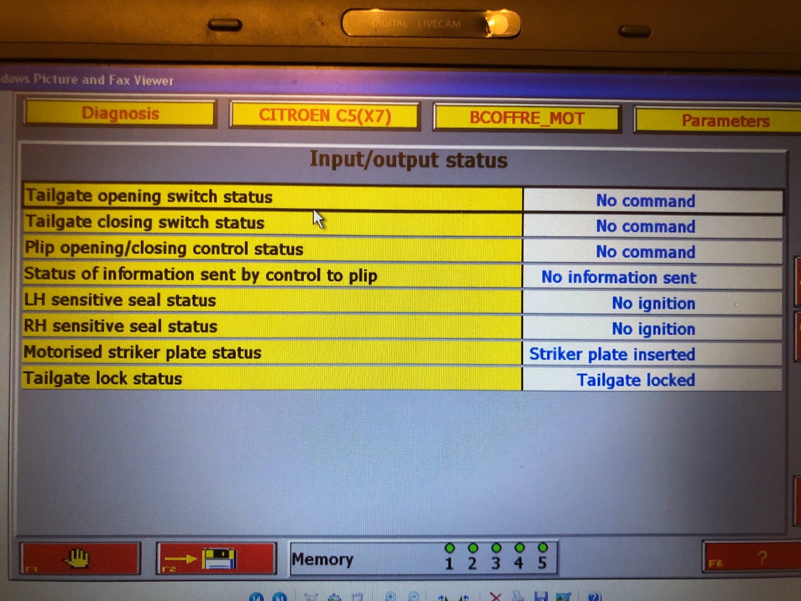

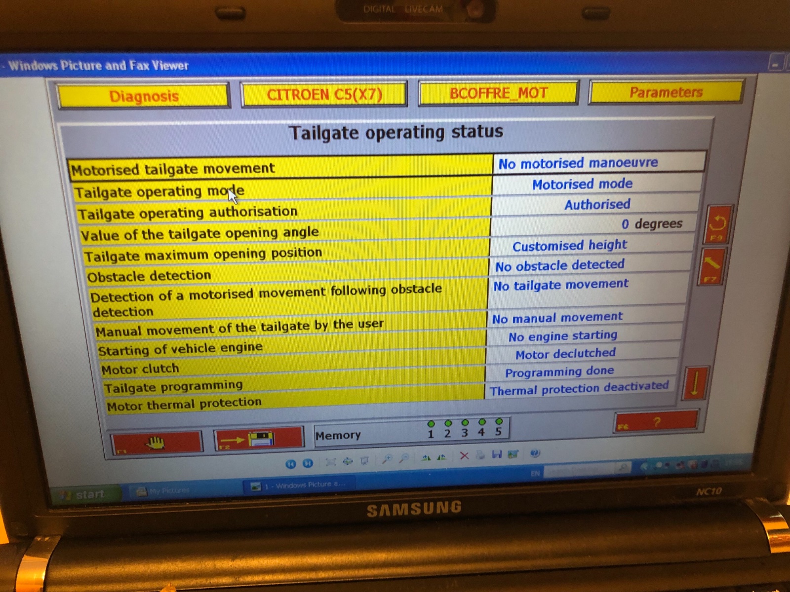

I did manage to get some screen shots from Lexia though

I know nothing about the Tourer but find this screenshot interesting...
In the first screenshot, the maximum opening angle is 93 degrees which would be wide open, why would the customised opening angle be only 50 degrees? That means the tailgate would stop half way open does it not?

- x 6945
Re: X7 electric tailgate
It's because the tailgate opening angle can be customised - but needs to be at least an angle of 50° and yes, to programme it you allow it open to the desired angle, then pause it by stopping it with the button or manually and then holding either the tailgate or the outer button in for 3 seconds, then it is programmed to your requirement - as long as at least 50°DHallworth wrote: 25 Nov 2018, 22:05
