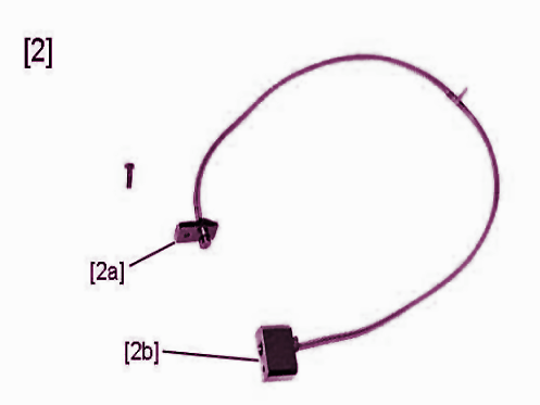

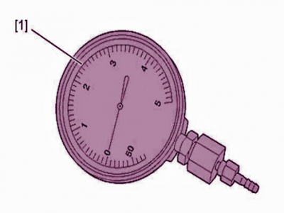

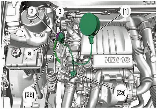

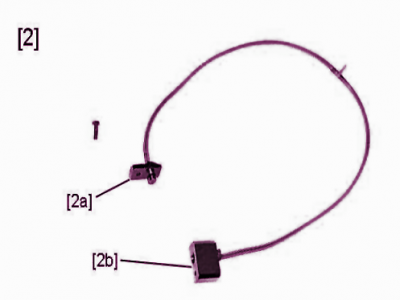

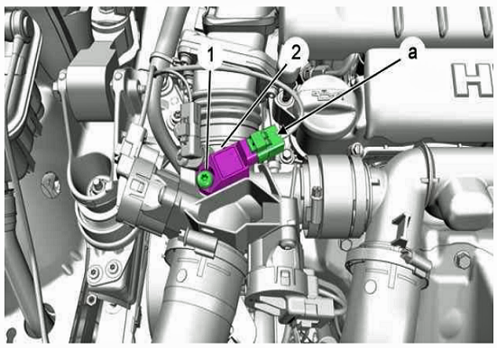

Ok so here is what I have for the P0299 Error:
As far as testing goes, you'll need some testing tools, the live data and a diagnostic additional cable as follows:
Tools:
Check
N.B. :If there is a significant difference in the pressure read on the diagnostic tool and on the pressure gauge, replace the turbocharging pressure sensor.
If the pressure taken in the circuit is lower than the value given, check the following components:
| Fault code | P0299 |
| After sales description of the fault code | Turbocharger pressure signal: Pressure too low in relation to the reference value |
| Description of the diagnostics | Difference negative for 5 seconds, between the turbo pressure reference and the measured turbo pressure: The pressure measured is lower than the reference, around 300 mbars for an engine speed above 2500 rpm |
| Conditions of activation of the diagnostics | Consult the associated contexts for the Pcode forwarding conditions In particle filter regeneration with engine speed above 1800 rpm Not in particle filter regeneration with engine speed under 1500 rpm |
| Conditions of disappearance of the fault | Driving for 5 min with several full load accelerations for 10 seconds |
| Down-grade modes if fault present | Use of the flow calculated Cutting of the EGR butterfly (turbo air cooler), EGR valve and bypass butterfly (inlet air heater) in all operating modes Cutting of cruise control Change to "easy move" torque invalid (Deactivation of automatic mode for the electronic parking brake) |
| Switching on of the warning lamp and/or warning message | - |
| Main customer complaints likely | Lack of power Noise Smoke from the exhaust |
| Suspect areas | Air meter restricted Clogged air filter Obstacle obstructing the air passage Air lock between compressor and engine Turbocharging pressure sensor Turbocharger position copy sensor Vacuum problem Variable geometry of the turbocharger jammed in the "minimum turbo" position Faulty turbocharger |
Tools:
| [1]pressure gauge for checking the turbocharging pressure (-).1604.A. | [2] Tool for checking inlet air pressure-vacuum (-).0171.G2. |
| Disconnect the connector (at "a") (if necessary). Remove:
| Connect:
| Engine speed (rpm) | Turbocharger pressure ( bar) |
| 2500 | 0,2 ± 0,1 |
| 4000 | 0,7 ± 0,1 |
- The turbocharger air inlet and outlet ducts
- The turbocharging air cooler inlet and outlet air ducts
- The turbocharger
