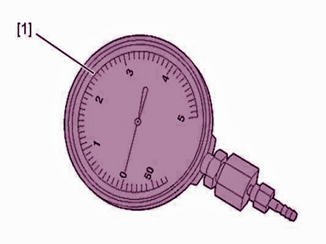

As far as testing goes, you'll need some testing tools, the live data and a diagnostic additional cable as follows:
Tools:
[1]pressure gauge for checking the turbocharging pressure (-).1604.A.[2] Tool for checking inlet air pressure-vacuum (-).0171.G2.

N.B. :If there is a significant difference in the pressure read on the diagnostic tool and on the pressure gauge, replace the turbocharging pressure sensor.
If the pressure taken in the circuit is lower than the value given, check the following components:
  • The turbocharger air inlet and outlet ducts
  • The turbocharging air cooler inlet and outlet air ducts
  • The turbocharger
If the pressure taken in the circuit (maximum 1 bar) is higher than the value given, check the turbocharger regulation system.
