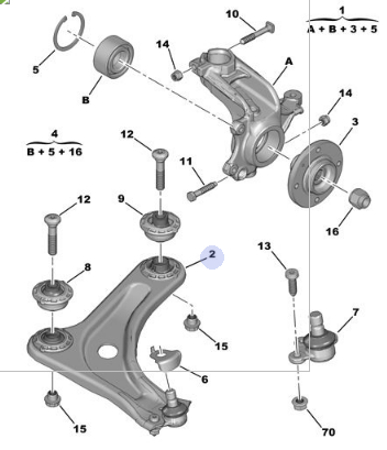

GiveMeABreak wrote: 14 Feb 2018, 12:33 In case you need the parts to cross-reference:
(4) Original FRONT HUB BEARING - PSA Part: 3350 86
(4) Over 3 years old E:WHEEL BEARING KIT PSA Part: E268570
Kit here:
http://www.ebay.co.uk/itm/MAPCO-26365-W ... SwzrxUxh2X
Or a Genuine PSA one brand new here £39:
http://www.ebay.co.uk/itm/Genuine-Peuge ... xyfyhRYADF
Thank-you so so much you really helped me out, kit you recommended is ordered. so now I know the handbrake light is the abs warning as I didn't replace bearings correct for my car. so now I ordered both front kits and all new sensors too ,you really helped if you don't mind can I ask one more question then if I have no traction control do you know what the "traction control" light is ( car in skid marks ) thank-you everyone especially you Marc

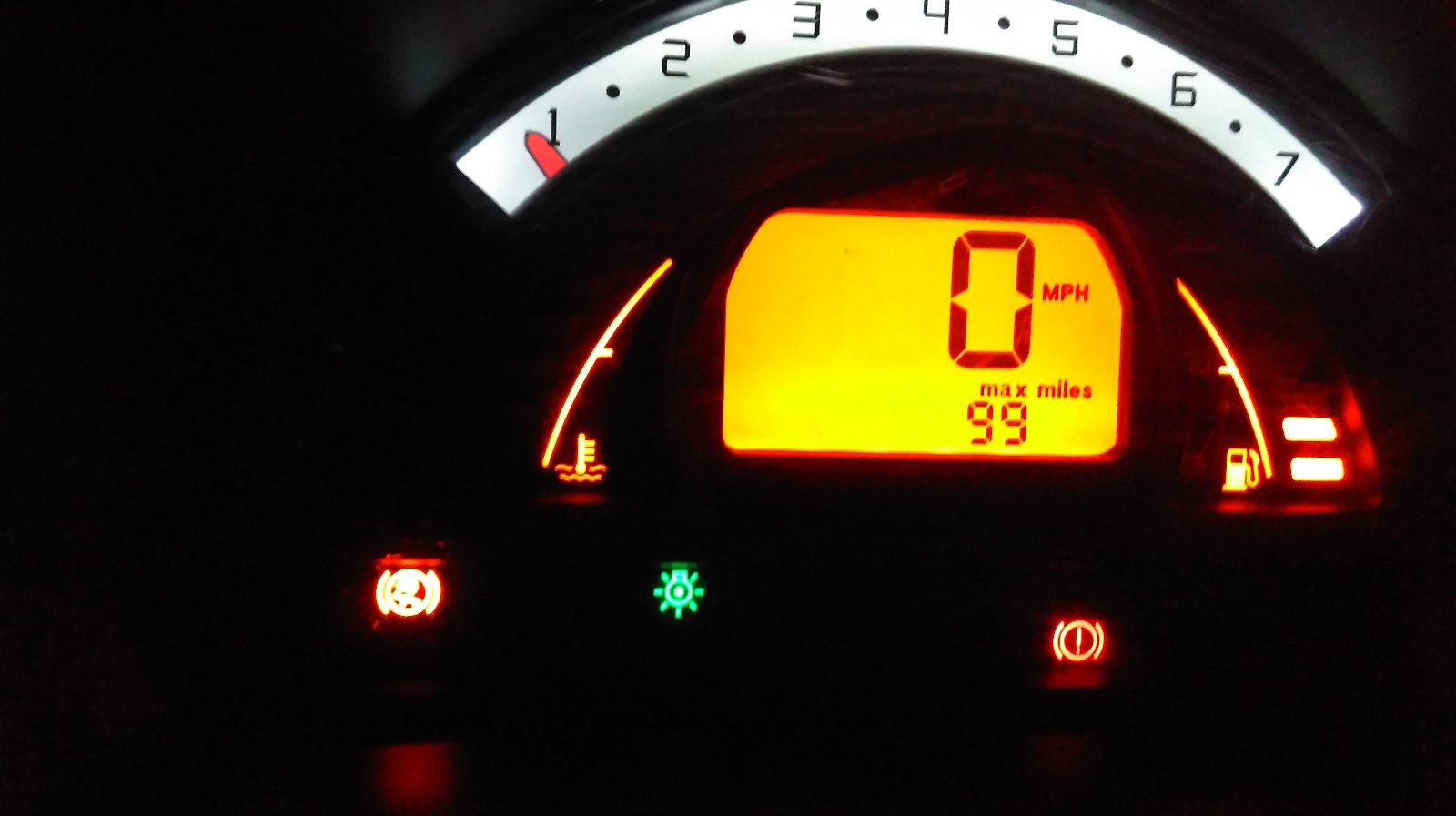

These are the two dash lights I know what the handbrake is now thanks to you but not sure on other if I have no traction control tia

Re: Handbreak light on after front barings changed
No problems, hopefully that kit will sort things out for you.
Aaahhh - I see that you have the other display (I mentioned there were 3 possible ones on one of my earlier posts). That is slightly different - here are the warning meanings. A picture really does help.
The light on the right (Red Circle with exclamation mark inside) can mean one or any of the following:
  • Brake fluid level
  • Electronic brakeforce distribution fault
  • Parking brake
The one on the left (Yellow circle with car inside) is the ABS - not the ESP. That warning means:
  • ABS Fault
The ESP light on your C2 is this one below: - but it won't be available so you shouldn't see it.
I hope that clears things up :-D

Thanks Marc so much at least I know it's all pretty much related to the fault of the wrong bearings then so hopefully with a new kit and all new sensors the problem will be sorted I'll hold off motorway driving for now then I don't want to be locking up or fish tailing.
