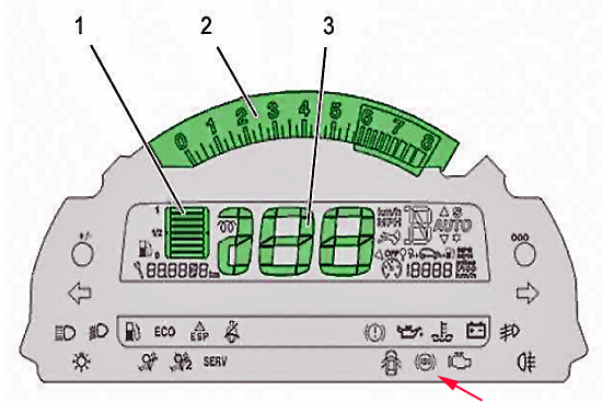

@givemeabreak which warning light doubles up as the abs light on the c2 then please would it be the traction control light (car and skid marks) as there is no abs light. If abs is the case then I think the problem could be that I specifically ordered non abs barings but still not sure why it would be the handbrake light that came on after front were changed it was fine when I did the rear ones but came on when the front were done I do appreciate your patience with a incompetent numpty like me lol

Thank-you any help,advice, or info on this will be much welcomed I'm completely stuck with this one the traction control light isn't so much a problem I just presume it's doubling up as the abs light on this so sensors are a good place to start but the the handbrake light is really throwing me
- x 6950
Re: Handbreak light on after front barings changed
Ok, now we have the VIN sorted - I can confirm no ESP system - only ABS.Webo83 wrote: 12 Feb 2018, 12:18 @givemeabreak which warning light doubles up as the abs light on the c2 then please would it be the traction control light (car and skid marks) as there is no abs light. If abs is the case then I think the problem could be that I specifically ordered non abs barings but still not sure why it would be the handbrake light that came on after front were changed it was fine when I did the rear ones but came on when the front were done I do appreciate your patience with a incompetent numpty like me lol
There are 3 types of instrument displays depending on Petrol / Sport / Diesel car.
The ABS light is shown below and I have arrowed it in red for you. Ignore the ESP light to the right of the 'ECO' - as this won't be applicable to your car - only models with ESP system fitted.

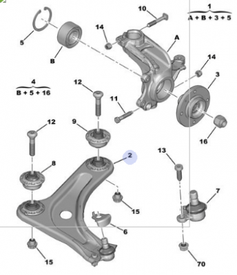

Click to Zoom Diagram So I'm still not clear on what it is you've actually ordered - when you say barings - I assume you mean 'bearings' - but that doesn't really help - if you can describe or take a picture of what it is you replaced we can check the part numbers for you.

Given that we've established it has ABS and you have fitted non-ABS bearings, then I don't think any more diagnosis is necessary
You will have to get some ABS bearings, and break out the press again. And make sure you fit them with the mag track on the right side, or you will have to do it a third time
- x 6950
In case you need the parts to cross-reference:
(4) Original FRONT HUB BEARING - PSA Part: 3350 86
(4) Over 3 years old E:WHEEL BEARING KIT PSA Part: E268570
Kit here:
http://www.ebay.co.uk/itm/MAPCO-26365-W ... SwzrxUxh2X
Or a Genuine PSA one brand new here £39:
http://www.ebay.co.uk/itm/Genuine-Peuge ... xyfyhRYADF
Kit here:
