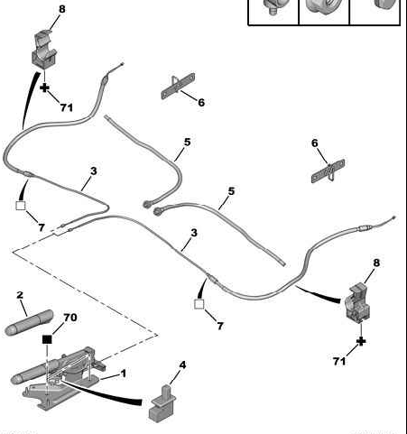

There is a handbrake switch (number 4 in the diagram) - is it possible this is faulty and gone over sensitive? It may be that going over a small bump is enough to cause the switch contacts to come on intermittently... You could try putting a little electrical contact cleaner in there or checking that the wires are secure.

On some vehicles, the handbrake warning switch requires tension from the handbrake cable to pull/push the switch into the off position, and the light will stay on if the cable is totally slack.

These C2s don't have any brake pad warning lights and the handbrake works on the rear brakes on the C2. For models on the 'C' series passenger vehicles (excluding the C15) that have the brake pad wear indicator (which operates on the front discs) - there is a dedicated warning light Van.van ordinaire wrote: 11 Feb 2018, 08:44 I know nothing of C2's but these lights usualy/often double as low pad warning lights & given the recent work that has been done, that seems the more likely are to investigate,
@ Webo83: The rears can have discs or drums depending on year / model - so we would need to know which you have if you want the handbrake adjustment guide - post up or PM your VIN.
