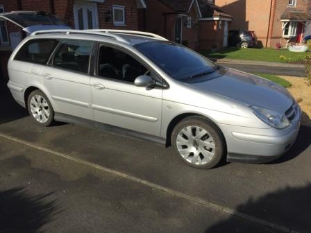

Well, the next job (boost sensor) wasn't what was actually tackled, instead I fitted the new wheels I got from Davie
I've also fitted a bluetooth kit, I had sitting spare at home...........

Those wheels go well on the c5 estate. Far better than the horrible wheeltrims that was there before. Made a big difference.

Yes, very much agreed - a vast improvementdaviemck2006 wrote:Those wheels go well on the c5 estate. Far better than the horrible wheeltrims that was there before. Made a big difference.

Looking good Steve with the new wheels on .

I actually think they look better on the c5 than any other car. I had them on the c4 vts, and on the xantia. They looked too big on the xantia if im being honest, but perfect on the c5.

Agreed on all counts Davie!daviemck2006 wrote:I actually think they look better on the c5 than any other car. I had them on the c4 vts, and on the xantia. They looked too big on the xantia if im being honest, but perfect on the c5.
