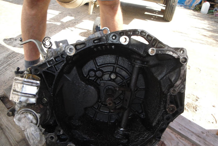

- Is it normal that the bellhousing be layered with such a layer of oily gunk?

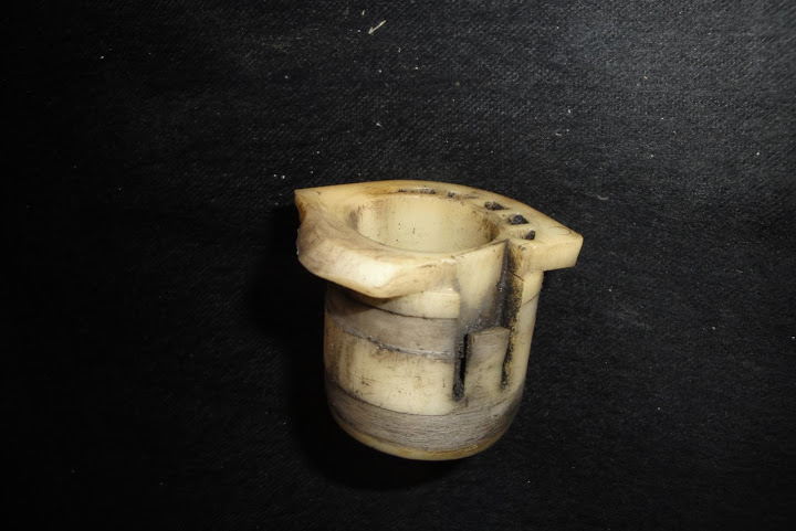

- Should I replace the clutch lever plastic end-bush whose locking clip seems to have snapped off? Can you buy these parts?

1 No - could have come from the crank seal as it's leaking or the input seal - does it smell like g/box oil?
2 Yes
3 yes
2 and 3 parts are available from the dealer, but also from ebay in the UK, and they are not dear.
2 Yes
3 yes

Yes and yes Larry.. Yes in that as you have a leaking seal the mess is to be expected and yes, replace those nylon bushes. They cost pennies and can make a difference to clutch feel..
Replace the drive shaft oil seals and the input shaft seal just in case it's that one leaking too maybe...
