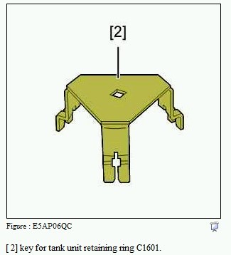

GiveMeABreak wrote: 25 Feb 2016, 23:53 In the interim - Here's the said tool in case you want to start up the forge!
Hi. Is it possible for someone to repost a picture of one of these tools, as I'm not getting that one.
I've broken about 3 lugs off so far with screwdriver or piece of wood and hammer. Time for a new idea.
Or a description. I'm thinking of some 20 mm wood across, with short pieces glued and screwed on, to rest against the vertical parts of the lugs, then something to turn it, but there may be something better, contacting more than 2.

Re: URGENT HELP NEEDED PLEASE??!!
Andy - This is one of the pics that fell victim to the Photobucket ransom - give me a minute and I'll try and resurrect it from an archive....
Edit - Picture of the Tank tool restored now.
andy5
(Donor 2022)
Posts: 434
Joined: 05 Nov 2010, 13:40
x 103
Unread post by andy5 »
Thank you.
I quite like the look of that, but paradoxically it would be easier to make at work - after the car is fixed.
I've found some adjustable ones, two slotted bars on a slider, on eBay, from £8. Wonder how hard the metal is, if it might twist on a really tough job.
Or I wondered about rolling a sheet of something into a tube, or does plastic tube go that big, cutting 12 small slots at the bottom, 2 big ones at the top for a long bar. See what's in the garage tomorrow ...
andy5
(Donor 2022)
Posts: 434
x 103
I ordered an £8.50 tool from eBay for the ring. Two partly slotted vertical bars adjustable for width in slots in the top bar. Quite thick and appears to be made of hardened metal, so no worries about twisting. Drive hole in the middle, and adaptor for ½", so used the extendable wrench for the wheel nuts.
To begin with it seemed marginal for the vertical bars to fit the ring and still be within the access hole in the bodywork, but fortunately there is just over 30 degrees of turn available at one alignment.
HDI wrote: 01 Mar 2016, 21:35 Installing it without the special tool that fits the plastic securing ring is a struggle as the pump assembly is spring loaded, so it wants to push out as you need to push down and thread the securing ring on! Took about a dozen attempts before the thread started without jumping off ...
I was glad to come back to read this to check, as I hadn't realised during removal that it is sprung, and on replacement I was worried I was trapping or bending something inside, like maybe the float stuck against a possible baffle. But no, just these springs.
Another issue is an O ring seal. It is slightly stretched in situ on the flange on top of the tank, and might roll off the lip on the flange. Mine did when I'd already lowered the pump in. I read of someone fiddling this for ages, but I had someone hold the pump so I could use two hands for the O ring. And getting the ring on the thread was fine, unlike in the quote, with one hand on the top of the assembly, other on ring.
Ran pump twice for the few seconds on start, started and running perfect straight away.
