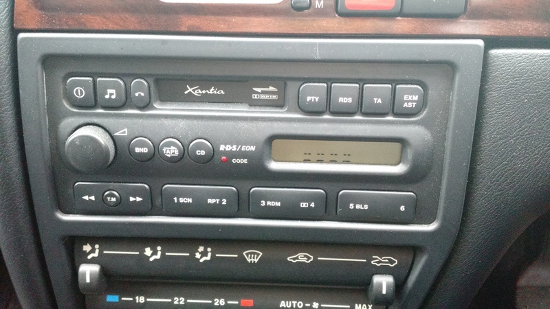

Re: I just bought today a Xantia 3.0 V6 Exclusive
Well I am puzzled! lol
Every memory button I am pressing ... it brings up the number the memory button has ... (ie memory one types number 1, memory two number 2... and so on).
The problem is the 4 digit code has a 7!!!??? How on earth am I going to type a 7?
You must have the wrong code because on that model of radio you can only enter numbers from 1-6 as it is direct entry (press the number you want) rather than each button cycling the number of a particular digit from 0-9 like the Series 1 radios.

Kent, on the radio code side, you're looking at instructions for a totally different (the S1) wireless.. There you just keep pressing the button and the number increments up for each press...
The S2 wireless is different for code entry and for the life of my I can't now recall how it's done as I've only ever done one S2 wireless in my life... Done thousands of S1 ones though...
On the S2 you hold down BND until it says code then directly enter the 4 digits by pressing buttons 1-6, which means the code cannot have digits other than 1-6.
That is correct I press the band button and it enables me to enter the code (two failed attempts and then it locks)
I am certain this is a 7 lol.... that's brilliant the car has one owner and citroen prior to that. Yet someone managed to get the manuals mixed up! LOL
That Radio and that manual are not a match. Good news about the pump though.

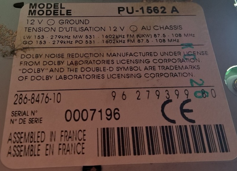

Will I need to get the serial number of the radio to get the code retrieved?
Yes, you have half a chance of getting the code online using the numbers on the back of the radio. Citroen can help you for a fee, but if the head unit isn't the original they may not be able to.
managed to take the radio out and get the serial number.
