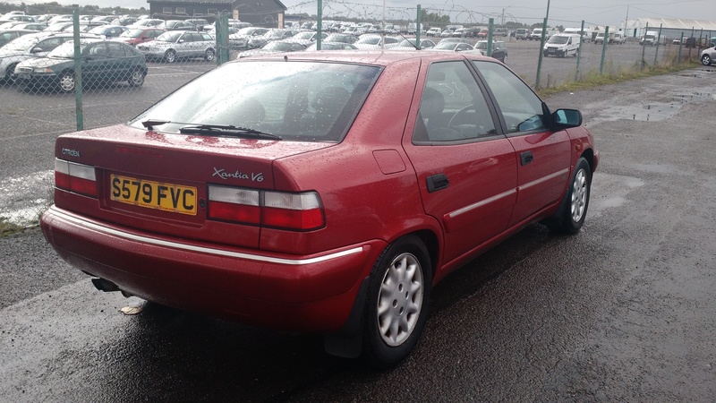

At last went to pick her up today...
The Auction would not deliver it ... as they could not get insurance due to the age of the car they said... lol
Anyway I am pleased I picked her up my self (although I had to make work arrangements and ask for favours for a lift) as I had to top up about 1lt of LHM ... it wouldn't have been good to be driven for about 120miles with low LHM.
Once on the highest settings the pump was making strange noises... a sign of now more LHM in the tank I guess... so I filled up until the orange disk was in between the lines.
I have done some Citrobics. .. but I think I might need to do this thing with the bleed screw.
The car will go to the Lowest setting
Then it will go to the Normal driving position
Then it will go to the Normal High position
And then it will go to the High position.
Dropping ...
It will not go from the High position to the Normal High position
But it will go down to the Normal position directly from the High Position
When I put the car on the High position and check the level it looks like it is above the levels... so overfilled... (but I am sure it is not...) I am certain there is an air bubble somewhere, as it was driven at High position by the auction staff... the pump was trying to suck whatever was in the tank..... air... LHM anything.
Once I filled it up the strange noises from the pump have gone.
Here are a couple of pictures... more to follow :)

Very nice, basically the V6 Exclusive twin to mine. Thought this was a car I've seen in MK before, but checking my photos showed it to be a different car, though the reg only differs by 50 or so.
Looks tidy from the photos! Are my eyes deceiving me, or have you actually managed to find a Dante Red Xantia that doesn't have serious clearcoat peeling issues? Well done if so! Get a new set of number plates on and that will help tidy it up.
Sounds like you've got pretty classic symptoms of a sticky height corrector, shouldn't be too bad a job to sort. You may be lucky and find the linkage just needs to be cleaned and lubricated properly. Ride height probably needs a tweak as well, from the photos I'd say the front is an inch or two high at the moment, though that may well resolve itself when the height corrector is freed off.
I know it's been said before, but want to echo the warnings that the car *must* be properly secured on axle stands before you even think about going underneath it - irrespective of whether you're touching the suspension system.
