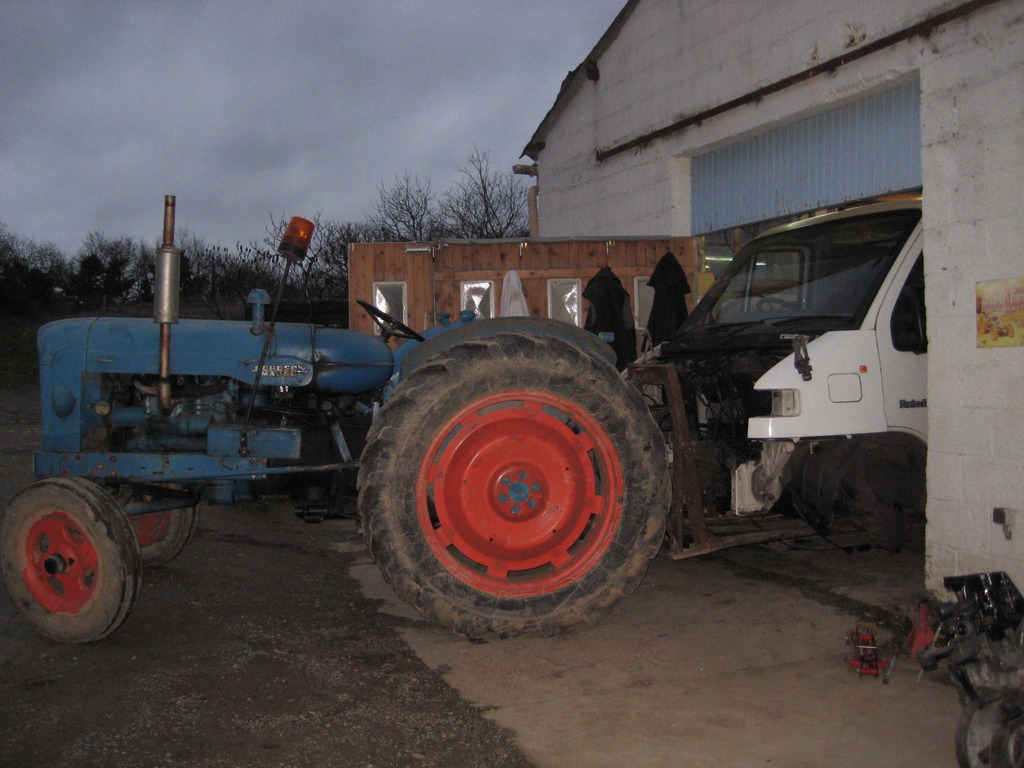

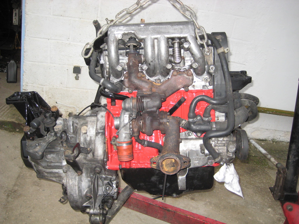

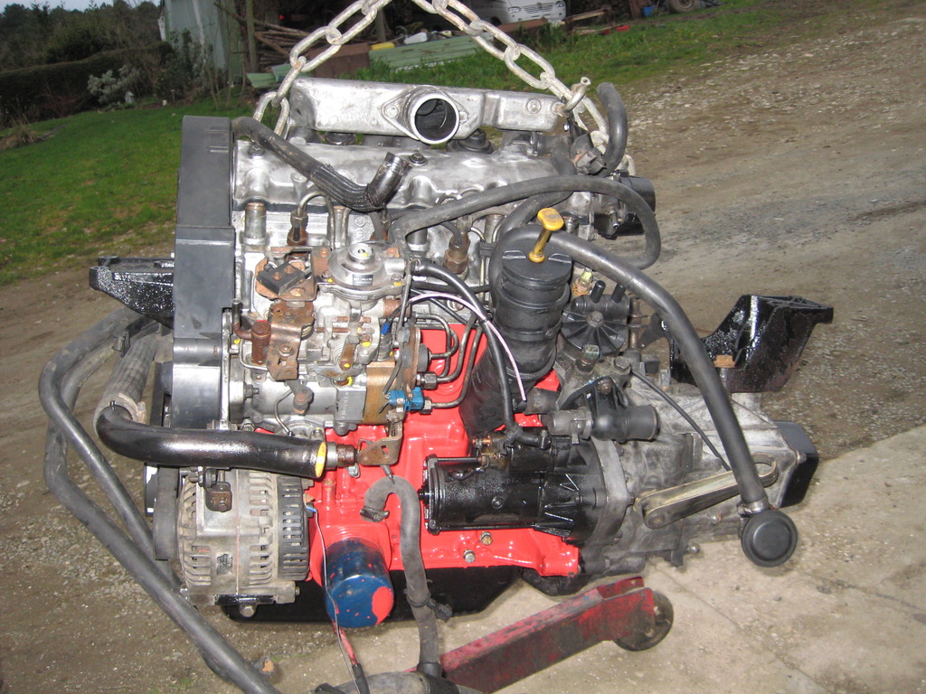

Engine and gearbox finally prepared to go IN
After taking van out of garage and powerwashing engine bay -- no --- don't think they will allow us on the road like this -- discover that IN is not ready to engine.
Rot in both front inner wings - under battery tray and under air filter - time to get the welder out
