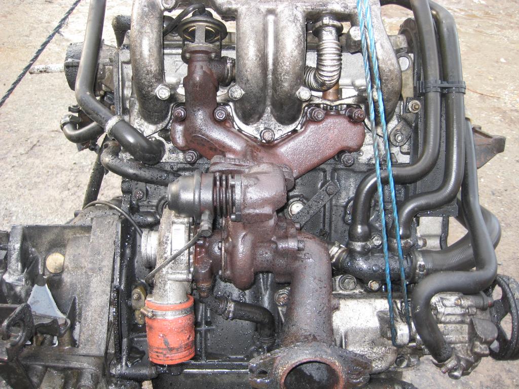

Here is a photo of the turbo. It is a KKK K14.
The impellor on the turbo turns nicely, and has no play.
Whats the story with the wastegate on these - we are not familiar with them.

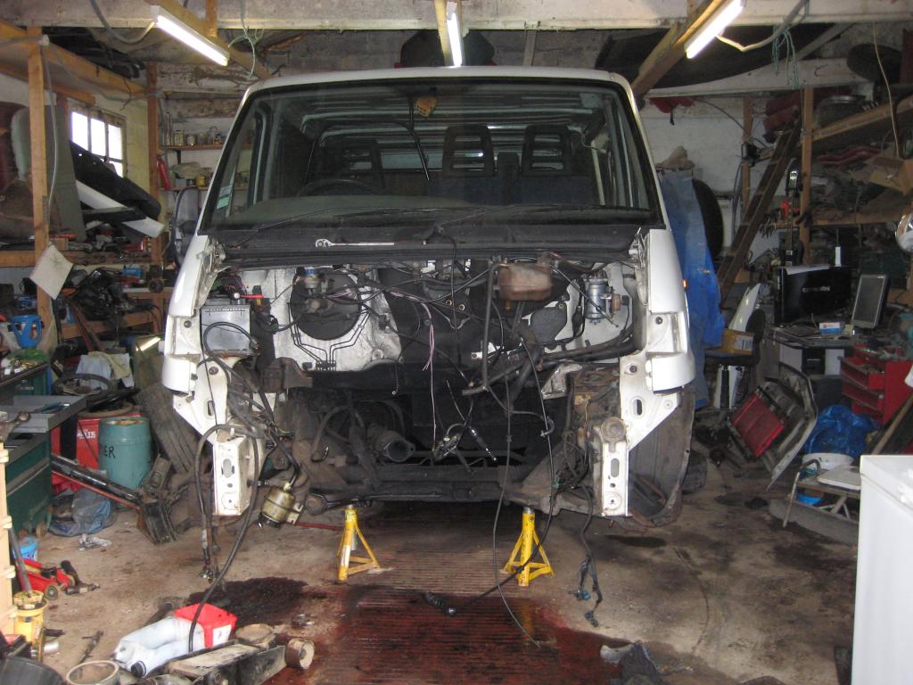

Here is a picture of the van at the moment. Not sure we will remember how to put everything back together !!!!

Wastegate (and turbo + exhaust manifold) is of a sort I've never seen before on an XUD...
The EGR valve looks odd too. As if it's stuck wide open or has been gutted...

Yeh you're right I can't see a return spring on that EGR now you mention it! Wonder if that was at least part of the issue, failed/bodged EGR letting all the boost escape back through the exhaust causing low power & overfuelling?
Also got to admit I've never seen a wastegate/actuator like that in my life, looks rather cumbersome/messy to me.

I think it stands a good chance of being a prime suspect! It could certainly give rise to the issues it has...ekjdm14 wrote:Yeh you're right I can't see a return spring on that EGR now you mention it! Wonder if that was at least part of the issue, failed/bodged EGR letting all the boost escape back through the exhaust causing low power & overfuelling?
