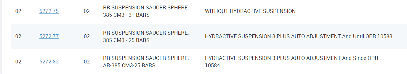

Thank you for the analysis.
As per my understanding HA3 and Non-Hydractive (A pre C5 era terminology) are one and the same thing: both mean two sphere on each axle without a central sphere.
HA3+ means having a central sphere in addition to the two side spheres which was also called Hydractive (in pre C5 Cars)
Based on the OEM references I can see here: tinyurl.com/5beak83k
The Hydractive 3 rear has the 31 bar listed sphere.
The Hydractive 3+ rear has a 25 bar listed sphere.
I have noticed that some aftermarket sphere manufacturers supply the same 31 bar for both HA3 and HA3+ to reduce inventory but that is not the OEM specs. Even if you check the IFHS catalogue there are two different 25 and 31 bar spheres for the two versions. (https://shate-m.by/static/Catalogs/IFHS ... _11_LR.pdf)
However what intrigues me is that Xantia non-hydractive also has 30 bars specified with a larger volume of sphere. The C5 being a heavier car and a smaller sphere volume, should the ideal pressure not have been higher! Which is why I was toying with the idea of a 44 bar Estate sphere. But yes a too high pressure can actually make the ride harder, the best is to find the equilibrium point where the diagphragm remains flat where the weight of the car exerting the pressure on the fluid exactly counterbalances the pressure in the sphere. But hard to tell without any real life tests/experiences!

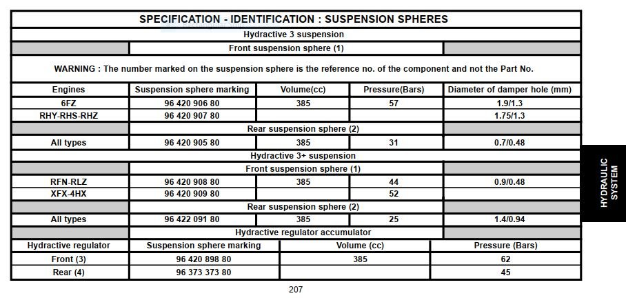

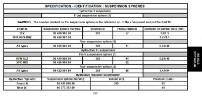

Aneesh, my apologies. The name change with Hydractive 3 caught me out - you are right HA3 is effectively the 4-sphere system from BX etc., and HA3 is a development of Hydractive 2 (with its centre spheres). :oops:
This is the table of spheres listed by Citroen (Private Cars 050011, 2002, C5 & C8)
? Click to enlarge
The C5 booklet for year 2000 shows the rear HA3 spheres as 25 bar pressure, but that low figure got changed to 31 in later years, presumably to provide a softer ride.
Damping?
We did ask the question here (some time ago) what the TWO damping figures in the last column actually mean.
The classic round spheres have only one figure listed.
I don't remember that twin figure being explained.
If you needed to experiment, it would (space permitting) be possible to fit some classic spheres.
Non-Hydractive XM, for example (not dissimilar bulk to C5), had for its rear end 400/30/1.2 spheres.
The advantage of the classic spheres is that they can be re-gassed, or gassed to a chosen pressure (if you fit Valprex valves).
The firmer ride on C5 is partly design, but also partly due to the reduced sphere volume of 385cc.

white exec wrote: 07 Jul 2021, 13:39
? Click to enlarge
Damping?
Seems strange that the damper hold for Hydractive 3 side spheres is smaller than Hydractive 3+ side spheres. No wonder it would give a hard ride. Seems like Citroen screwed up somewhere :-)
I really need to get a confirmation from a Hydractive 3 Mk1 or Mk2 C5 owner if the ride was ever good enough on original spheres!

No those are incorrect! Those are for Hydractive 3+, you don't have this system on your C5 - yours is just H3, so no centre spheres.
The rears are 385 CM3 - 31 BARS and specifically the H3 spheres only Aneesh.
