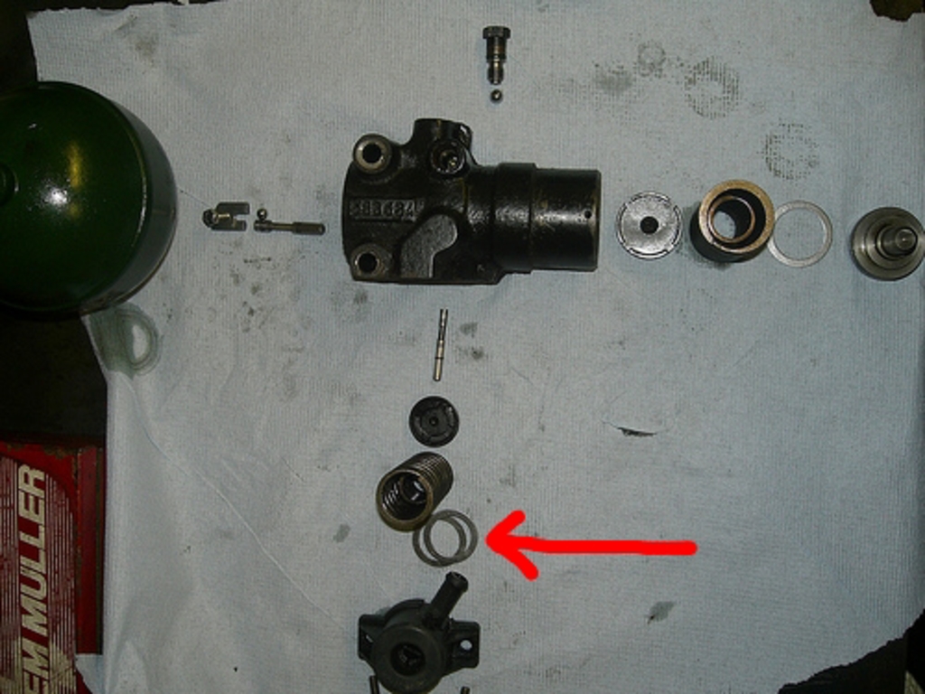

I have purchased a Xantia estate, getting it next week, and saved it from the breakers, due to a leak from the pressure regulator. I normally used to change these, but they are getting pricey.
Anyone know the part no of the seal kit , to fix it, the repair looks simple, as I can use the press to strip it.

Deanxm and the rest who have posted here, THANKYOU sooo much
. This really helped me.
Just wanted to add, if you don't have a big vice you can, with some care, use a cheap F clamp (less than $7.00). I didn't want to remove the sphere as I had only recently changed it, so got a 400mm F clamp
Worked a treat and no more green blood on the garage floor

So do I get a prize for the longest time taken to repair something/ laziest person?! Finally got round to fixing the regulator leak after 2 years! Whee!
Big thanks to deanxm for piccys, was very straightforward.

Heya, great work, nice detail and very useful!citroenxm wrote:Ah ha.. My dealer could not find an exploded diagram of the regulator...
Does anyone know the part no for the one that sits in the plastic return part at the bottom of the regulator.... ??? I need a few of these too.....???
Thanks
paul
So for the bottom seal that goes in the plastic bit in the bottom, did anyone get sizes/part numbers in the end for that?
(are these two parts the seals for the the bottom plastic bit of that pressure regulator?)
Many thanks, romie

Fantastic, only do you know the size of the o ring that you used from that pack?Deanxm wrote:Here you go Paul cheaper than anything you will find at the dealer and always to hand
Having said that my set didnt have a seal that would fit the bottom plug of the reguylator as that is rather chunky but there are ones that can be used in place of the one used on the plastic return housing, the original i flat like a sphere seal but an o ring works a treat, especialy when you cant get the original and you have a leak.
D
Many thanks if you can figure that out.
And just to confirm the procedure, I just need to:
Lower, depressurise, remove plastic bit (being careful due to spring), insert new seals, screw plastic bit back up against spring, and job done?
I see the end cap seal is more work.
The pressure regulator is leaking in both the end seal where its bracket is mounted and it's also leaking between the plastic bit and the main body.
I'll be checking this post out in detail for the end seal change!
Cheers, romie
