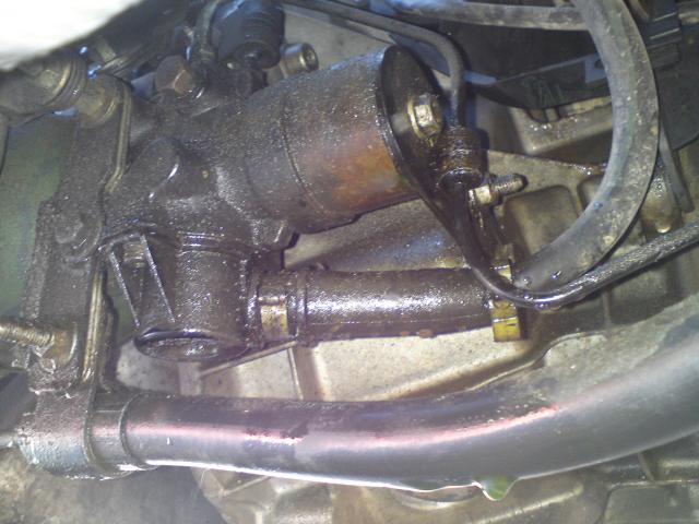

Hello, was out this morning changing engine oil and antifreeze when I noticed a LHM puddle. It's leaking from the accumulator housing right at the end of a cylinder, there's a 11mm pipe coming out of it. Not sure how to post a picture on here. Is there a seal? This is the 3rd leak now. Sigh.

Without seeing a picture, I'm guessing this is from the extreme end of the cylinder where a round plate bolts on to secure the end of the cylinder to the gearbox.
If so, there's an O ring under here that goes. Bit of a 'mare to replace it though as you have to compress a big spring in the cylinder and remove a C clip in so that the cylinder end-plug can be removed to replace the O ring around it.
Normally best to let Mr. Pleiades attempt this repair...

Ive resized it for you Jaf. Please keep image size to no more than 640x480 for ease of viewing. Your original was HUUUUGEEE
That fairly certainly confirms my guess from my original reply.

Thanks again. Saw that my pic was bigger than heathrow airport so removed it and added a thumbnail but I was too slow and you'd already sorted it.
Any idea what I should call the cylinder bit? Might have a look at a second hand one as Peterborough is a bit far from here. Posting it to be fixed would take ages and I can't be without the car. I know that driving with leaky LHM is dangerous so I'm in a bit of trouble!

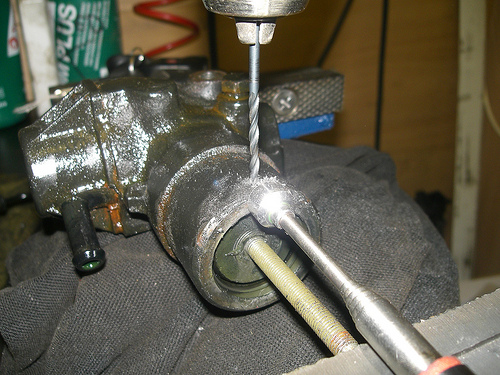

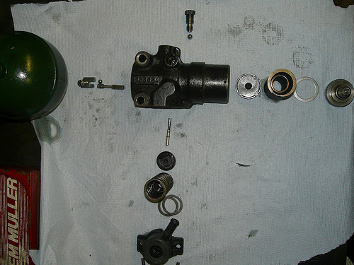

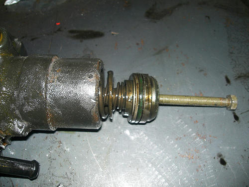

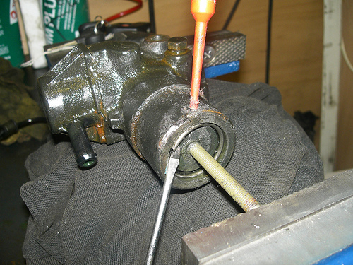

Its an easy job to do, just depressurise the supply system by undoing the 12mm bolt 1 turn, then remove the regulator and if you have a big vice you can do this
CIMG3059 by Deanxm, on Flickr
CIMG3060 by Deanxm, on Flickr
CIMG3061 by Deanxm, on Flickr
CIMG3064 by Deanxm, on Flickr
Hope this is of help, it really is easy if you are just replacing the 'o' rings, the valve is only 2 shuttle valves that ballance hydraulic pressure with spring pressure, nothing fancy and you will only take the end bung out anyway.
D

You can call the cylinder bit as Pressure Regulator and looking at the picture it's the end seal as Jim already said
Edit: Great pic story

A few important notes.
1. always lubricate new seals before instalation
2. if you are not taking the whole valve apart make sure it is perfectly clean before you open anything up.
3.make sure rust asnt got onto the seat of the 'o' ring and caused the leak, if it has give it a gentle rub over with some emory cloth to remove it.
D
D
