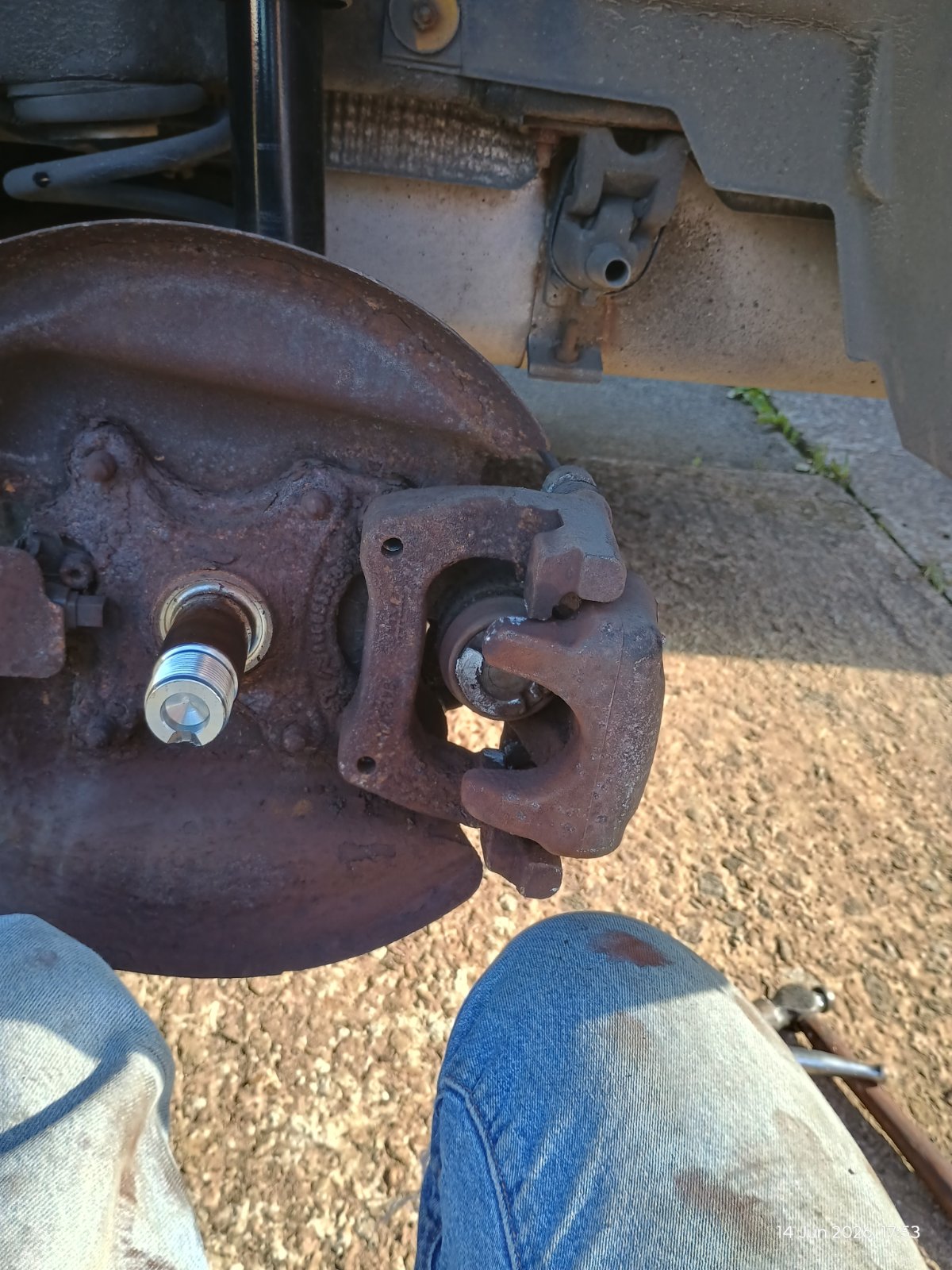

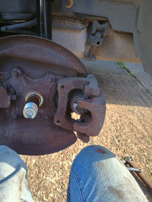

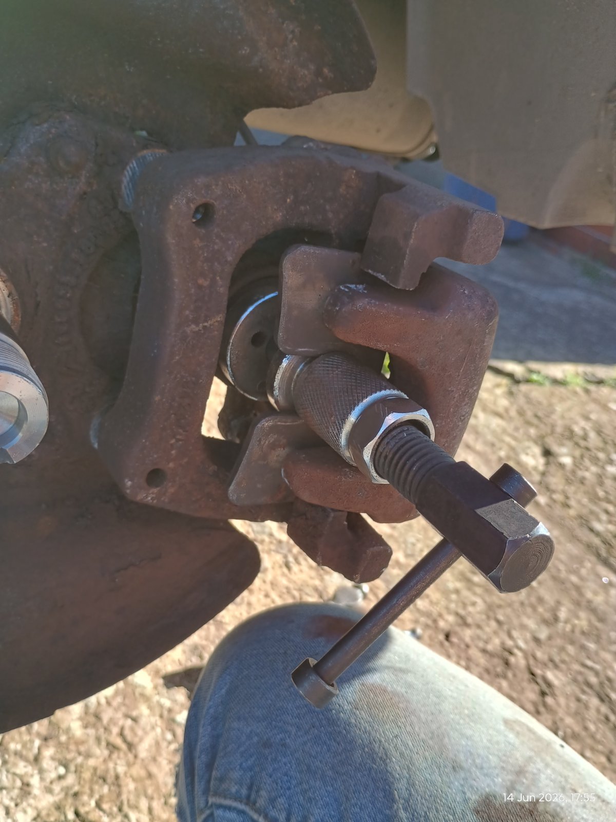

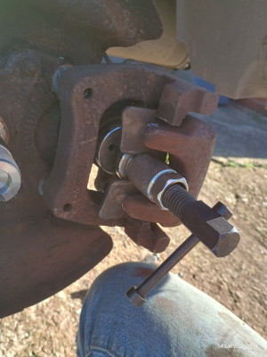

Left rear brake job completed:
Wind back tool with caliper mounted without disk
Winding back
Winding back
Hub nut 36mm, 300 Nm
Caliper carrier and guide pin bolts both 30 Nm then 35° angle tightened says Haynes (also states both are single use)
Reused but fresh thread lock compound.

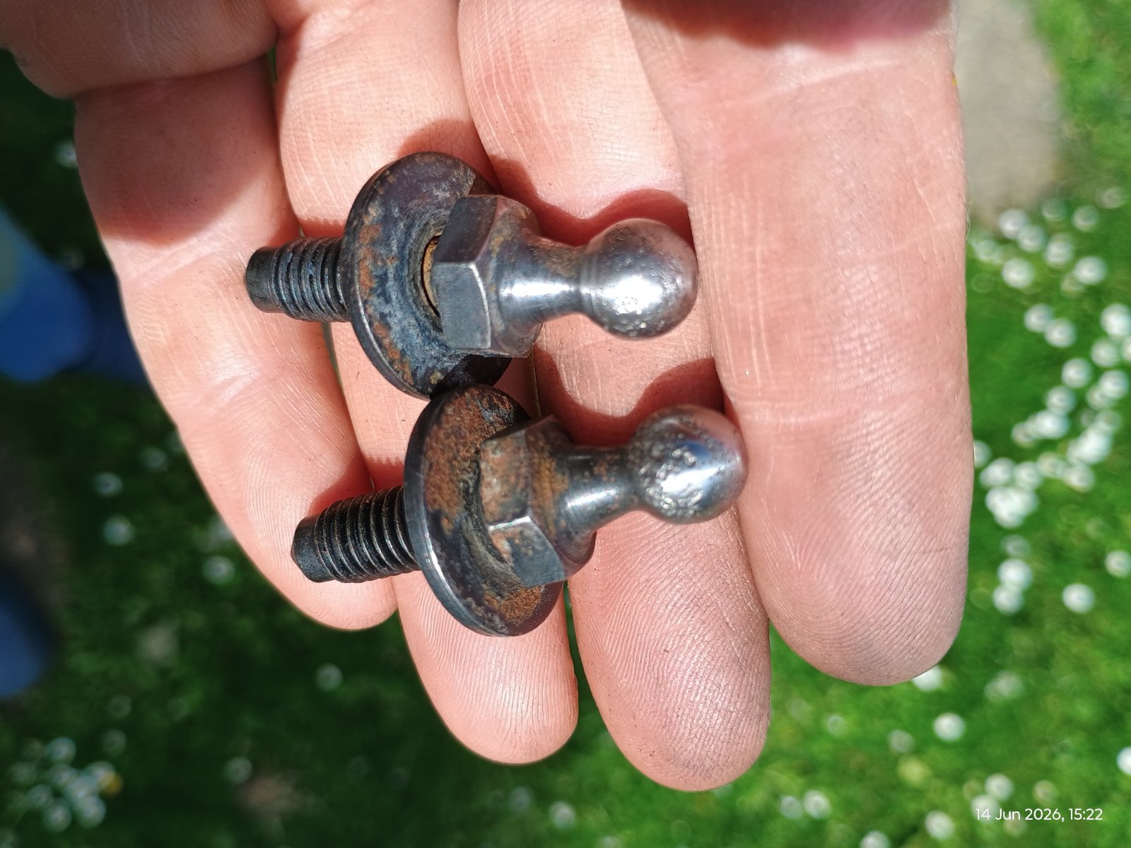

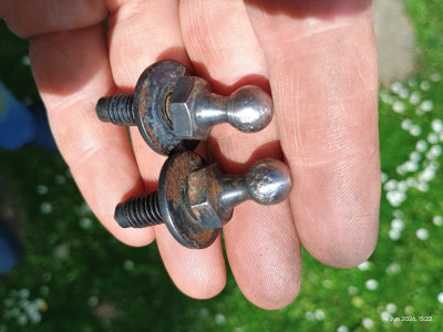

Rear boot struts swapped. Boot end strut ball joints found to be corroded and severe pitting.
Cleaned up best I can, but still medium horrible
Plenty of red rubber grease.
Hoping for a none creaky boot when off to the office tomorrow morning!

Boot gas strut bolts, possibly 9811552380
£40, each!?!?!?!
https://ebay.io/m/1WwTvq
Errrrrrrr I'll keep looking! :)

I suppose counts as "cheaper", £16 each
https://ebay.io/m/INTscX
Still looking!
Posts: 21182
x 8125
These people offer both M6 and M8 sizes, any good? :)

MattBLancs wrote: 15 Jun 2026, 06:29 I suppose counts as "cheaper", £16 each
Still looking!
The ball head looks smaller

Thanks Husky, I think I'm going to seek out (non-genuine!) new ones as the second hand ones may all be suffering from the same corrosion issues.
I'll pop a strut joint off again at time point and err, see how big my balls are :lol: =; then see if I can find some generic ones that'd fit.
For the moment the boot is no longer graunching so the clean up and plenty of red rubber grease has bought me some time.

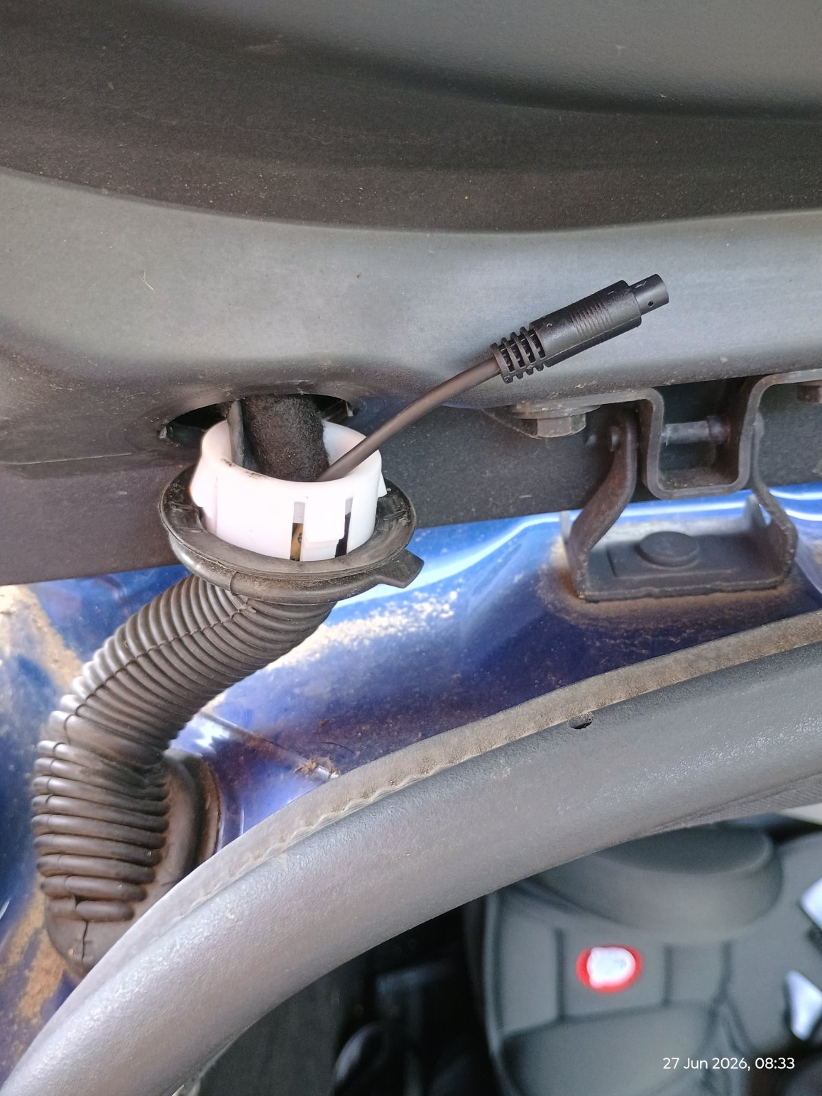

  • Fitted my (birthday present) dash cams to the blue 308 with company and help from my eldest,
    Rear camera cable routed through cable rubber duct
