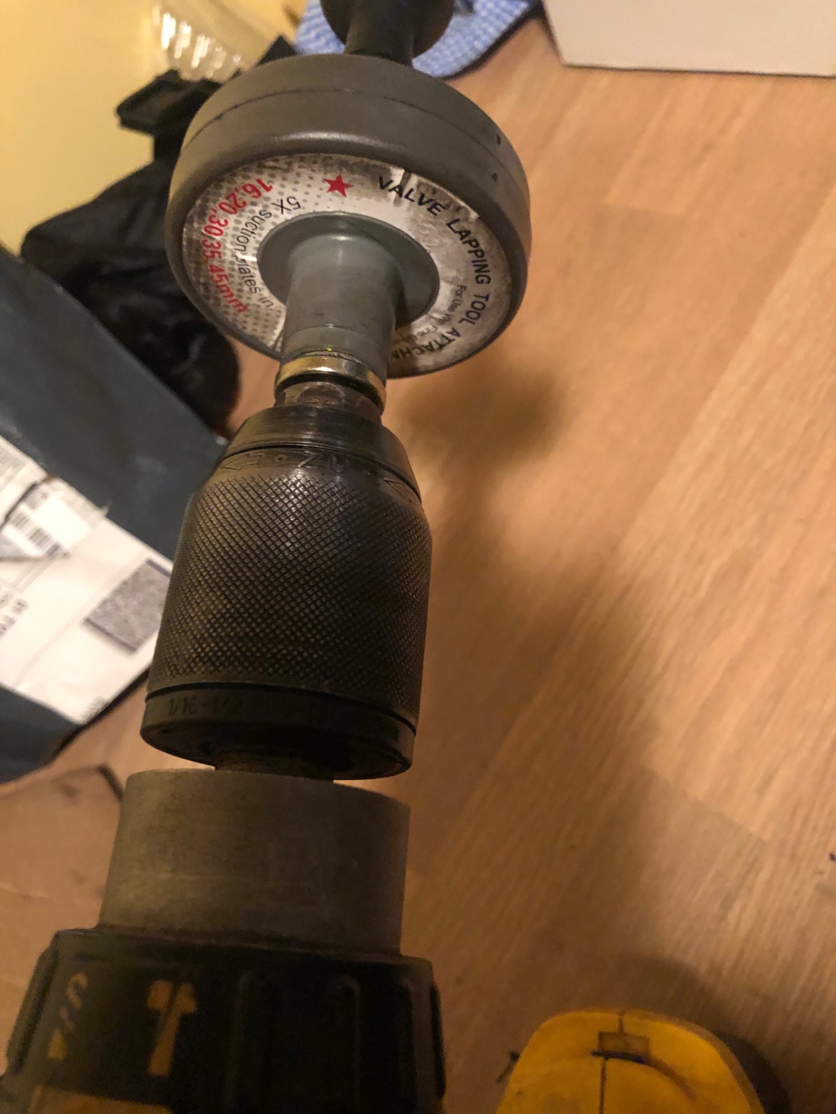

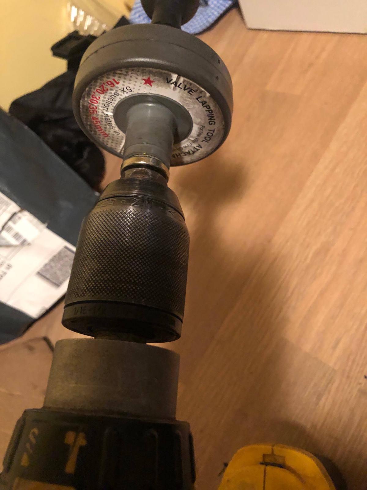

I'm attempting to lap them in and clean up the ports a bit but the new lapping drill attachment doesn't seem to be doing much lapping
The valves are loose at the minute, tiniest of movement but I expect that's because they aren't under spring tension

The valve lapping tool is poo(r) ...I remember better *suckers playing cowboys and indians when I was a kid

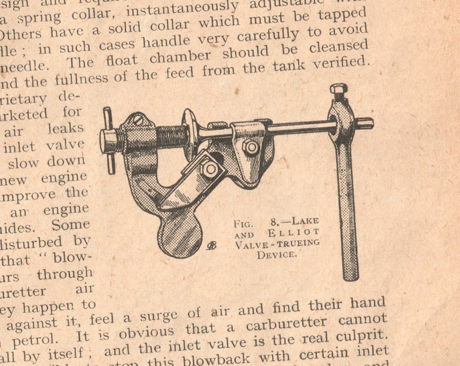

Here's what you need Gary:
From a 1920s motorcycle book I have...

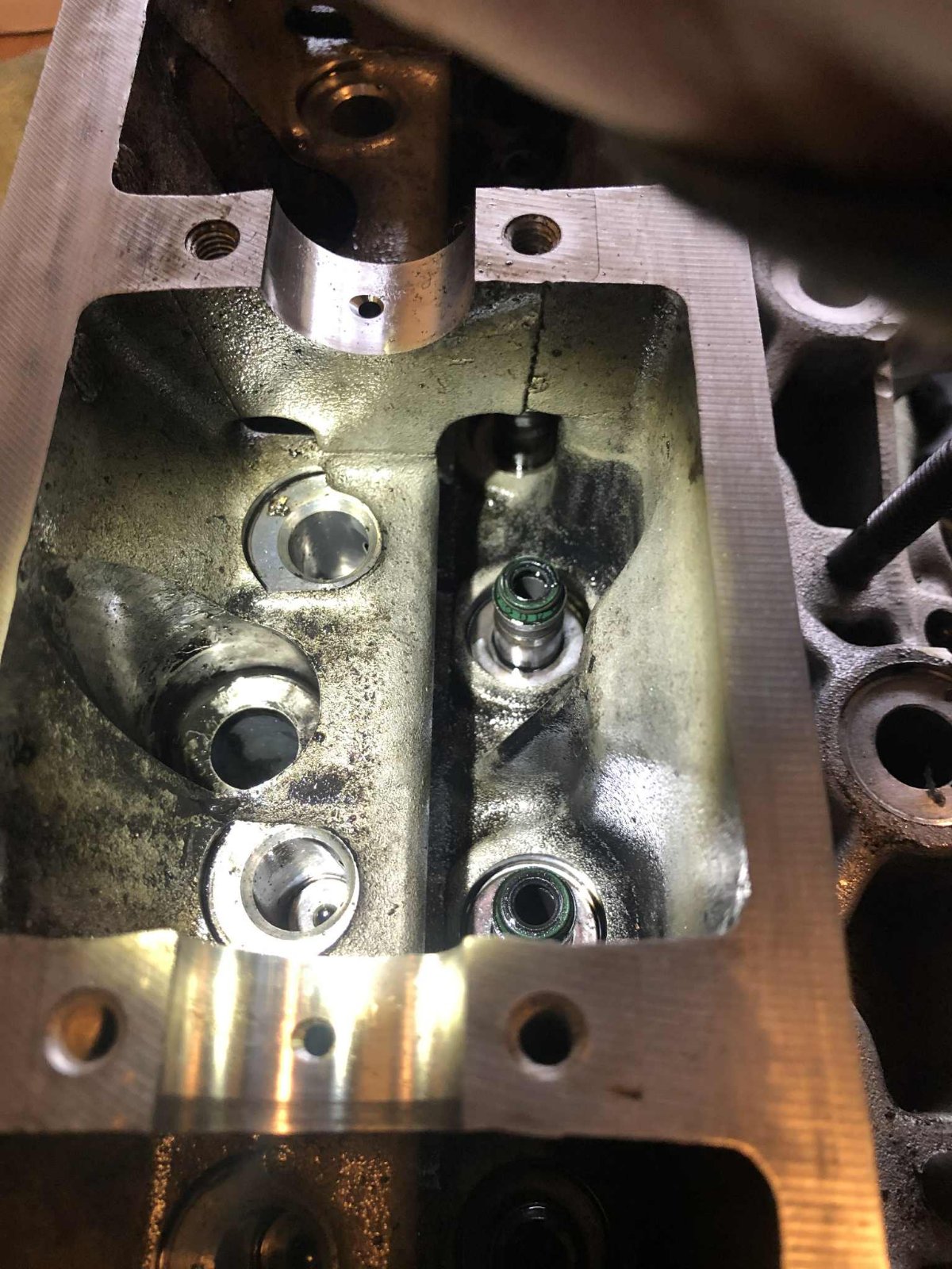

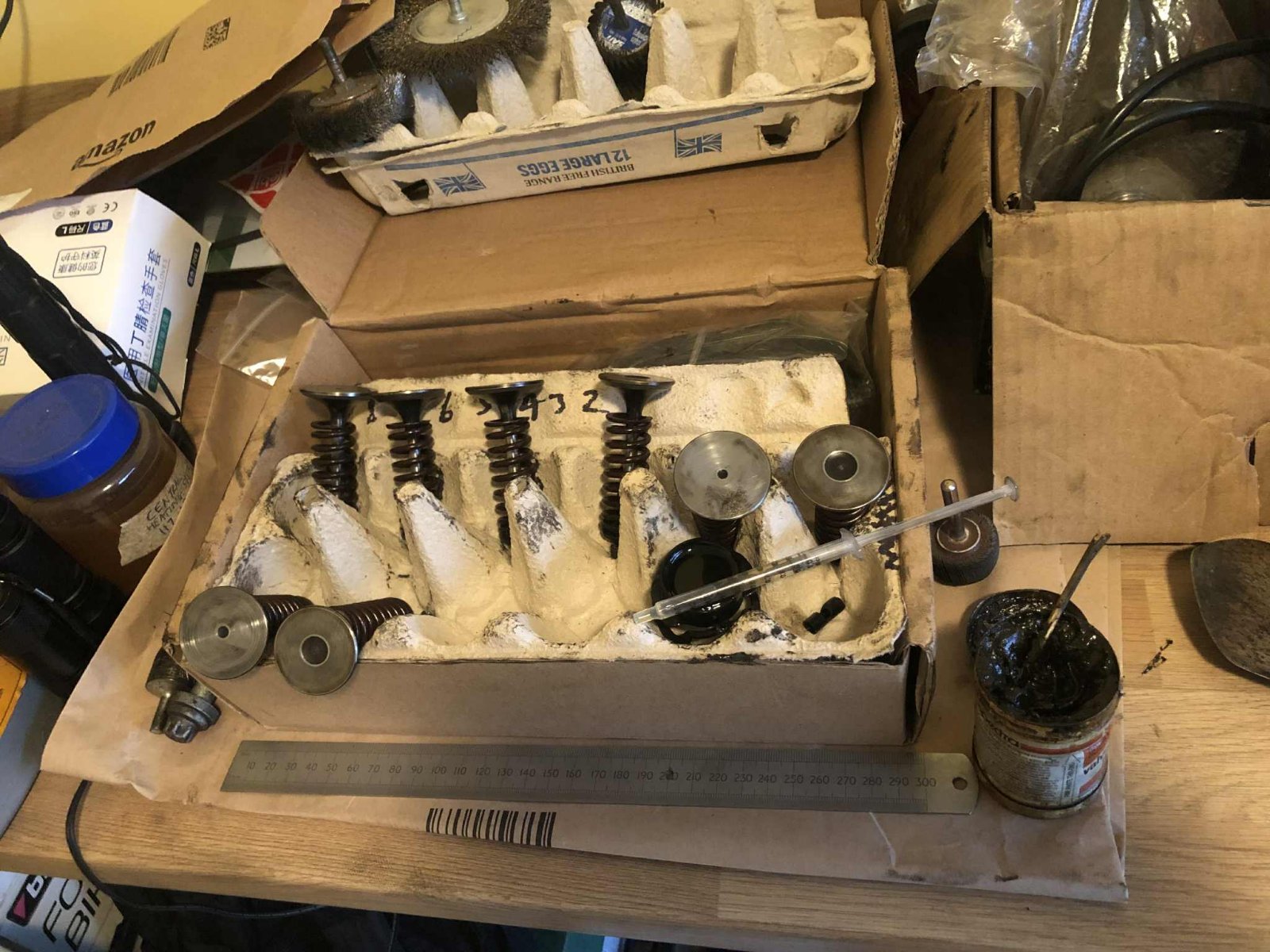

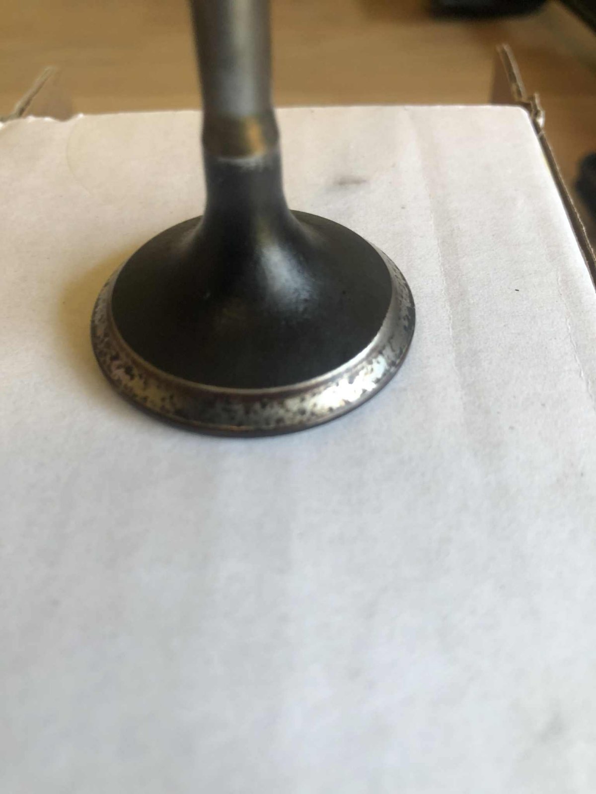

Almost done lapping .... takes a fair while even on an 8 valve
Valve Lapping Drill Attachment

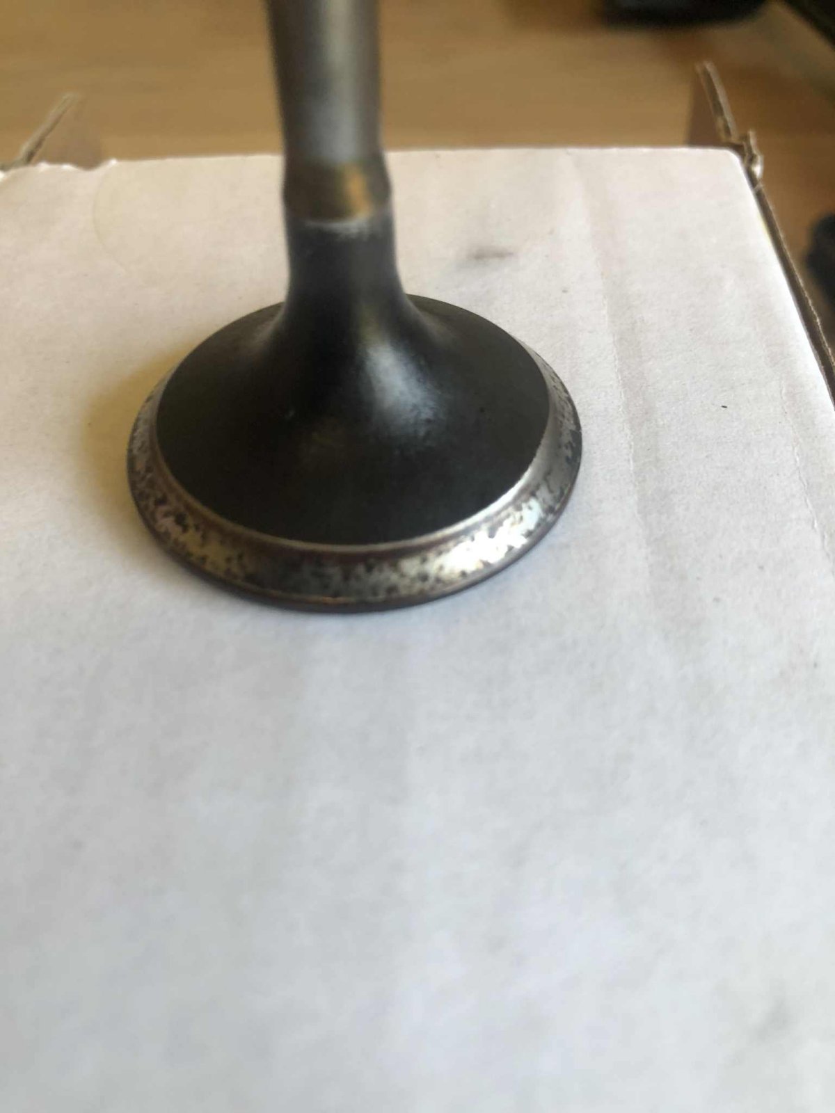

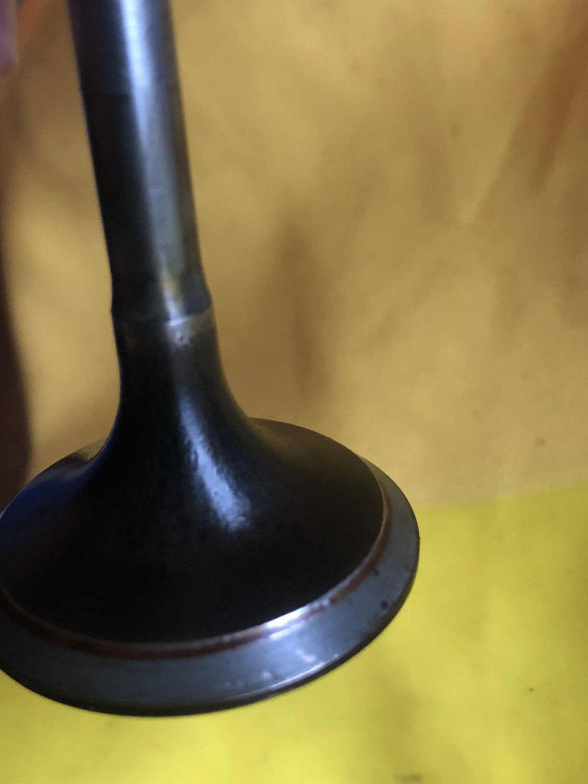

Intake Valves earlier photo ^^^^ seemed to have more gunk built up on the back of them but the seats cleaned up easier, 3-5 application of fine lapping paste.
Exhaust Valves had more pitting on the valve seats and took 3 appications of coarse grade and 3 fine grade lapping paste.
That was with the drill attachment and they're looking reasonable now - hope I haven't overdone them
I'm going to do a fine grade, final hand-lap today just to get more of a 'feel' and also hear the surface match.
I'm under no illusion that there will still be Valve leakage but my intention has always been to improve what I had at the minimal expense .... I'm not recommending anyone else to use this approach but the valves are around £16 each plus I've still got to take the tiny chip out of the camshaft it makes the reconditioned cylinder head route (£275 inc recon camshaft already fitted) quite attractive especially if it's your only car and you need it back on the road ASAP.
Recon route would also require checking/measuring piston crown protrusion/deck height to calculate the correct thickness of head gasket required
Anyway here they are
BEFORE AFTER ...soon ...soon be rebuild time

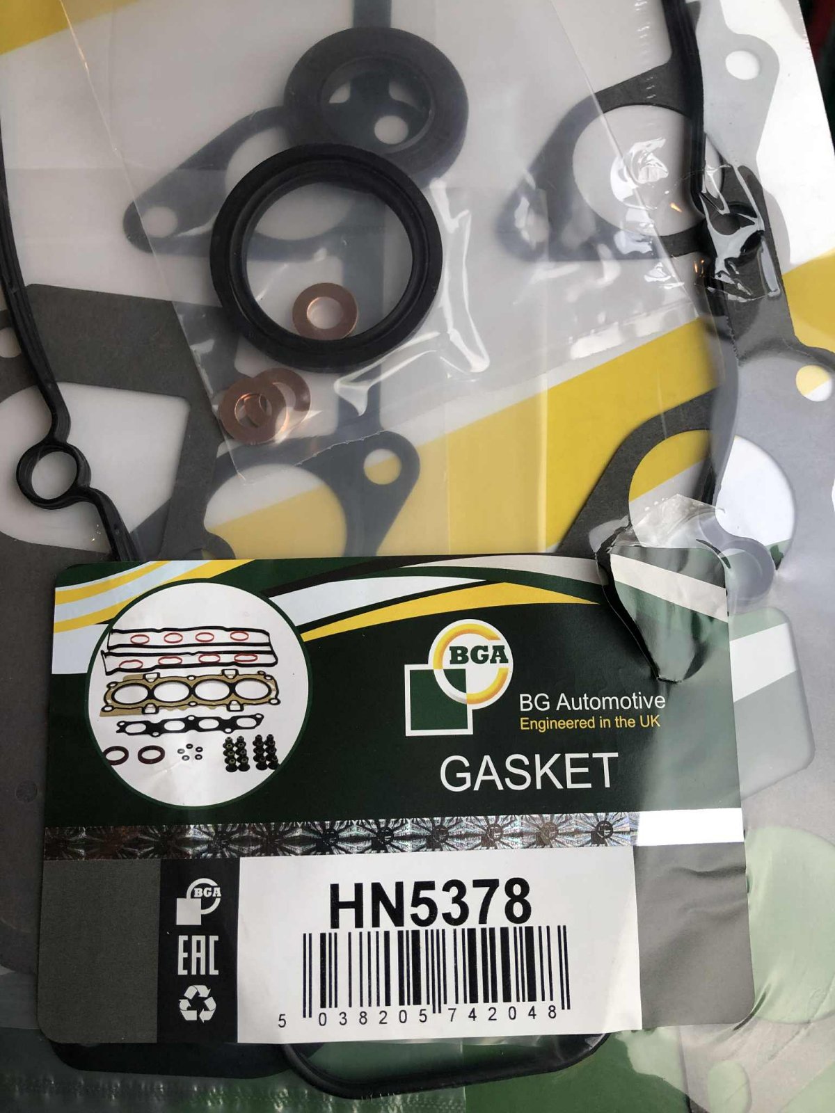

Progress stalled as I've got compatability issues
.... The one I ordered was listed on Ebay as compatible for "Xantia 2.0 HDi (110)
Note Engine Number from: 8332"
BGA Gasket Set HN5378
OE: 9569752780
Can anyone confirm this number
Mine is
ENGINE (RHZ) DYBQ4012843 (DW10ATED) Doesn't really compute with their Engine note
Unless they are refering to my ORGA number which is:
BUILT (ORGA 8296)

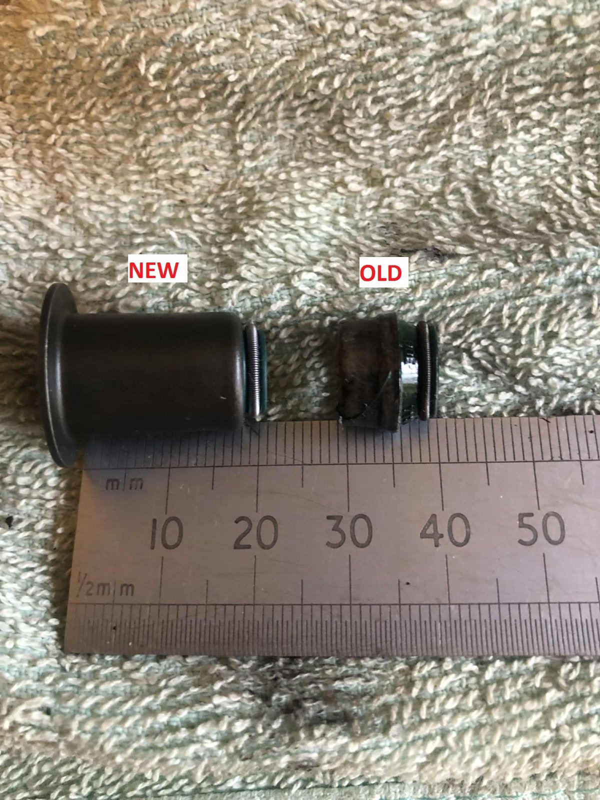

I couldn't really see a difference initially until I pulled the first old one off and thought I'd ripped it in half
The oneS received in the kit has different valve stem seals as seen here:
Contacted the Ebay seller but they're quite vauge, just saying to check my original for part numbers - despite the obvious difference in size (same photos supplied)
I can make out some of the part no. on the seal but it's tiny and I can't decide where it starts these are the bits:
"7161" "BER 886 V(or N)W" "ø6P"
IF anyone can make any sense of that I will be impressed ....
I wonder if they are on about the OE part No. 9569752780
[NOTE: My cylinder head part no. 9633750210]

Skull wrote: 26 Jan 2026, 19:42 Cheers Jim
Progress stalled as I've got compatability issues.... The one I ordered was listed on Ebay as compatible for "Xantia 2.0 HDi (110)
OE: 9569752780Can anyone confirm this number
Mine is
ENGINE (RHZ) DYBQ4012843 (DW10ATED) Doesn't really compute with their Engine note![]()
BUILT (ORGA 8296)
I couldn't really see a difference initially until I pulled the first old one off and thought I'd ripped it in half![]()
A jeweller's loupe always comes in handy for those of us who are visually challenged ie no longer have 20/20 vision.
I'd send back personally. They clearly don't look right. Autodoc is your friend for correct parts. Trying to think of the good brand - Reinz?
EDIT: Victor Reinz.
And yes your engine is RHZ. Have they sent you RHY? I'd doubt the internals would be different. It's just the intercooler and some other guff that gives the 19bhp increase.

BGA Head Gasket Set HN5395 looks to have the shorter valve stem seals I need
Construction Year to: 12 / 2001
Engine Number to: 8331 (I'm guessing this relates to my ORGA number 8296 CJ rather than the engine number though)
Just trying to organise an exchange with the Ebay seller ....
