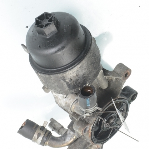

If it's this type of filter housing, then they're supposed to have a cut out in the threaded portion of the black plastic housing that breaks the airlock as you undo it and allows oil to drain back into the sump. Basically - pause before you fully unscrew the black housing !
Obviously, it never quite works how it should, but most of the oil goes back into the sump. :rofl2:

That's good to know :)
I'll take note and try that the next time I change the oil on the Pug of Love!
