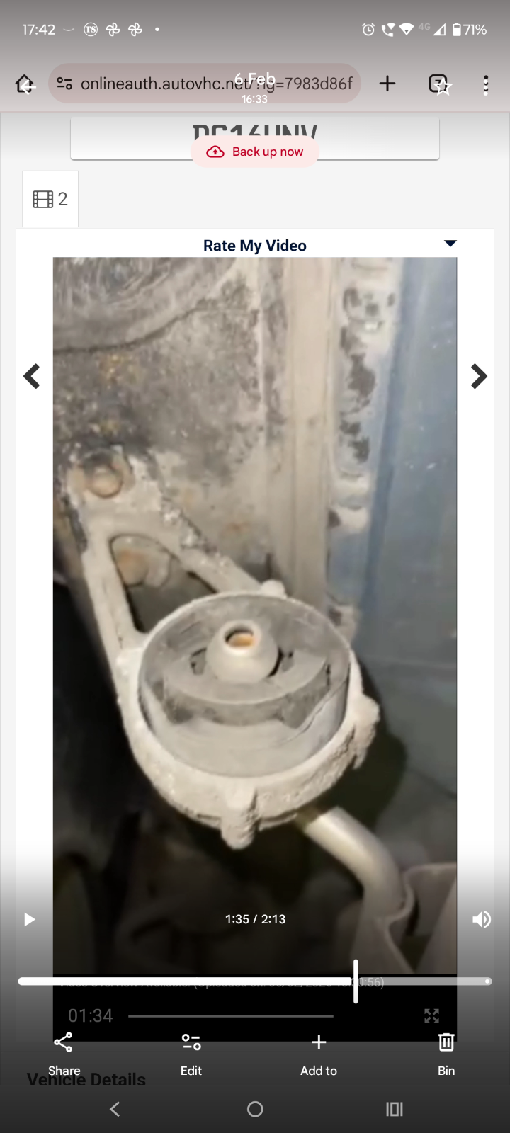

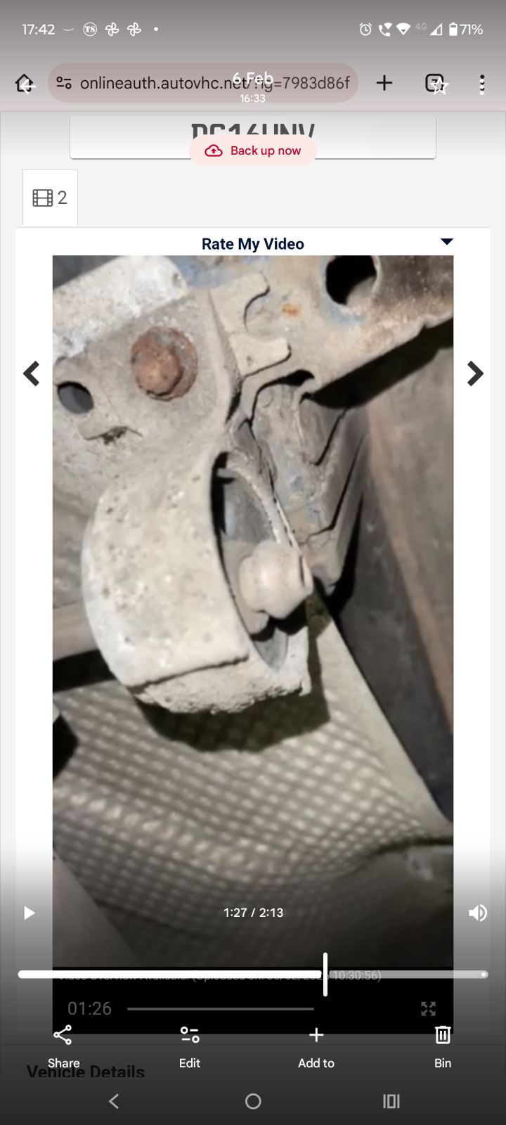

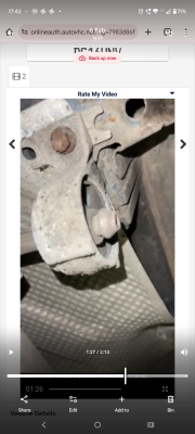

Exhaust mount:
Front one:
From the mechanic video
Holder, exhaust system - AUTODOC https://m.autodoc.co.uk/fa1/21931708
£10.99
Rear one, proving more elusive!!
Edit, found it, eBay:
https://ebay.us/m/zORzkJ
£9.88

Enterprising chap attempting to fix his 308 mount:
And, after it failed a part 2
I think for sub-£10 I'll just get one ordered. Will likely have a play at sticking the old one (and keep as a spare)

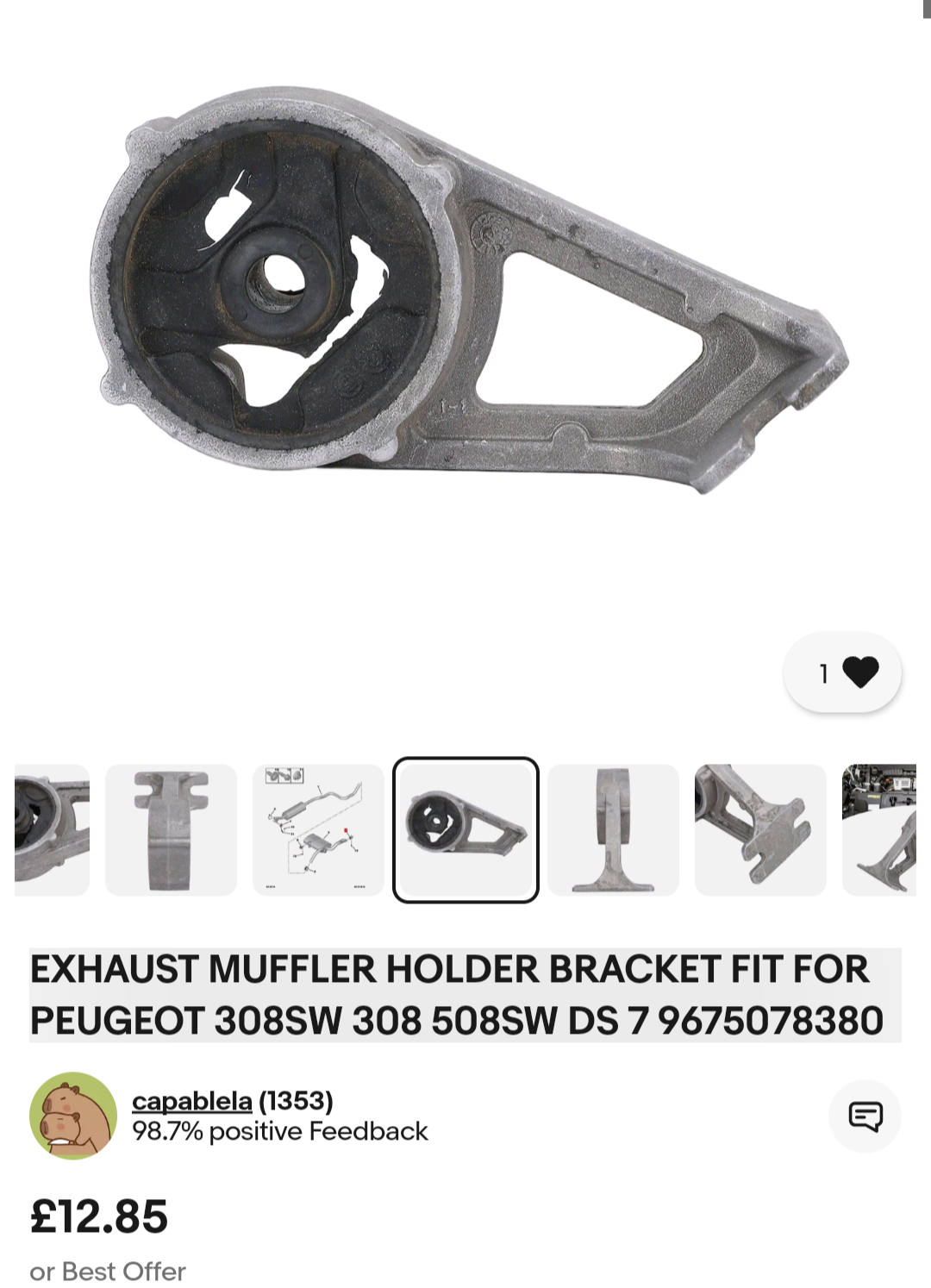

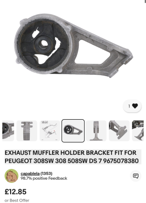

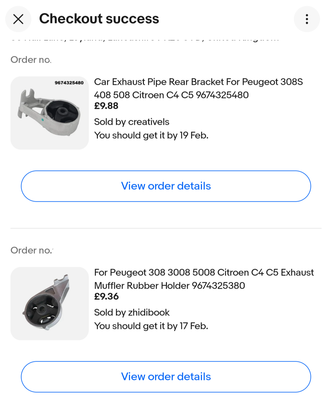

Peugeot dealer price to beat, round 1:
Exhaust System and Catalyst : £215.03
Exhaust Rear Silencer - Flexible Mountings Required
2 down:
eBay to the rescue
eBay to the rescue
£9.88+£9.66= £19.54 (91% saving)
EDIT
First one = incorrect!
Hence:
Second attempt (eBay, again)
£12.85
£9.88+£9.66+£12.85= £32.39 (85% saving)
