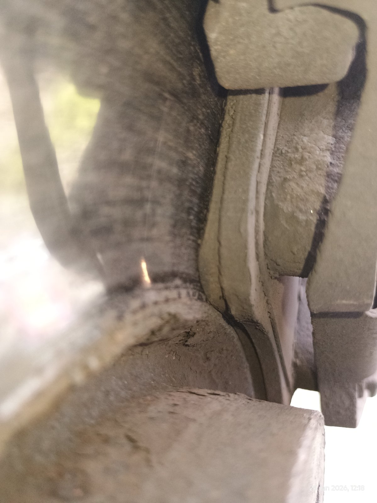

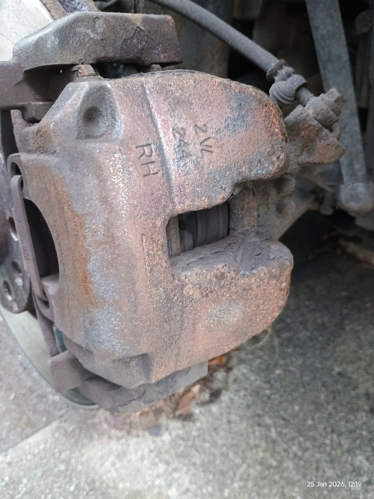

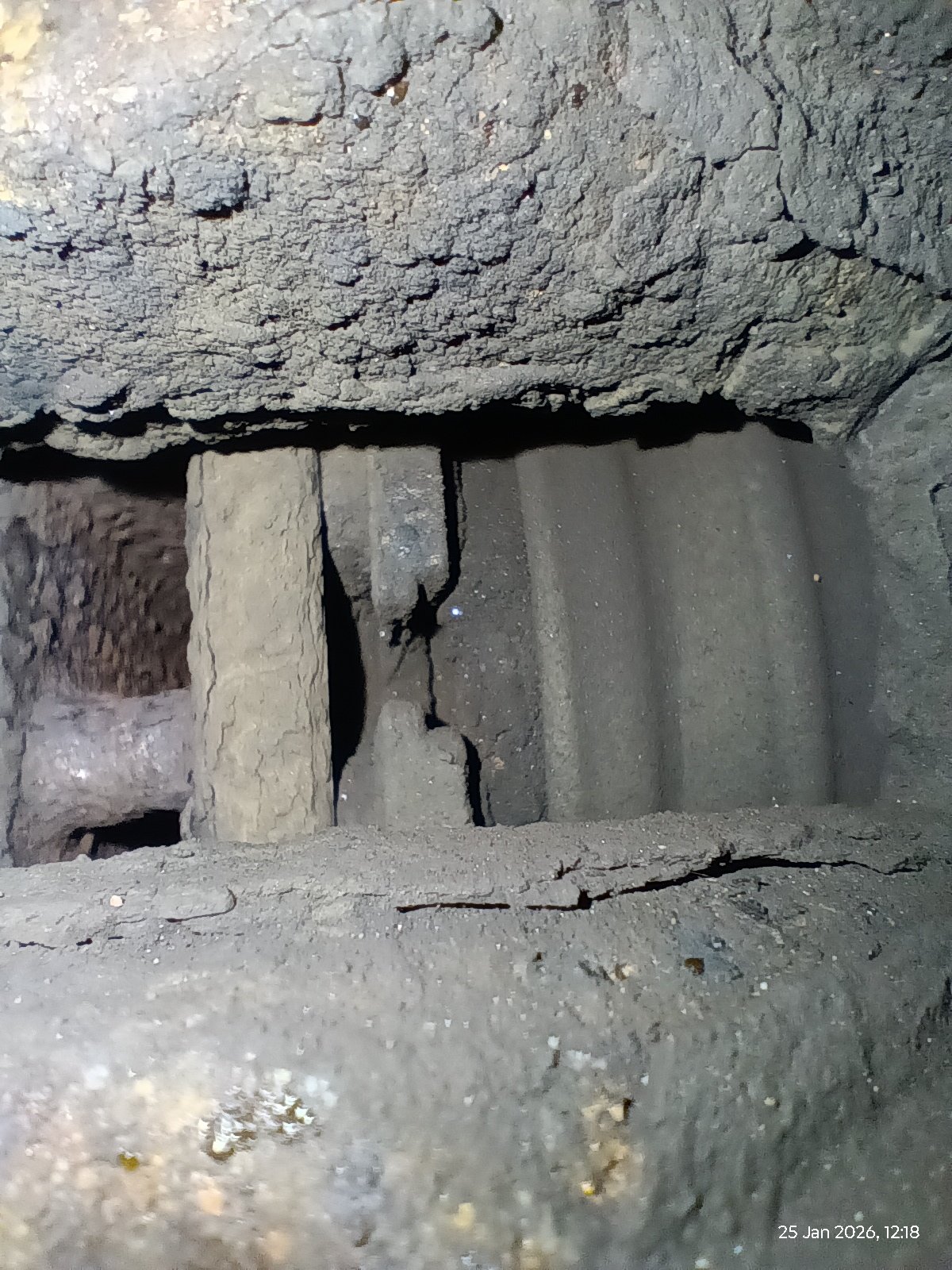

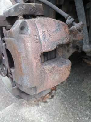

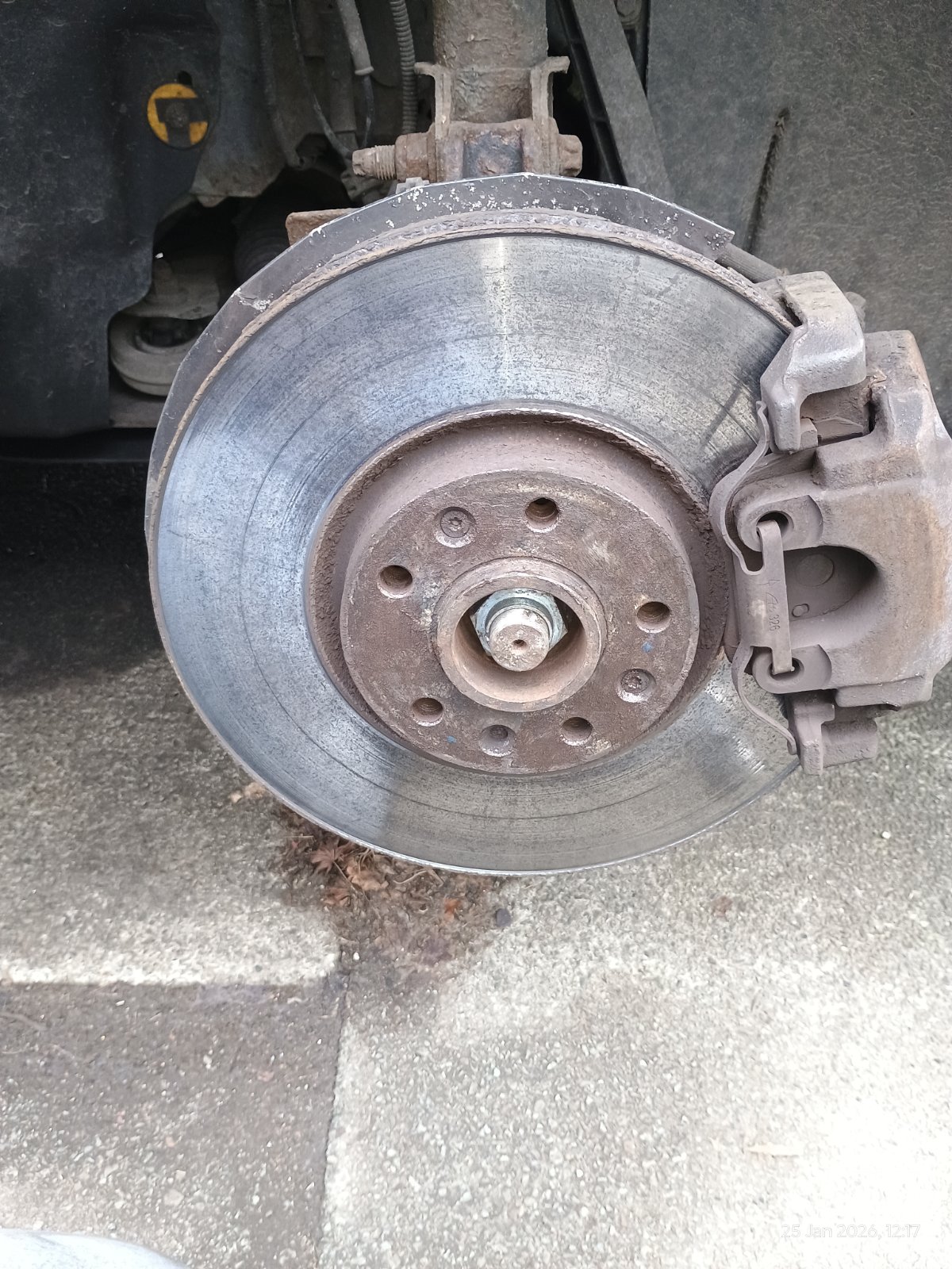

Front brakes:
Not that scored but bit of a lip front disk (right)

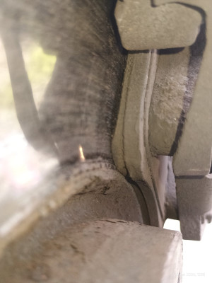

Front right outer pad
Front right inner pad

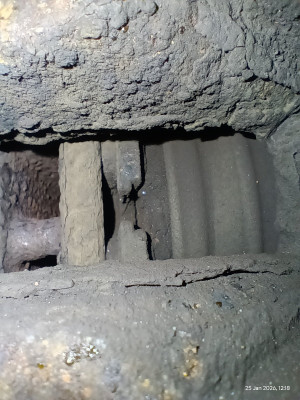

Front right caliper
Front right caliper

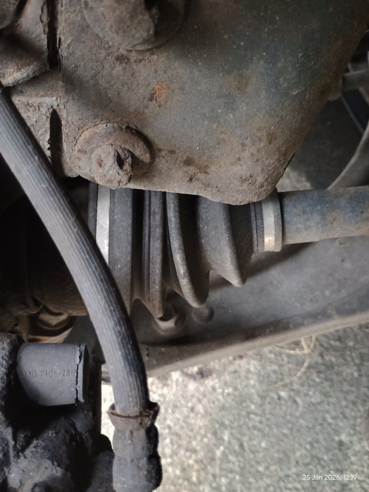

CV boot, looking fine
These are the source of the advisory: pads wearing low. Which seems true!

Having done a bit of digging:
Front measured diameter 305, actually 304mm
Thickness is apparently 28mm (which is why I couldn't get my 0-25mm micrometer over it, as well as the caliper and brake dust shield getting in the way.
These will get cleaned up and new pads.
Either Ferrodo from Autodoc or Bosch or Febi Bilstein options from Car Parts In Motion on eBay. About £30-35.
Rear measured 268mm is spot on.
Thickness is 12mm (but again I couldn't measure it well without disassembly - academic when I'm going to swap the rear disks)

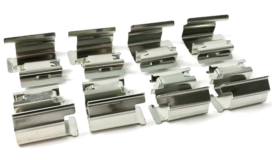

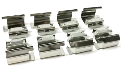

Does not seem to be much in the way of a "fitting kit" for the rear pads (possibly some small stainless sliders), front has a large spring clip. Existing looks ok, if I change my mind it's £4.59 for a pair of them from Autodoc.

If the sliders are coated with a black plastic stuff , keep your eye on it as that tends to melt and make the brake pads stick , as I found out when I cleaned my 308cc rear brakes , I cleaned it all off , brakes no longer stick, might be worth pulling it off before your fit them in place.
:-D
Posts: 5355
Joined: 25 Apr 2022, 09:03
x 2361
Unread post by MattBLancs »
Huskyxantia wrote: 25 Jan 2026, 20:52 If the sliders are coated with a black plastic stuff , keep your eye on it as that tends to melt and make the brake pads stick , as I found out when I cleaned my 308cc rear brakes , I cleaned it all off , brakes no longer stick, might be worth pulling it off before your fit them in place.
Good to know thank you.
Looking online, look to just be little thin stainless things:
From eBay
From eBay
Example from here: https://ebay.us/m/NU9lbH
