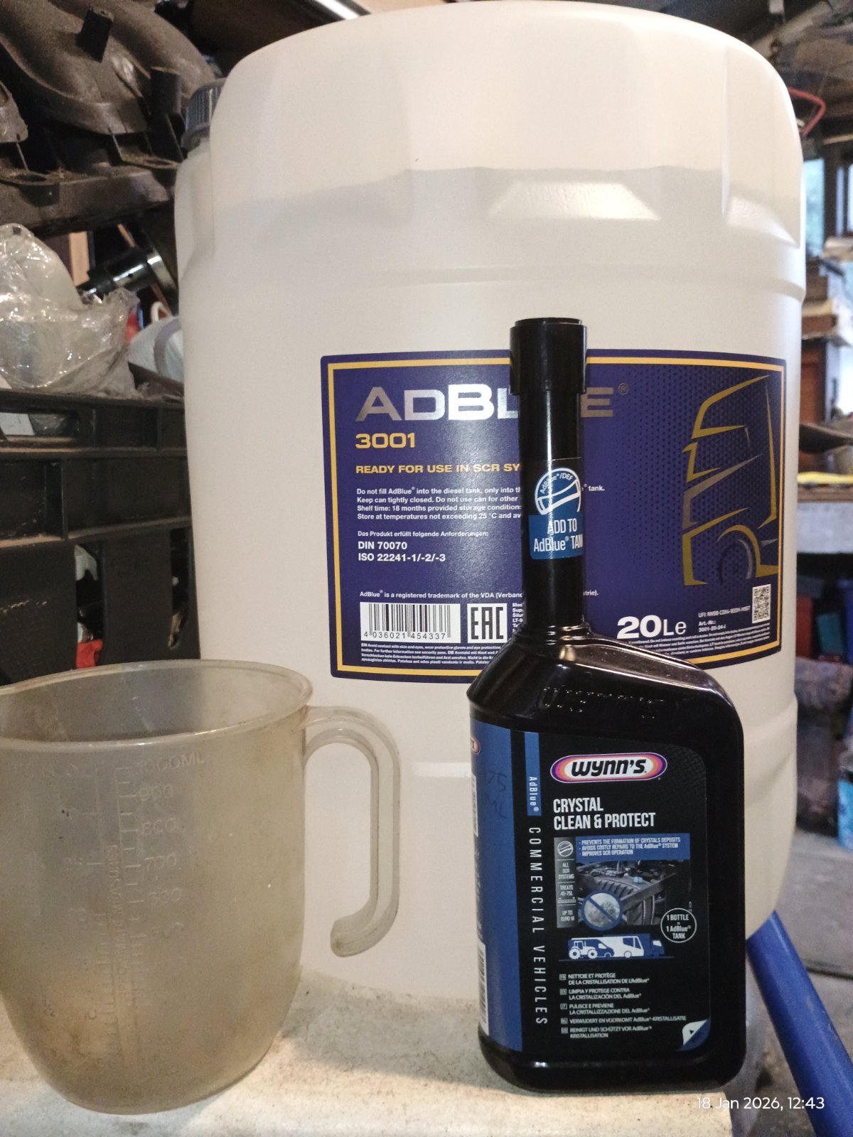

Wynn's additive says
500 ml bottle treats 45 to 75 liters of Adblue
So (500 / 45 ) x 20 = 222 ml for the new bottle of Adblue
So 250ml poured into this new container. Thought treating the whole lot better than doing the sums every time I top up.
Blue 308 SW adblue tank refilled: 3.5 fluid ounces (as seemingly the long spout is dual marked and I was filling up to the imperial lines!)

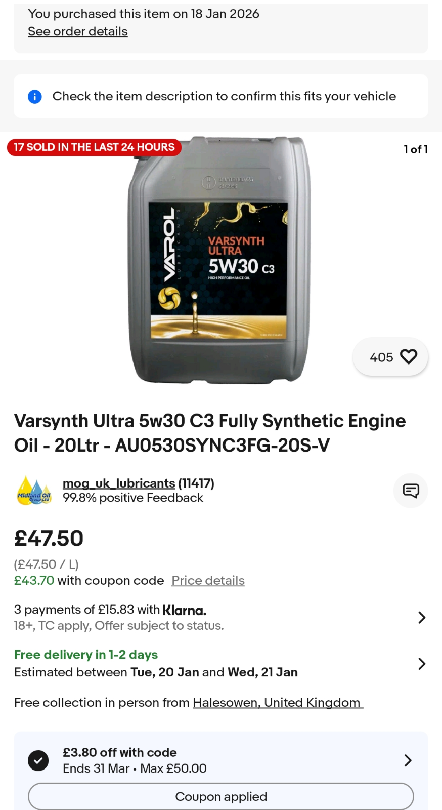

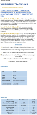

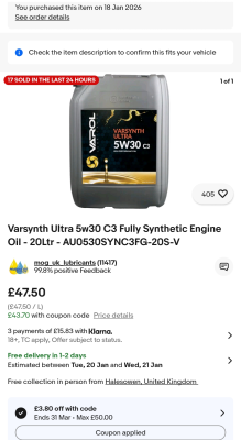

As I've got through my 20 litres of Mannol engine oil, I've been hunting a fresh stock.
This is remarkably cheap, so I have snapped it up:
https://ebay.us/m/lQDyEY
£43.70 for 20 litres!

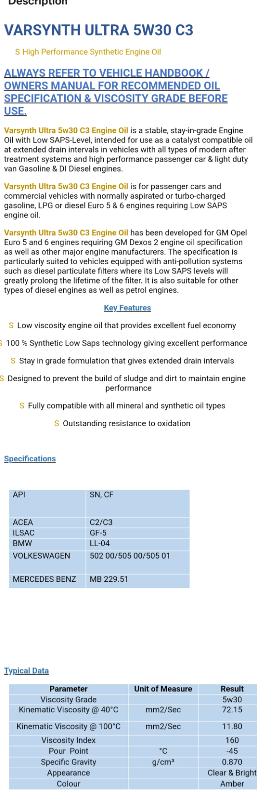

Spec reads ok as far as I can tell:
From eBay description

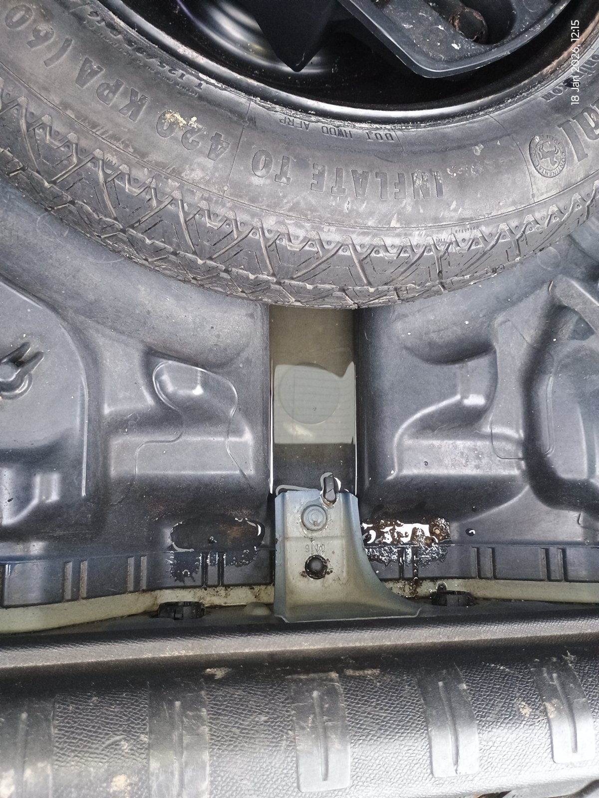

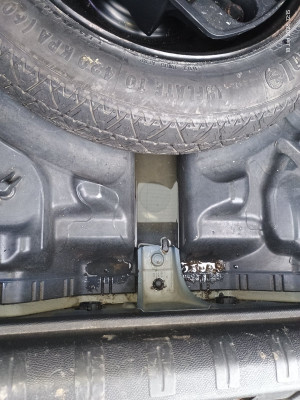

Oh yes, one other future task added itself to the list:
Need to work out where this water is making its way inside!
This is the actual boot floor (on which the spare wheel, polystyrene spacer and tool kit sit - beneath the false floor (on which, err, buckets of soil ride to the tip! :-D ))

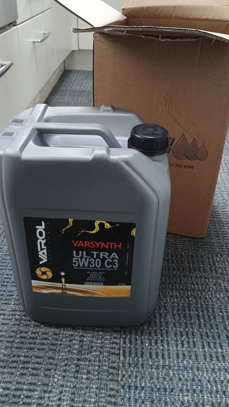

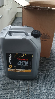

Big bottle of oil arrived today:
Varsynth
Varsynth

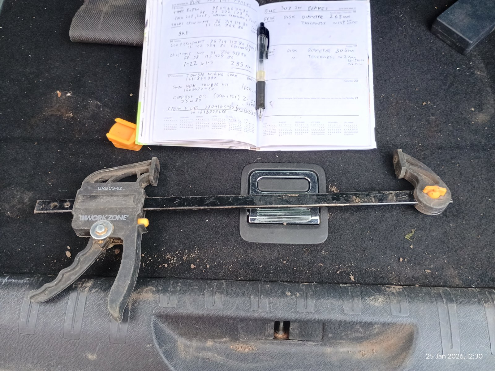

Then looked to identify what brakes are actually fitted to the Blue 308 - as Autodoc suggests three different sizes for the front and two choices for the back!

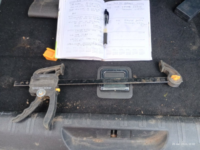

A tip online suggested an excellent way of measuring disk diameter - use one of these:
Spoiler: show
Cunning clamp = caliper candidate

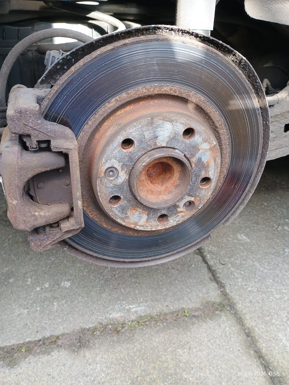

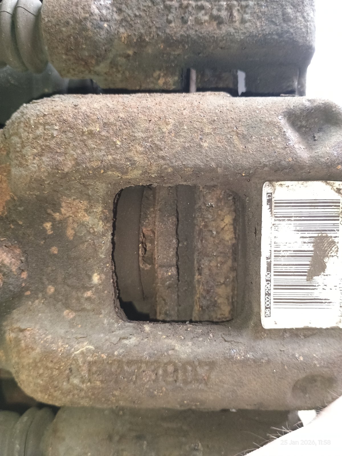

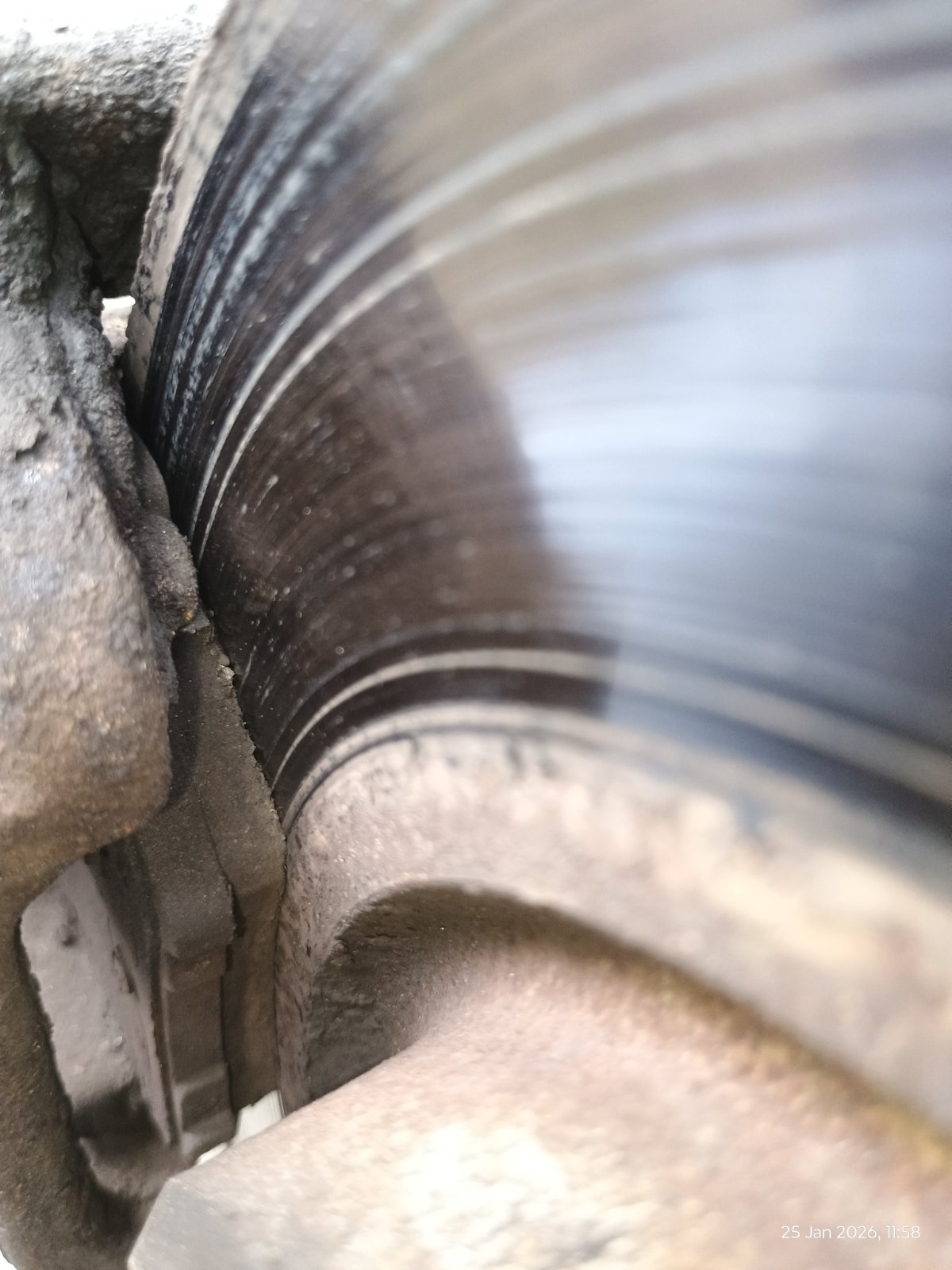

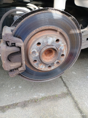

Rear brake summary images:

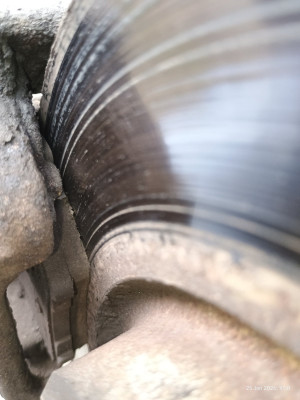

Disk is pretty scored (surprised was not an MOT advisory) so might look to change them.

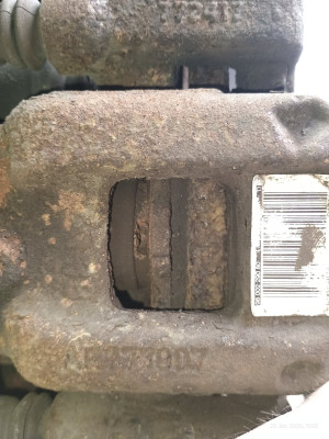

Pad thickness not bad at all, will likely not change these (unless I spot some as cheap as GSF lists: £5! But sadly a "good price but no stock anywhere" purely hypothetical bargain.

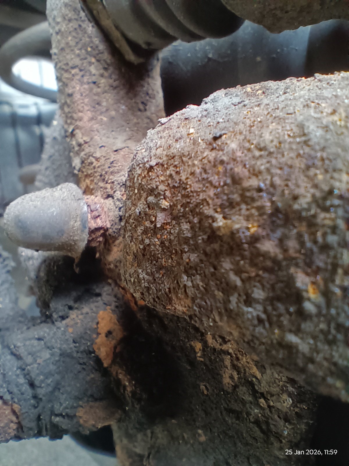

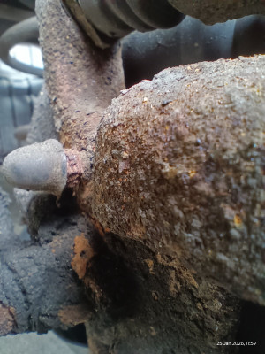

A bleed nipple that doesn't look like it's moved in a LONG time

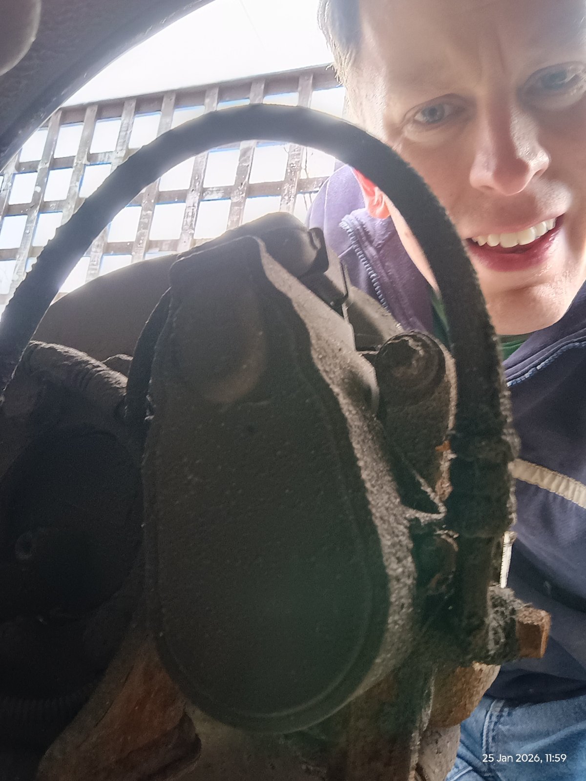

Berk for scale
Berk for scale

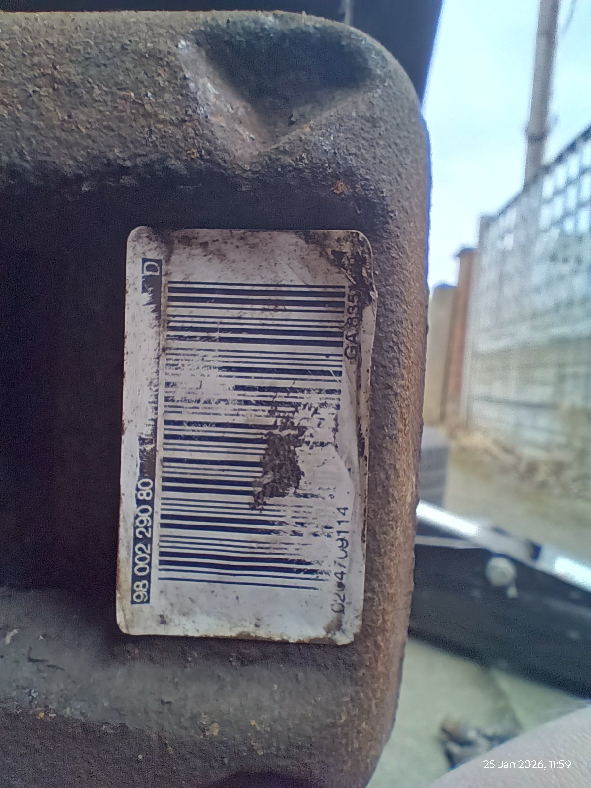

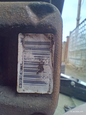

Caliper label
Caliper label
Inner pad thickness (rear, right)
Outer pad thickness (rear, tight)
Scored disk
Scored disk

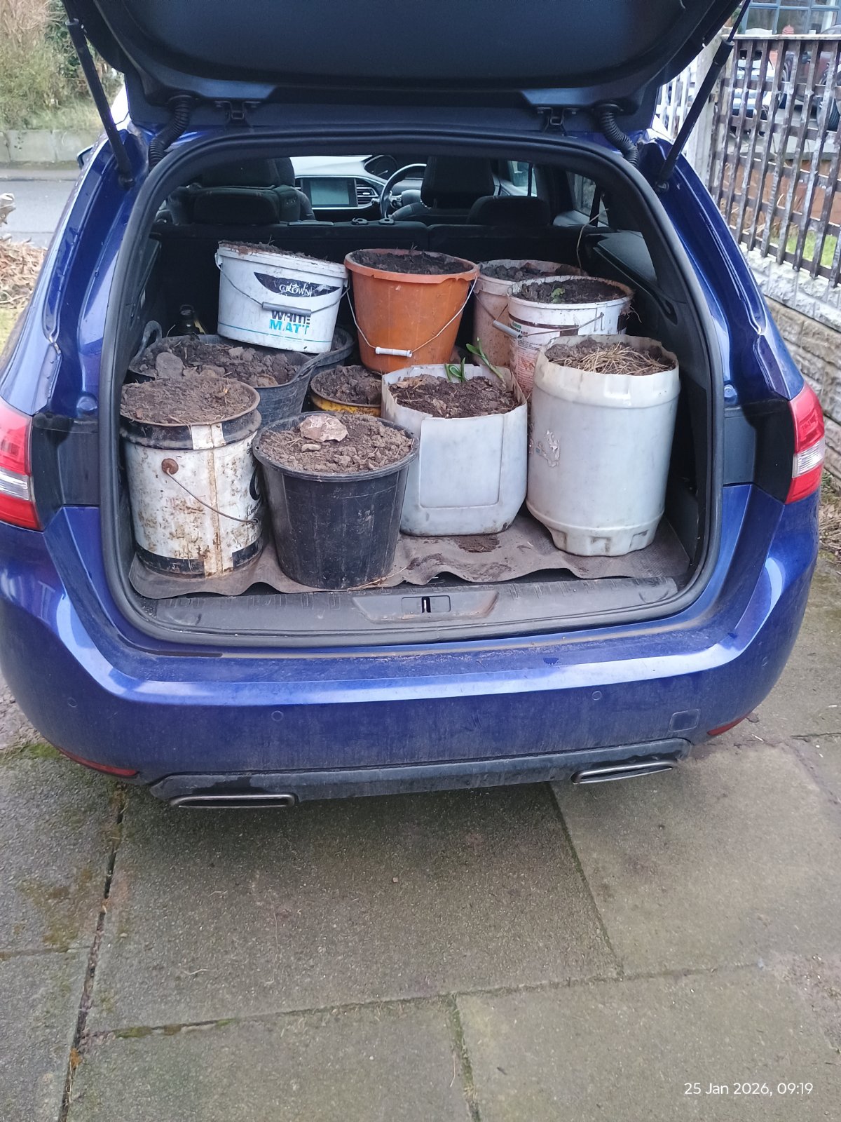

Just imagine turning up to do a car boot sale with that in the back , someone probably would by a couple of buckets of soil for there garden, when my drive was made bigger a few yrs back I was going to skip all the dirt , no need half the village took it ! Saved me some money 😆 I still go past several gardens and say there's my soil in that one , and that one!

How about take the disc off and flappy wheel them smooth , ive done it in the past

Ha ha, that's great! I've offered previously the better of the soil (as some is pretty clay claggy stuff) on our local Facebook group but no takers. Well, about half a wheelbarrow of it went! :-D

At least some of it went to some use , looking at the brake pictures, The scoring ,i always thought was caused by grit , but I'm thinking now maybe an imperfection in the disc metal it self ?

Huskyxantia wrote: 25 Jan 2026, 13:58 How about take the disc off and flappy wheel them smooth , ive done it in the past
Yes I might do, though Autodoc has a decent brand (valeo) pair of disks for £41.99:
Hey, check out VALEO Brake disc in the AUTODOC app https://m.autodoc.co.uk/valeo/22778242
Cheaper than even there own brand Ridex £21.99 per disk.
Given those prices, I might treat it to a new set.
