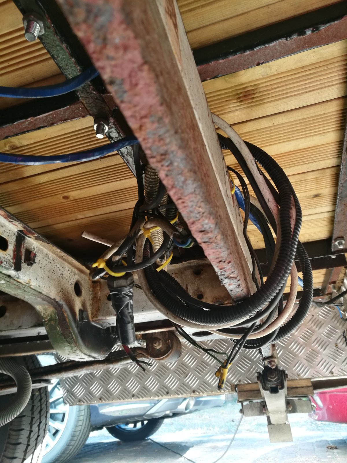

I need to start thinking about rerouting services now. So time to make some sense of the mess under the back.
Under the bathroom we have this...
Which makes sense, a DC feed for the toilet flush system.
Then this load of spaghetti further over (roughly under where the fridge sits).

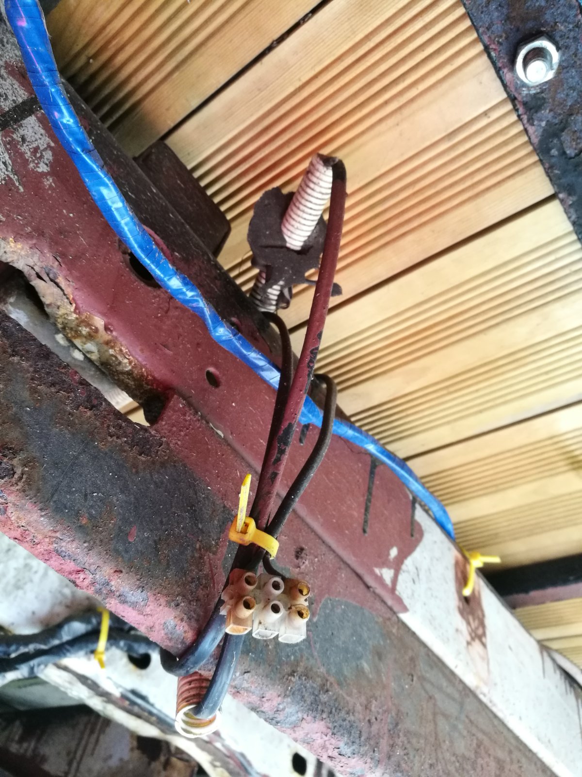

There's a 230V mains lead (fridge), a 12V feed (also fridge), the fresh water tank level sensor...and a further 230V and 12V line, the purposes of are currently unclear. In the absence of data to the contrary they will be routed into the living area and "parked" in a junction box until it becomes clear where they should go.
I do wonder if they might be more stuff to do with the fridge...know some vans have interlocks to prevent the fridge being run on gas when the engine is running etc...

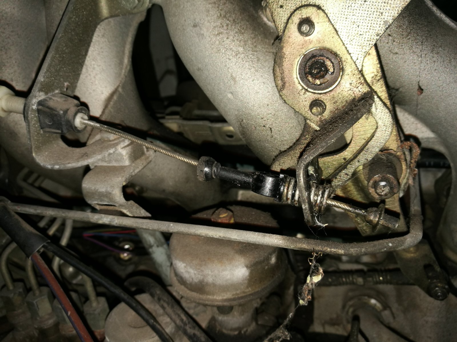

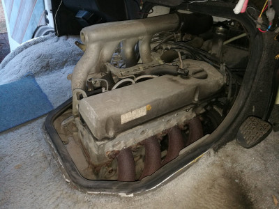

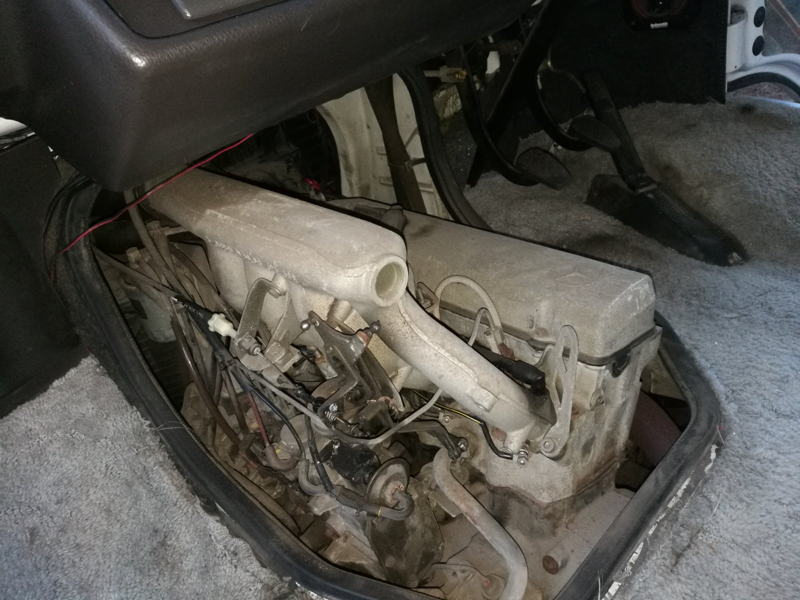

When turning into the drive we had a complete loss of throttle response. Well then, I'll bet the screwed I wedged into the throttle arm when the cable retaining bush cracked has now fallen out.
Yep!
I did have a rummage around to see if I had anything that would elegantly solve the problem, sadly not. So we went after it with a larger bolt, some nice wide washers and a lock nut.
I did get it to sit a bit better after this by the way. It should be impossible for this to fall out again now.
A compact but perfectly formed engine if ever there was one...

I was wondering if the 'spare' 12V/230V supplies would have been for a freezer? My Mum (who lives on a narrow boat) has a 12V freezer (which can be charged from the engine or the solar panel), and there are multi-fuel freezers available.

Not sure, the fridge does have a little freezer compartment, and is already set up for three way operation.
It looks to be factory based on the conduit it's in, but that's not a huge help...
Will wire up what's reasonably obvious then go hunting what's not working.

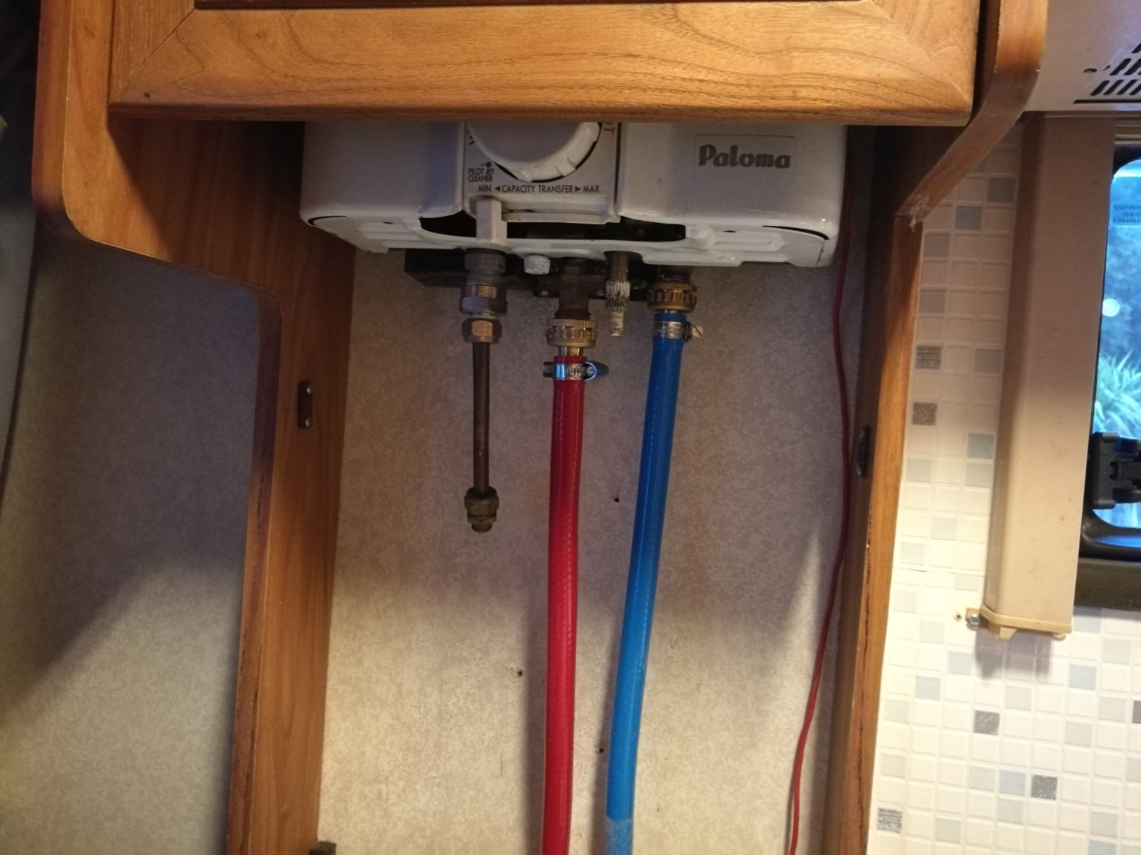

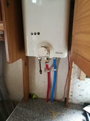

I have got most of the supply side plumbing in now. Unfortunately discovered when feeding it water for the first time that the water heater leaks. Looks to be a perished O-ring at the heat exchanger to valve block join...will see if I can find a replacement tomorrow.
Speaking of the water heater...I solved the hose connector issue.
Solution was a garden tap connector! With the 1/2" adaptor many come with these days, it's a perfect fit!

The cause? This blasted thing.

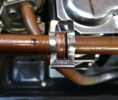

After finally figuring out how to get water lines connected to it yesterday, it immediately proved to have serious incontinence problems.
Sorting that took me a significant amount of time, not least because of these stupid excuses for connectors.
Seriously, what was wrong with a proper compression fitting?!? The scratches on the pipe suggests I'm not the first one to fight with this one. Eventually though, I got the two problem joints water tight.
So was able to get the water system properly pressurised and bled through, which went pretty well. Couple of weeping connections at the kitchen taps, but nothing major. Right up to the point where the pump stopped pumping. It's pulling air in somewhere, I suspect from a perished seal... it's got an appointment with the instant gasket tomorrow, or the pump will be getting replaced. We're off on holiday on Friday afternoon, so not got time to faff around. The water heater I had to deal with as I couldn't get one locally!

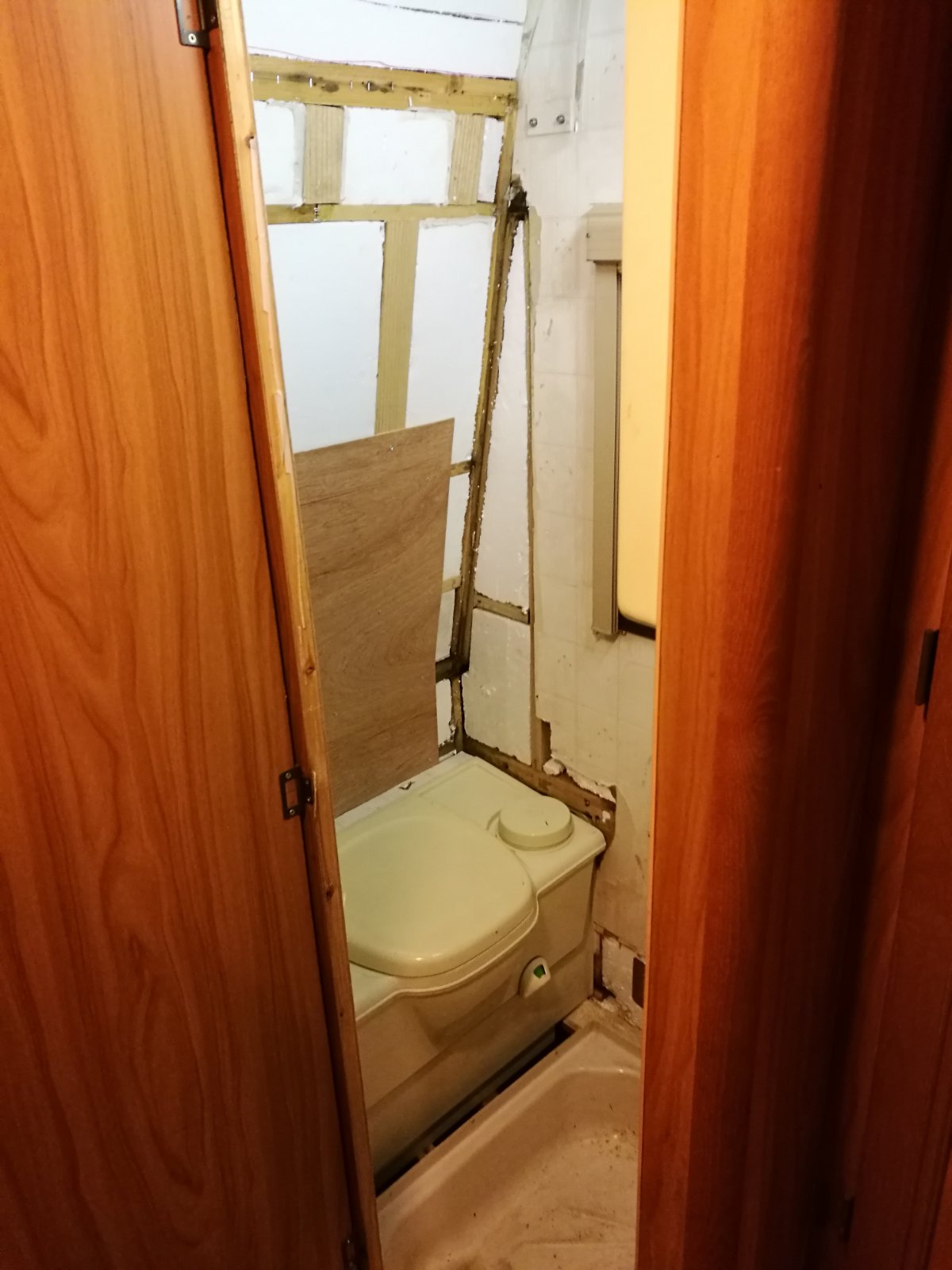

Last task for the day was to make a start on the bathroom. I didn't want to get too involved in there early on because all the water supply hoses run through there so I didn't want stuff getting in my way. The shower tray is now in, likewise the base for the toilet. So should get that fully fitted tomorrow, and then start sealing things up.

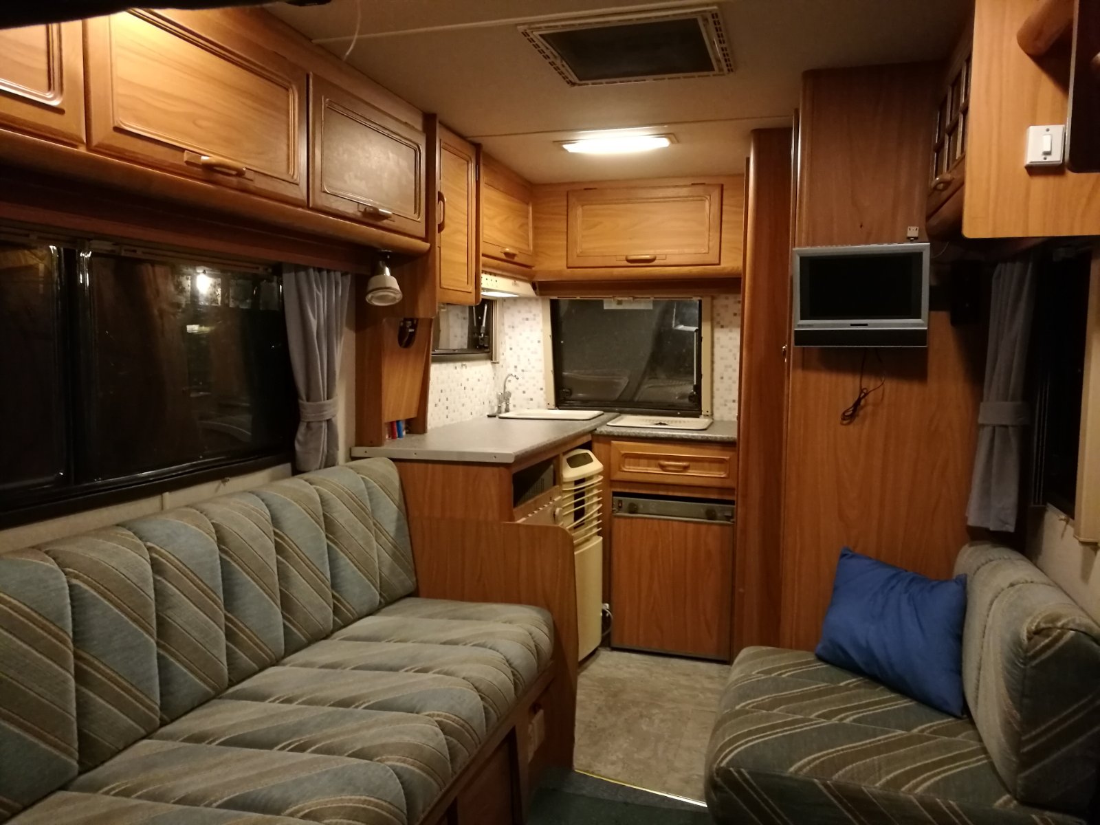

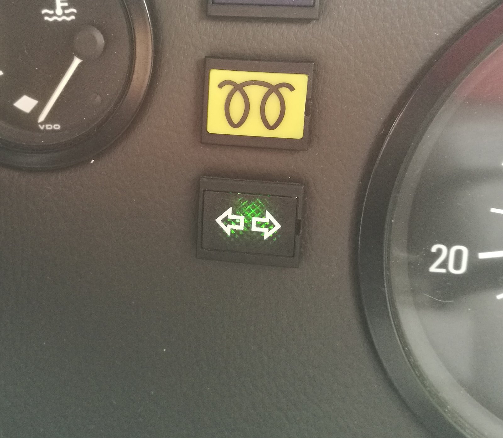

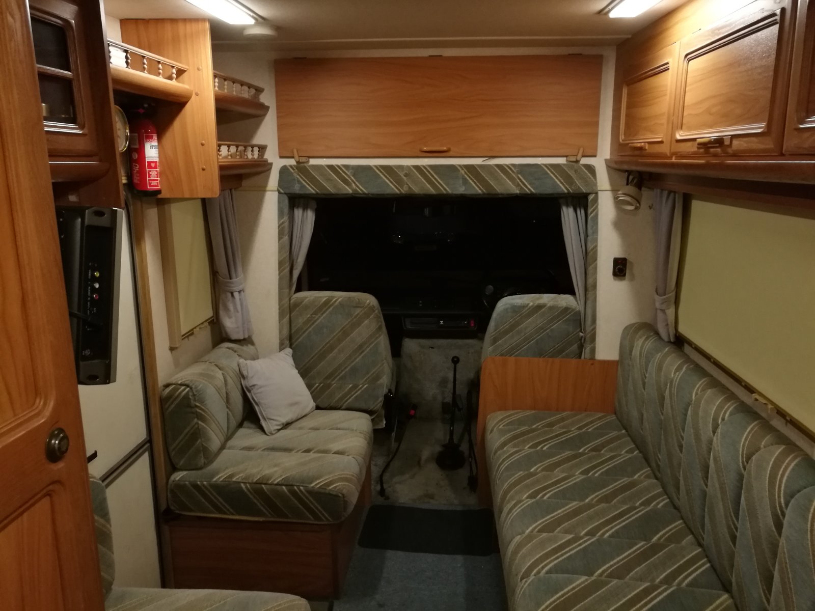

That's been a manic day.
The end result?
...well that end looks much the same as before. Save for the small detail of the indicator light now working.
I'll be thankful for that tomorrow I reckon.
Back here things have changed quite a bit.
Difference being that everything you can see there now works.
The air conditioner was going to be taken back out...until it became quite apparent that it wasn't in any way interested in coming back out of the gap I'd wedged it in.
Gas is limited to the oven and water heater, though both seem to be running perfectly. I do have a CO detector in the van, have triple checked all the gas fittings, and it will only be turned on when needed anyway. Fridge isn't connected up to gas, but we won't need that this weekend anyway as we've got mains on site and DC when on the move.
Bathroom is still a bit of a state.
While it looks a state, it all works now at least. Shower tray was waiting to be cleaned there, van was tilted the wrong way when I took the photo!

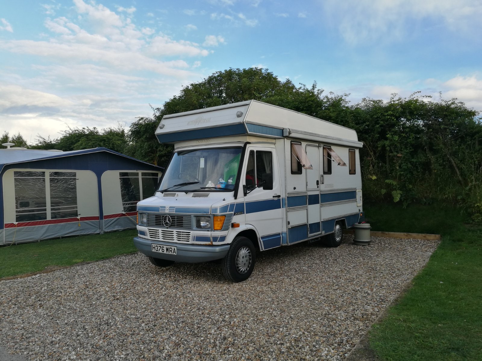

Well...220 miles later, we're actually on holiday in it.
I don't *think* anything else fell off on the way here.
Also had the first real hill test as there was a 17% gradient on the way here. Third was out of the question, but there was plenty of headroom in second... wouldn't have fancied trying that in the last T25 I drove...
Fingers crossed my jury rigged services hold out for the next few days!
