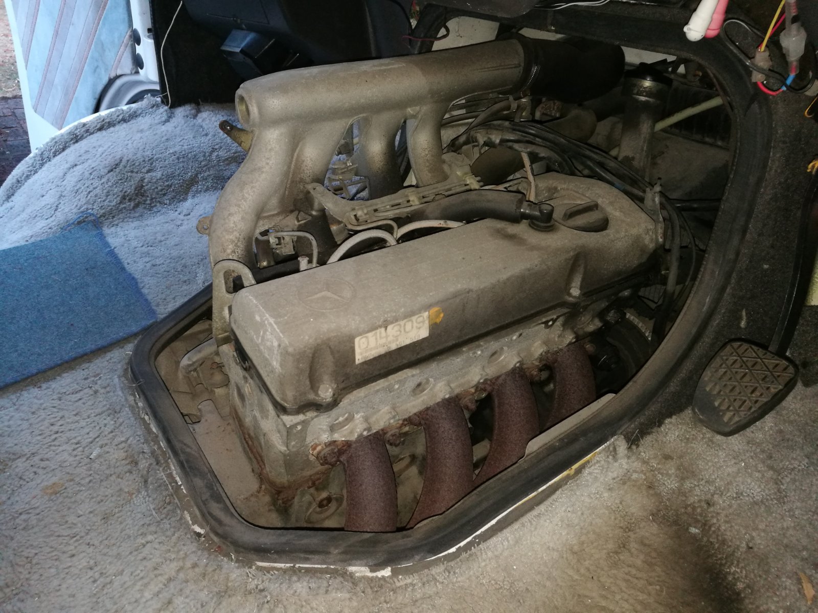

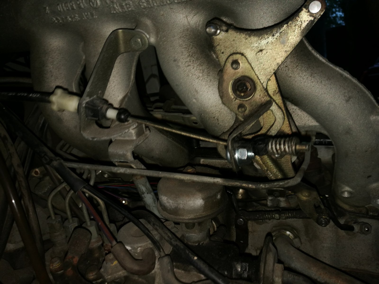

When turning into the drive we had a complete loss of throttle response. Well then, I'll bet the screwed I wedged into the throttle arm when the cable retaining bush cracked has now fallen out.
Yep!
I did have a rummage around to see if I had anything that would elegantly solve the problem, sadly not. So we went after it with a larger bolt, some nice wide washers and a lock nut.
I did get it to sit a bit better after this by the way. It should be impossible for this to fall out again now.
A compact but perfectly formed engine if ever there was one...

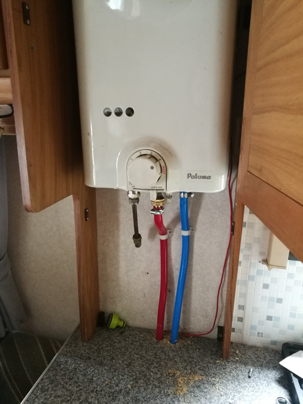

I have got most of the supply side plumbing in now. Unfortunately discovered when feeding it water for the first time that the water heater leaks. Looks to be a perished O-ring at the heat exchanger to valve block join...will see if I can find a replacement tomorrow.
Speaking of the water heater...I solved the hose connector issue.
Solution was a garden tap connector! With the 1/2" adaptor many come with these days, it's a perfect fit!

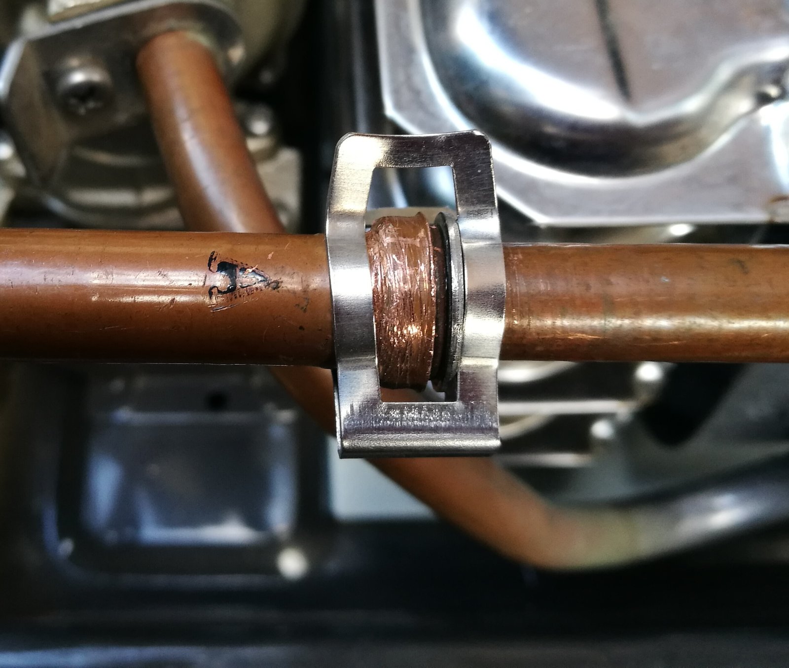

The cause? This blasted thing.
After finally figuring out how to get water lines connected to it yesterday, it immediately proved to have serious incontinence problems.
Sorting that took me a significant amount of time, not least because of these stupid excuses for connectors.
Seriously, what was wrong with a proper compression fitting?!? The scratches on the pipe suggests I'm not the first one to fight with this one. Eventually though, I got the two problem joints water tight.
So was able to get the water system properly pressurised and bled through, which went pretty well. Couple of weeping connections at the kitchen taps, but nothing major. Right up to the point where the pump stopped pumping. It's pulling air in somewhere, I suspect from a perished seal... it's got an appointment with the instant gasket tomorrow, or the pump will be getting replaced. We're off on holiday on Friday afternoon, so not got time to faff around. The water heater I had to deal with as I couldn't get one locally!
