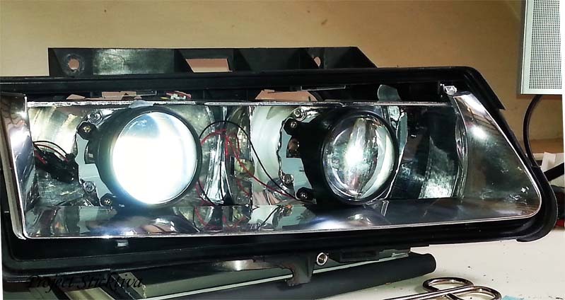

Re: shortly to become an Activa owner...Project Stictiva

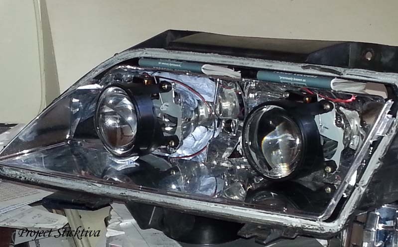

Just trying for size at the moment...One Dips (shutter) the other is a high beam.
As fitted to a S1 light box, they fit even easier, and will need only minor mods to get them 100% stable.
That is neat
Cheers on the lights guys...its a fiddle with something late at night job !..............

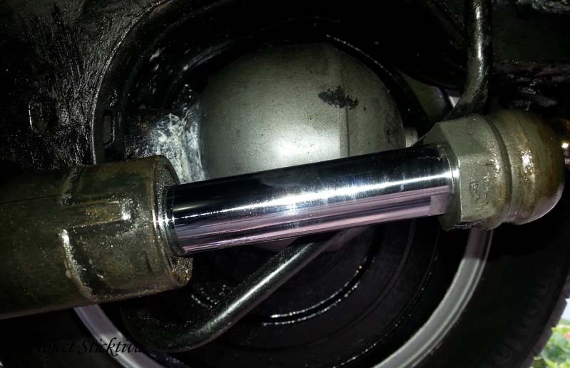

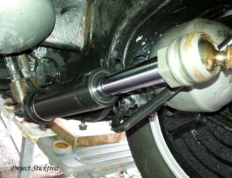

Update on my leaking Activa Ram....
Top joint off and ram dropped free, bellows gaiter off (see the damage).
The top seal, as Jim said is the cause of the fluid loss and thankfully the ram is not damaged.
I will also Need a Lower Ram bush, anyone know the size as I have to get one made I think......

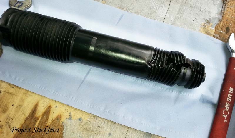

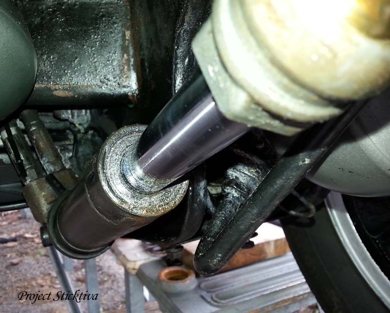

Cleaned up ready for working on the area.
?? Does the base of the metal sleeve (its flaired skirt) fit into a grove formed into the leak-off ring to form a seal ?? ?
- Posts: 55172
- x 8437
Nope, just sits on top of it in a cone..Stickyfinger wrote: ?? Does the base of the metal sleeve (its flaired skirt) fit into a grove formed into the leak-off ring to form a seal ?? ?
Another reason for it leaking...

Any reason why an Adhesive(*)seal with a suitable mastic could not be used/made or does it need to decompress the void when the ram compresses by venting.
It seems to me that there would be compression of the air within the sleeve as the Ram contracts if the sleeve is sealed at the skirt, how does that inner void normally vent/equalise
EDIT:....There IS a pressure vent hole in the Gaiter,

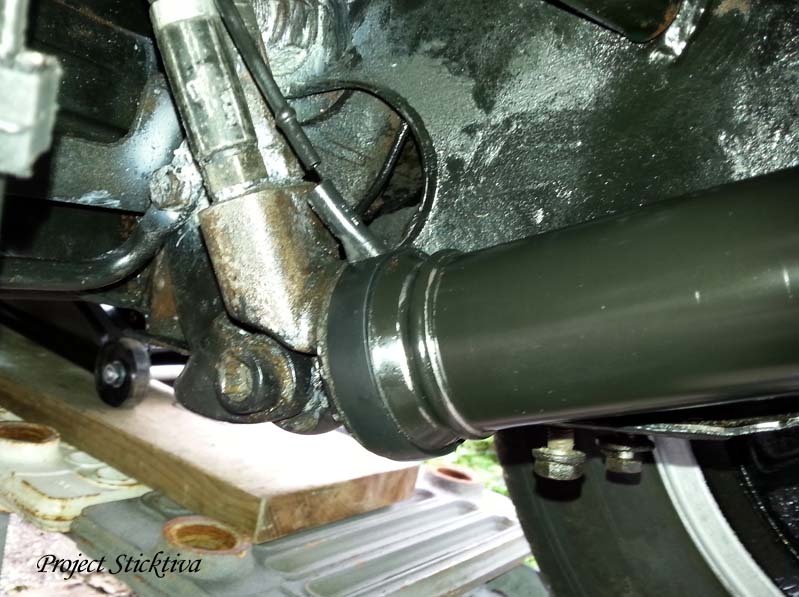

working on your own holding a £600 part connected by old hoses.....pita !
